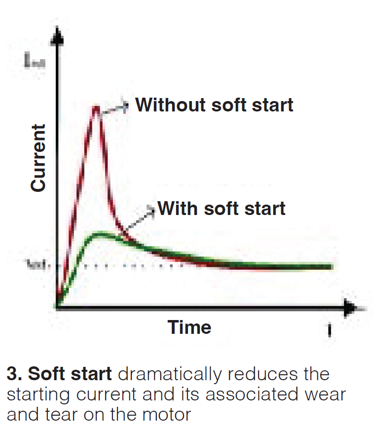

Challenge. As supplied, the four fans providing cooling air for Nebras Power’s closed cooling water (CCW) system each were powered by a 45-kW belt-driven motor. This design presented several issues when starting the fans—including these:
- High mechanical stress on both motor and fan components.
- High starting torque.
- High starting current.
Challenge was to identify a solution to reduce the noted impacts of the present starting system.

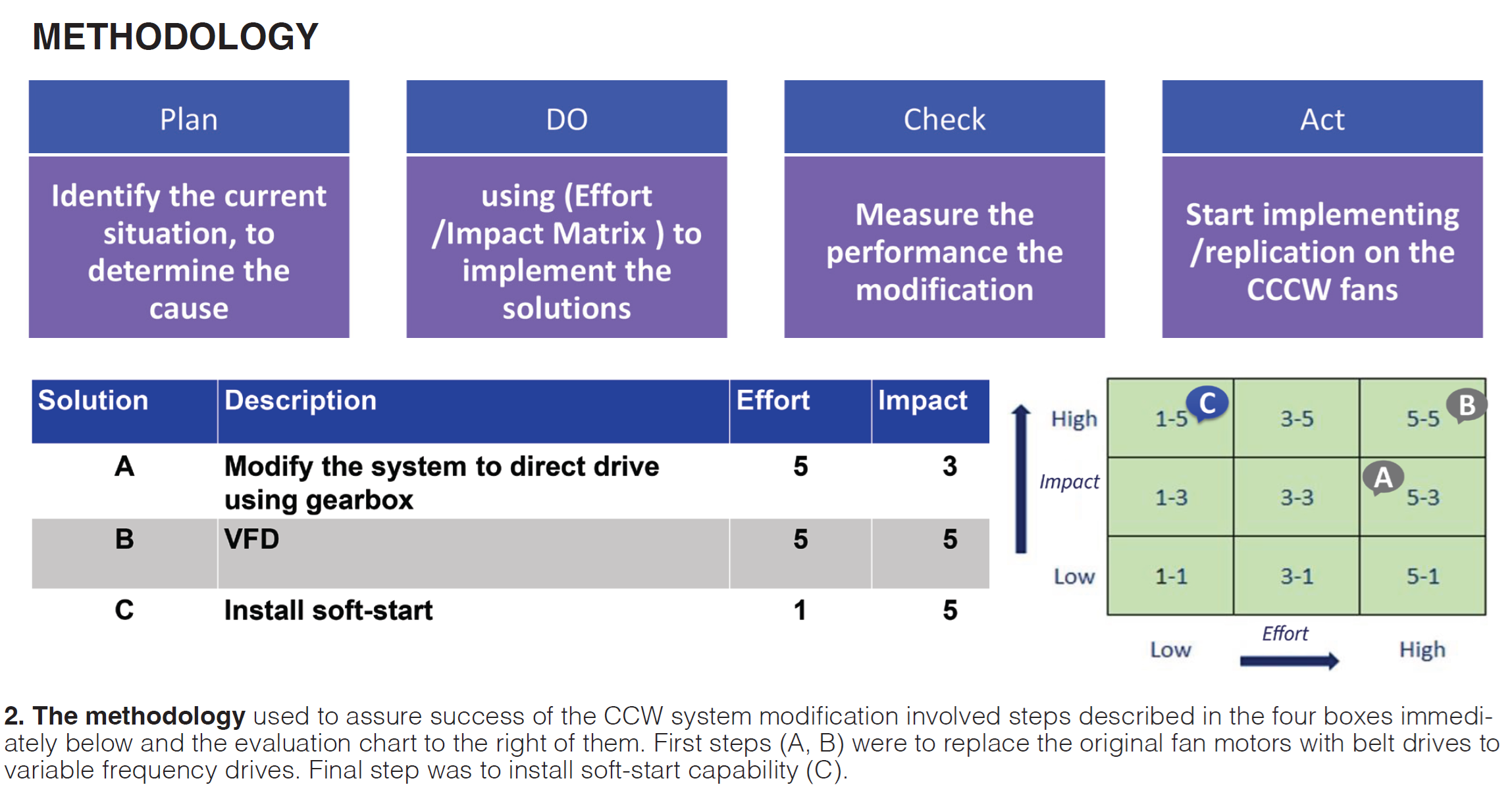

Solution. Key steps in developing the solution for improving drive-system performance and reducing O&M cost were the following:
- Technical and financial evaluation.
- Communicate with suppliers and get a quotation for the equipment and work involved.
- Issue a management of change notice.
- Execute the plan.
- Check and monitor the modification.
Methodology and tools used to arrive at the solution are described in Fig 2. Fig 3 illustrates the advantage of installing soft-start.

- Reduced the inrush current.
