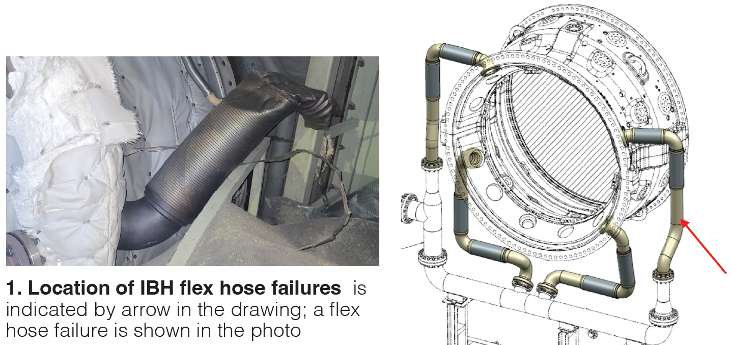

Background. CPV Towantic is an outdoor facility with two 7HA.01 gas turbines and one D602 steam turbine. The OEM released TIL-2299 in response to the 7HA inlet bleed heat (IBH) flexible-metal-hose failures experienced by some users while operating baseload (Fig 1). Hot compressor discharge air leakage from the failed flex hoses pressurized the gas-turbine enclosure and caused compartment doors to open.
To remedy this, GE released TIL-2299-R1 to communicate the availability of an improved “dog-legged” style flex hose to address torsional stress caused by the original hose configuration. Another IBH flex hose event was reported with the improved dog-leg design and the root cause analysis of determining the factors associated with that failure were still under way when this best practice was submitted to CCJ.

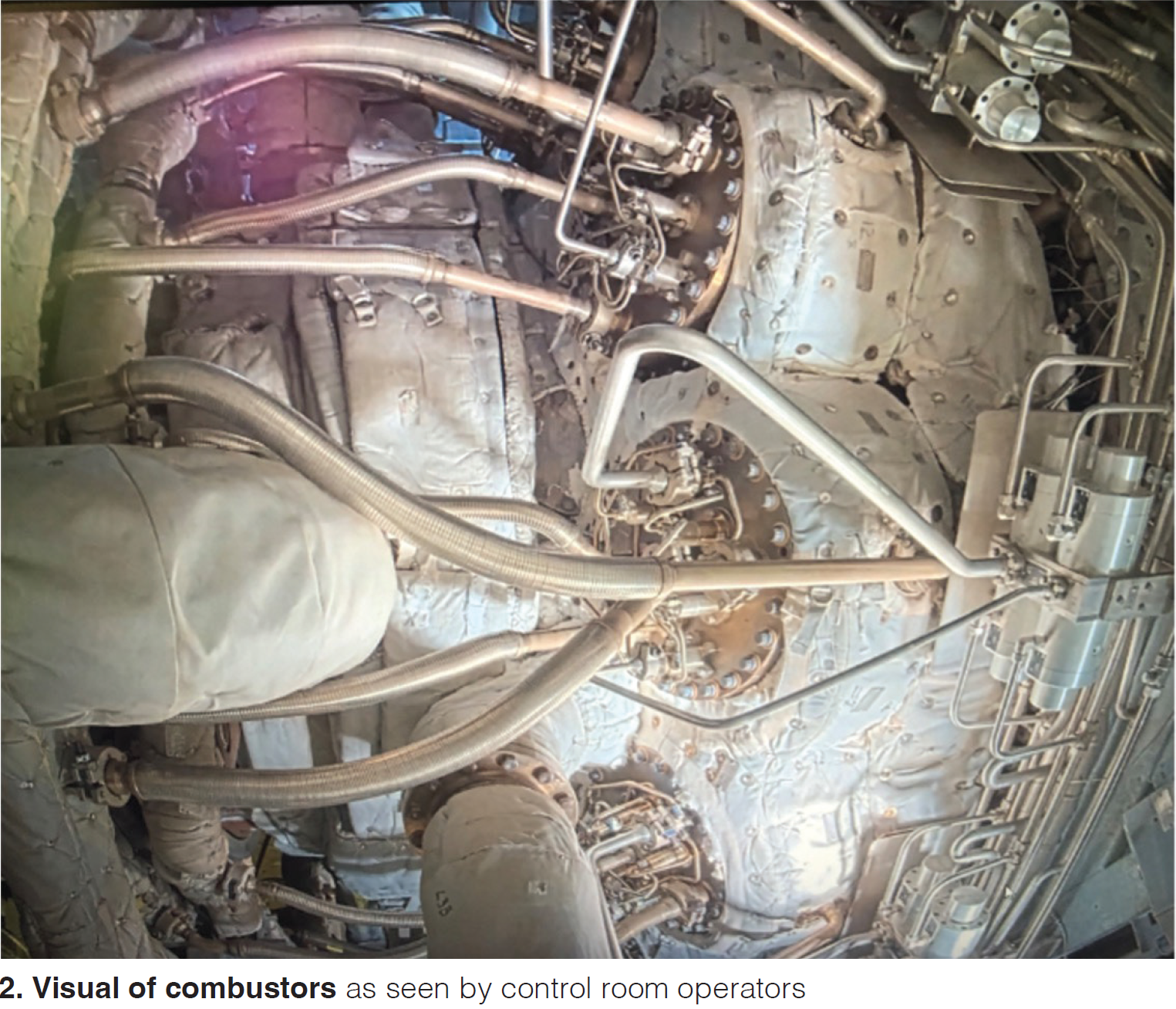

Solution. Cameras to provide visual access to the combustors was the solution favored by plant personnel. Coincidentally, Towantic already had under contract a new security partner to install site-wide cameras, badge readers, and remote visuals. However, an obstacle to this solution was a very short turnaround time of about 3.5 weeks to procure and install the equipment—without the ability to provide a good walk-down of the enclosures.
Equipment had to be run in rigid conduit and hermetically sealed according to plant specifications. The security vendor was able to procure eight Axis P1468-XLE explosion-protected bullet cameras with zoom capability that allowed 4K vision under any light conditions.
The security vendor and the site’s electrical contractor partnered to complete installation of conduit and cameras inside the GT compartments within the short outage window provided. Four cameras were installed in each GT compartment—one in each quadrant allowing visual access to the combustors (Fig 2). Shortly afterwards all the exterior equipment was run, and data links provided, to send visuals to the control room and staff computers.
Results. Towantic has eliminated the hazards and risks to personnel while operating on liquid fuel. GT enclosure cameras allow operators to use the CTs to their full potential and participate in the dual-fuel market.

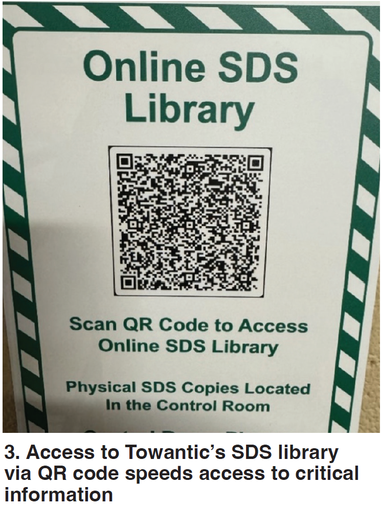

When staff realized they now had three binders of SDSs to keep updated in two different locations, personnel wondered if there was a way to make the eBinder accessible to all to make the process of using the SDS libraries faster and easier to maintain.
Using a QR code that linked to the site-specific eBinder was an effective way to access all the SDSs for the site and made searching for an SDS easier than using the hard-copy binders (Fig 3). The control room still has a physical copy that is sorted alphabetically, but when you’re searching for a chemical, you might not know the vendor’s name for it and finding it can take considerable time away from the work necessary. Using the QR code and doing a search in the library takes seconds and you can access any of the SDSs on file quickly and from anywhere onsite.
Having one QR code, staff made signs to post at multiple locations around the site, in particular where you may encounter a chemical or substance you may need an SDS for.
Results. The SDS library of all chemicals onsite is available for any employee or contractor at any time, thereby reducing the time needed to access the information required. Whether the need for the SDS is for disposal considerations, to respond to an emergency, or for general information purposes, it’s now much easier to get the information needed.
Not having two separate locations saves staff time in organizing and updating the libraries. While the plant still has one physical copy, maintaining it takes half the time as it did before.
