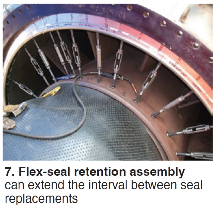

A good example of a solution is the patented flex-seal retention assembly (Fig 7) which has been installed in 60 units and is supported by 29,000 operating hours. IPS says it has reduced seal-failure risk, stopped cooling-air leakage, and is easier to install and maintain than alternatives.

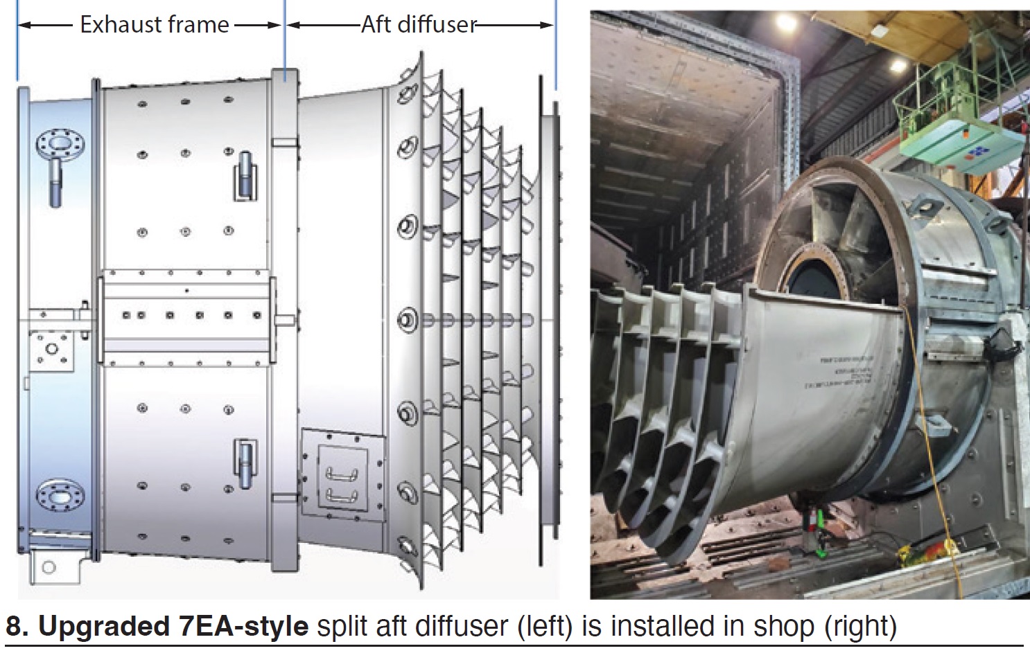

One of the case studies features an upgraded, split aft diffuser (Fig 8), which addresses inner-barrel circumferential cracking, aft flex-seal ring separation, turning-vane cracking, and load-tunnel and back-wall insulation failures.
