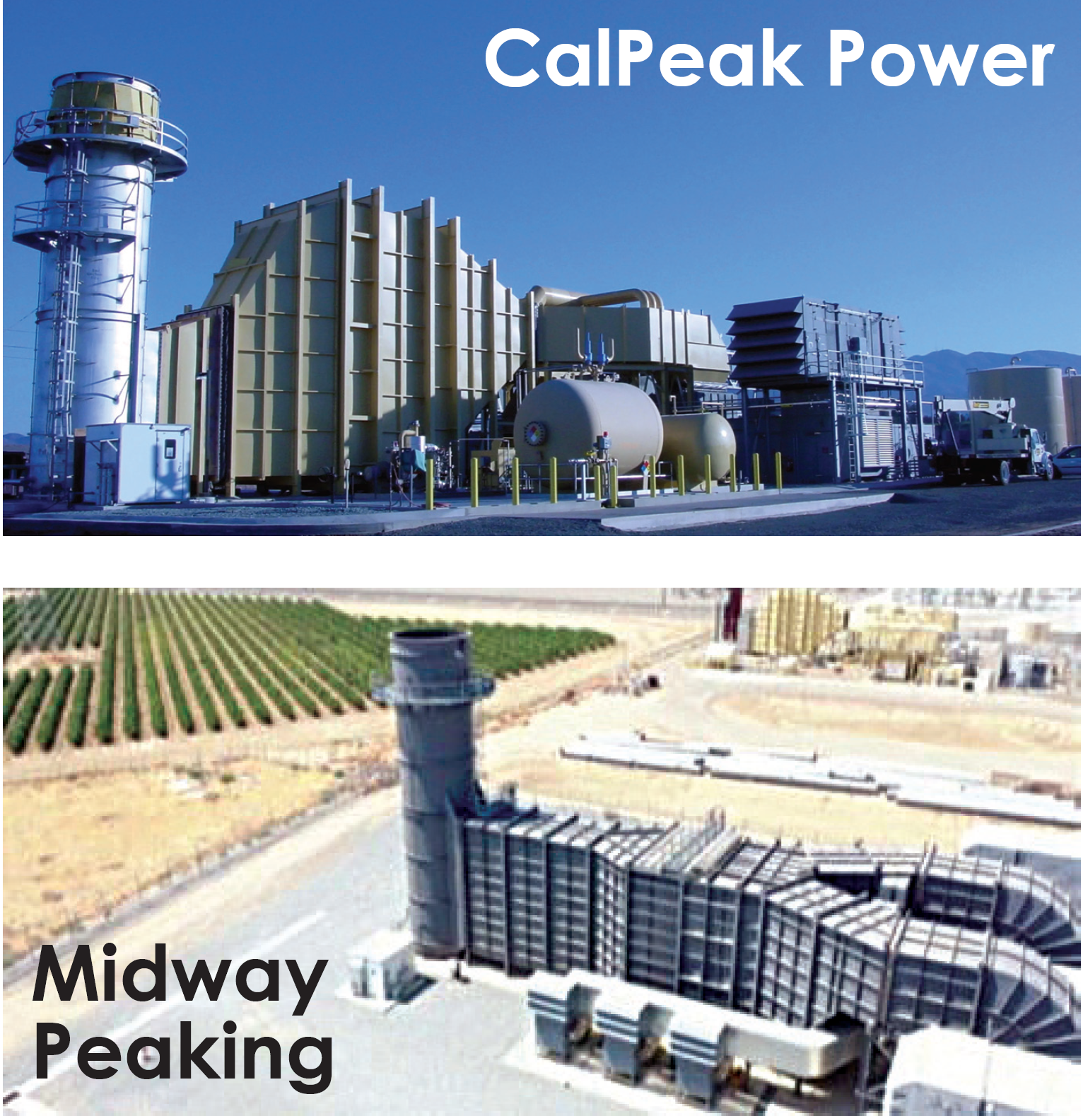

CalPeak Power LLC
Owned by Middle River Power
242 MW, four simple-cycle peaking plants (Border, Enterprise, Panoche, and Vaca Dixon), each consisting of one FT8-2 TwinPac generating unit operating on natural gas, located in San Diego, Calif
Plant manager: Ramiro GonzalezMidway Peaking LLC
120 MW, simple-cycle peaking plant consisting of two FT8-3 SwiftPac generating units operating on natural gas, located in Firebaugh, Calif
Challenge. The CalPeak Power and Midway plants are remotely operated, manned during normal working hours, and unmanned on nights and weekends. The six generating units are dispersed throughout California, with a spread of 544 miles. Some units are located in very rural areas.

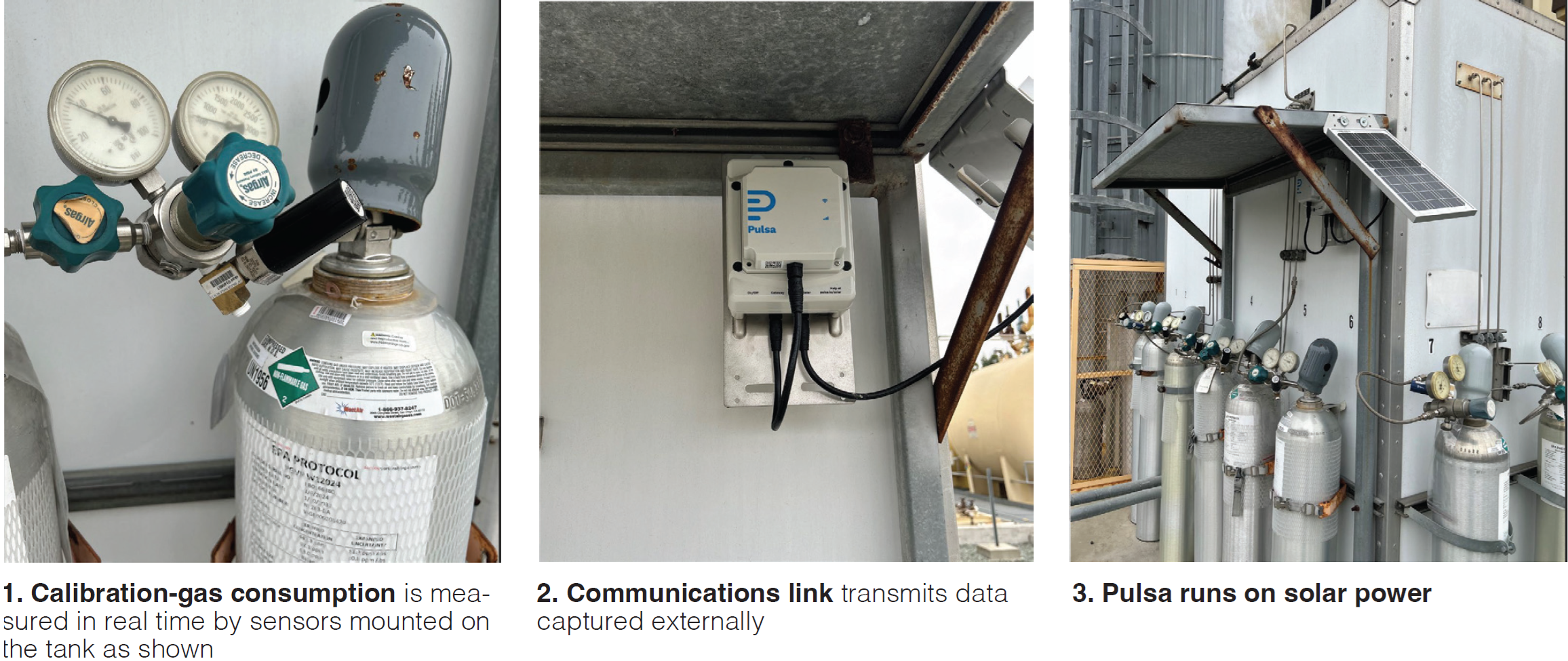

Solution. Middle River Power (MRP) engaged WestAir Gases and Equipment, Fontana, Calif, to install a Pulsa real-time gas and tank level monitoring system. It uses sensors that are attached to the high side of the gas regulator (Fig 1) and a cellular service to communicate externally and transmit data (Fig 2). Internally it connects via Bluetooth® or WiFi to each individual pressure sensor to collect data at intervals of every few minutes.
The system also offers a cellphone app through which users can scan the sensor QR code and access status information. Plus, the application monitors connectivity health and sends notifications if a sensor is not reading data or becomes disconnected.
Pulsa is powered by solar energy (Fig 3) and features a battery life of 40 days (when fully charged) before depletion. Alternative power-supply configurations can be implemented as needed.
