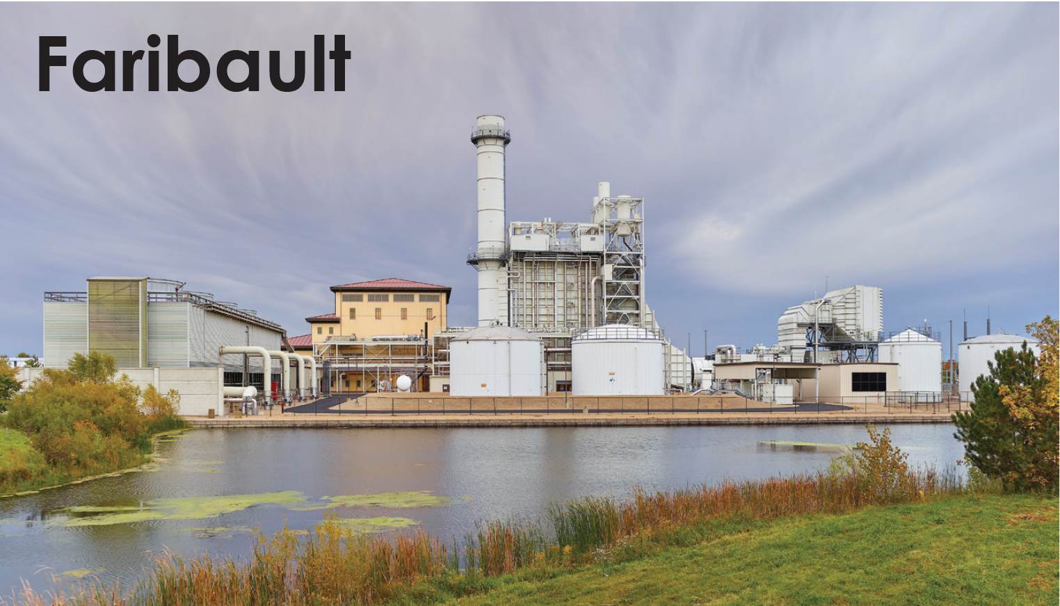

Faribault Energy Park
Owned by Minnesota Municipal Power Agency (MMPA)
265 MW, 1 × 1 7F.03-powered combined cycle equipped with a GE A10 steam turbine and CMI HRSGs, located in Faribault, Minn
Plant manager: Shawn Flake

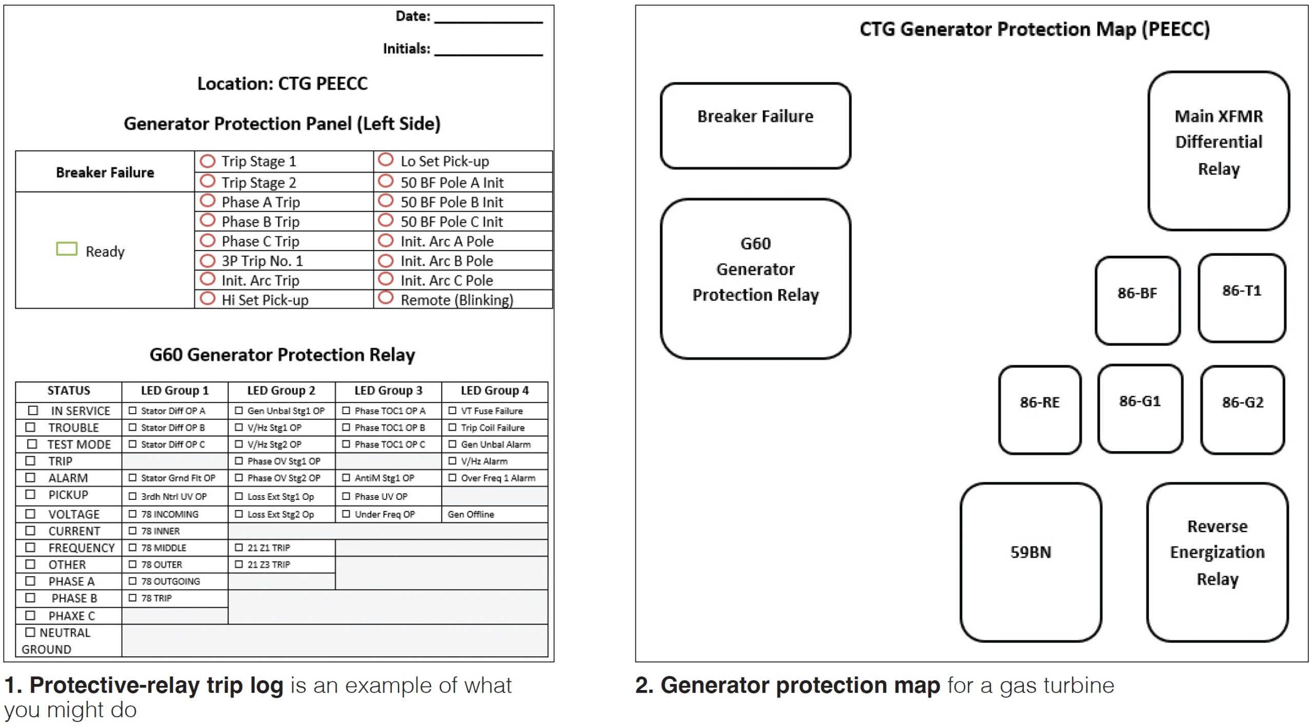

Solution. Faribault Energy Park implemented protective-relay trip logs to identify the state of all relay outputs and flags accurately and quickly (Figs 1 and 2).
Physical copies of the trip logs hang on clipboards at each relay station in the plant. The logs are configured identical to the physical location, lights, and flags on the protective relays. This allows O&M techs to quickly transpose all information from the relay station to a paper document that can be used to troubleshoot electrical faults.
Results. Quick and accurate relay trip information has minimized impacts to plant equipment during electrical-fault events. During each fault event, O&M techs were able to accurately provide fault information to management. The data sets allowed managers to make quick, sound, and effective decisions—including switching orders and initiation of electrical restoration procedures.
