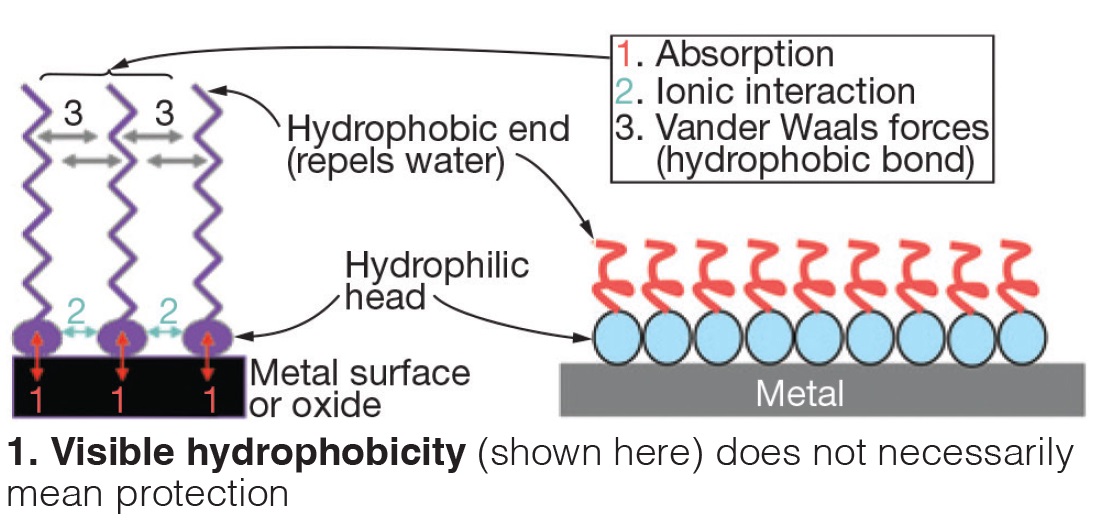

Two significant hydrophobicity aspects were stated by Dooley in his conference review:
  1. “As at previous FFS conferences, there were general visual observations of hydrophobic films in the water-touched areas (mainly feedwater and condensate) of plants” (Fig 1).
  2. More importantly, “A survey of conference participants indicated that the presence of hydrophobic films does not uniquely relate to the reduction of corrosion and the transport of corrosion products but appears to be an artifact of application. Also, surface tension of an FFA (OLDA) is reduced at low levels and related to the contact angle of wettability in this range,” Dooley explains.
And moving beyond the visual, he continues: “A deeper understanding among the attendees was apparent around what are the metrics for success for an FFS program in plants and moving beyond just using the presence of hydrophobicity as a single assessment point.”

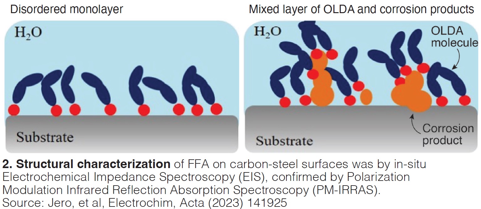

This method was presented on the first day by Deni Jero et al. (Université de Toulouse, France), entitled Electrochemical impedance spectroscopy for continuous in-situ analysis of FFA on carbon-steel surfaces.
Jero looked at water/steam circuits of industrial facilities (carbon steel), localized corrosion, and consequences (materials degradation and damage risk). This led to protection strategies— including the use of film-forming amines.
The challenge, she says, is “continuous in-situ analysis of FFA, of nanometric thicknesses, on rough and corrodible surfaces” for the characterization of thin organic layers.
The proper process must be specified for:
  • In-situ (in immersion and continuous).
  • Sensitivity to layer thicknesses.
  • Working in a surface roughness environment.
  • Ability to differentiate between adsorption and corrosion.
  • Designed for structural characterization, in this case also using OM-IRRAS (Polarization Modulation Infrared Reflection Absorption Spectroscopy).
The analysis technique discussed: Electrochemical Impedance Spectroscopy (EIS).
The study focused on the following:
  1. OLDA (Oleyl Propylenediamine) adsorption kinetics and structural properties.
  2. Influence of temperature variation on the OLDA layer.
General conclusions showed the mixed layers of OLDA and corrosion products, simplified in Fig 2.
The conclusion of this study: For optimization of FFA quantity and injection frequency, EIS is a useful tool to monitor FFA on carbon-steel surfaces.

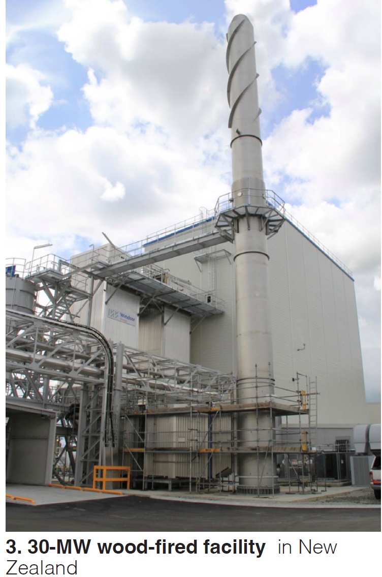

Dylan Harrison, Visentia Ltd, New Zealand, discussed Pre-commissioning cleaning of new industrial boilers with the use of ODA (Octadecylamine).
His case study was a 30-MW biomass boiler (Fig 3).

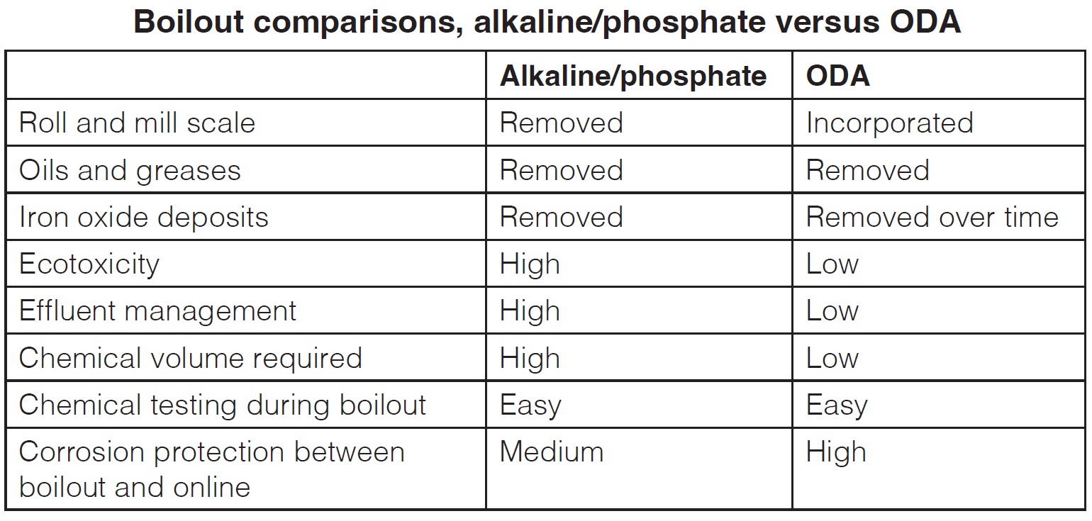

Traditional pre-commissioning boilouts (various chemistries) are intended to remove mill scale, iron oxides, slag, abrasing dusts, greases and oils, and manufacturing debris—such as nuts/bolts/washers/tools. This also helps minimize corrosion during refractory drying.
Harrison offered a comparison of results, alkaline/phosphate versus ODA treatment boilout, shown in the table. His discussion included lessons learned, along with cautions and solutions.

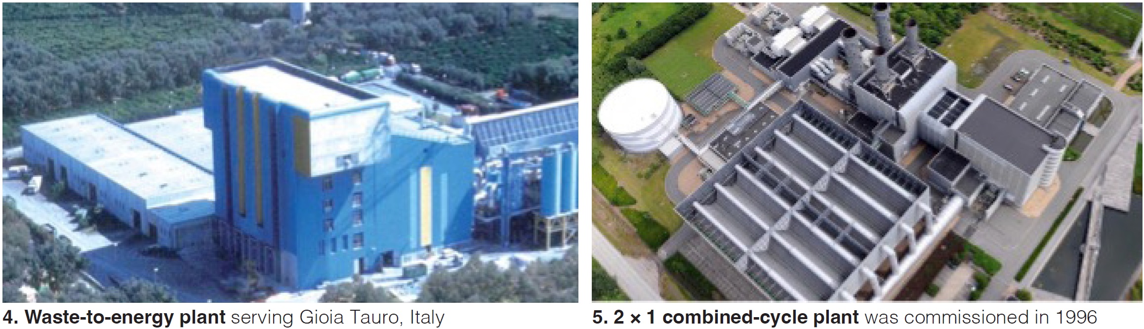

F Carruba, Kurita Europe (Italy) and V Di Massa, Ecologia Oggi (Italy) presented Transition of two waste-incineration boilers in Italy from traditional treatment to Cetamine®. The 16-MW municipal solid waste plant (Fig 4) was commissioned in 2005, with two boiler systems.
Boilout is intended to remove macroscopic residues from the system (deaerator, drums). Overall, changing the procedure with Cetamine reduced chemical consumption by 97%, water consumption by 55%, and boilout time by 54%.
Presenters explained that in September 2022, the plant switched from standard boilout procedure to boiling out with Cetamine. At the end of 2022 the plant switched to Cetamine for both passivation and continuous treatment and “total iron levels in the system were significantly reduced.”
Cetamine was shown as suitable technology during the process of alkaline boilout, passivation, and continuous treatment. All steps can be covered with one product, and the change allowed significant reductions in chemicals, water, and time.

Anthony Senecat, Engie Laborelec, began the FFS 2024 sessions with Two cases of FFA use in Engie powerplants: a 2 × 1 combined cycle commissioned in 1998, now in flexible operation (daily start and stop), and a nearly-retired coal-fired station commissioned in 1979.
In the first (Fig 5), iron values were compared from 2008 to 2018, before and after FFA dosing. A consistent evaluation between feedwater and condensate showed a positive impact of FFA on iron transport.

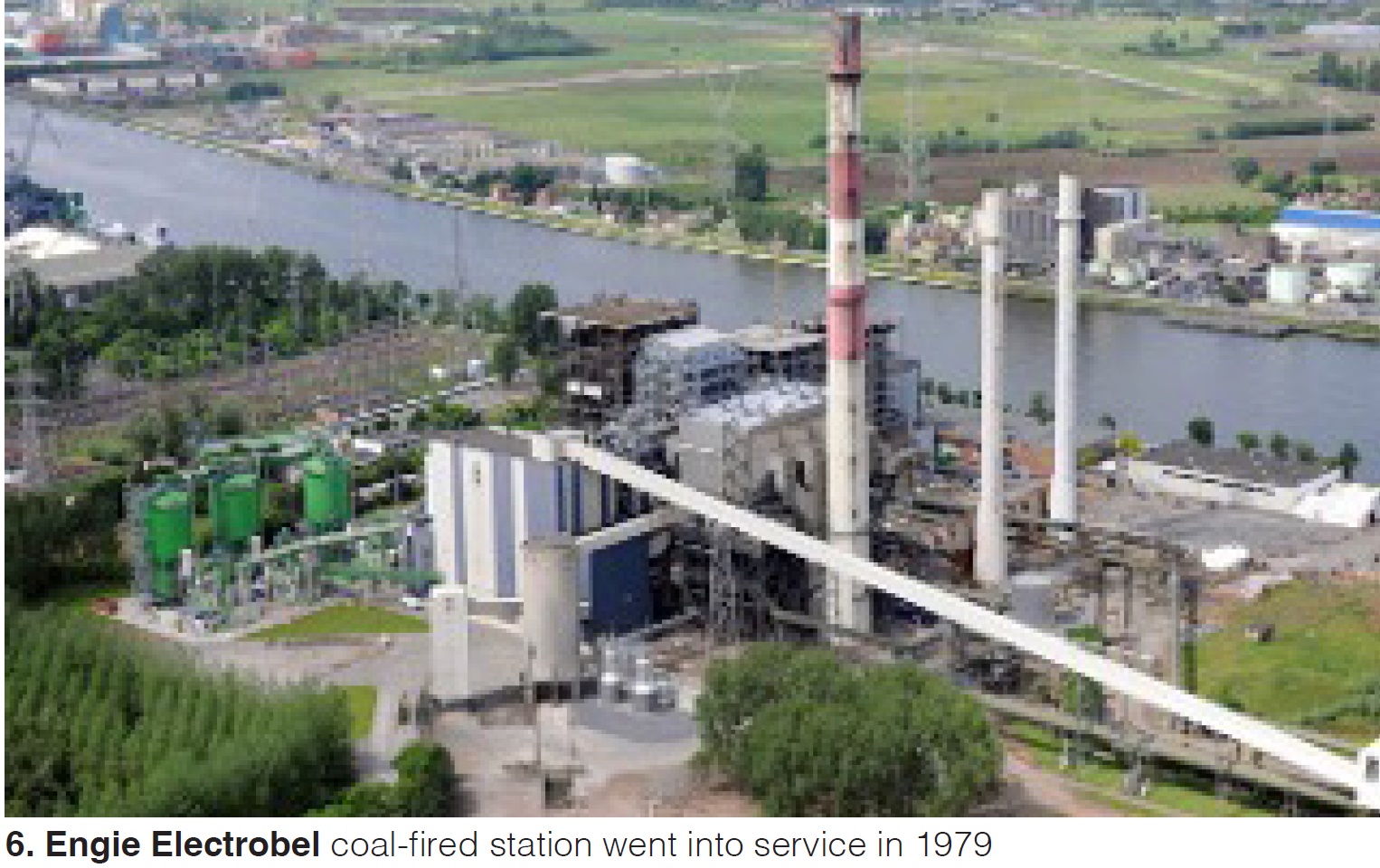

The second plant (Fig 6), originally baseload, is now limited to support for a neighboring blast-furnace-gas boiler. Dosing is used to minimize preservation costs for the water/steam cycle when off line.
In this case, dosing implementation has been difficult with large deviations in CACE (conductivity after cation exchange) readings. In summary, “FFA implementation is not a straightforward process.” There is to date no explanation of the high degassed CACE values. However, dosing FFA prior to the end of continuous operation appears beneficial to the water/steam cycle.
