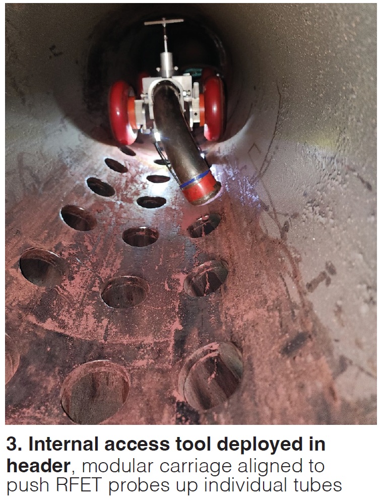

Shawn Gowatski, TesTex (US), presented an HRSG inspection update focused on faster coverage and better access to problem areas using electromagnetic techniques and purpose-built tooling. Highlights for cycling fleets and short outages:
- Finned tubes. External scans through fins to find pitting and wall thinning on evaporator and economizer tubes (Fig 3). Typical productivity about 1,250 linear feet per shift, with defect sizing by calibration standards.
- Tube-to-header welds. CLAW locates cracking around the full 360 degrees of the weld. Current heads cover common HRSG tube sizes and can examine up to about 150 welds in a shift. Modified “mini” heads and extension links improve reach in tight header nests.
- Internal Access Tool. Access via endcap removal or an 8-in header hole to push probes up individual tubes (Fig 3). Waveforms and video document localized FAC and pitting at multiple elevations. A crew can clear a header in 3 to 4 shifts when access is favorable.
- Case pattern. Internal inspections frequently show highest FAC near upper headers, with ranges from 20 to 65 percent wall loss on selected tubes. Video often correlates wall loss with deposit accumulations. Findings guide selective retube plans when full drum internals removal is not possible in a short outage.
- Development items. Ongoing work with EPRI includes methods to measure internal deposit thickness in HP evaporator tubes, downsized crawlers to detect tube-to-header weld cracking from inside small headers, and phased-array follow-up for the CLAW.

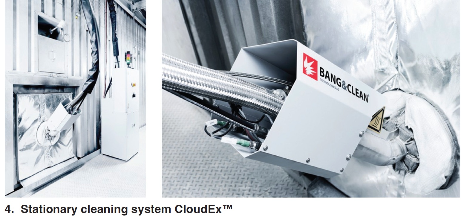

Markus Bürgin, Bang & Clean Technologies AG, focused on Swiss innovation and technology for gas-path cleaning, beginning with PressureWave+ mobile cleaning in 2001. He covered developments and experience in Italy, the Benelux region, and France.
A recent innovative development, he noted, is CloudEx, a stationary installation designed for keeping a boiler clean. (Fig 4).
Special application of HRSG deep cleaning was also highlighted by Bürgin for two projects in Italy. One installation was a syngas-fueled 166 MW gas turbine, horizontal flow HRSG and 115 MW steam turbine. The project purpose was reduced backpressure and increased plant efficiency. The other was a 262 MW gas turbine, horizontal flow HRSG and 122 MW steam turbine, with similar goals and positive results.

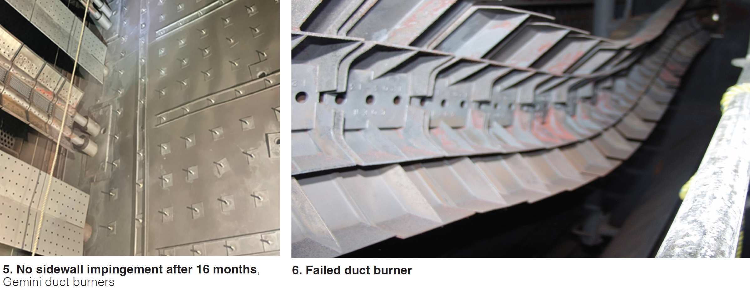

Scott Baumann, Thermic Systems, introduced the new Gemini tandem duct burner design featuring compact flames (50 percent shorter) to eliminate flame impingement on tubes and liners. These burners showed a 2.4 m flame length as opposed to the original 5.5 m length. Gemini burners and baffles had been installed on a unit and after 16 months run time there were no signs of side wall impingement (Fig 5).
Baumann discussed other innovations including an HRSG intelligent recirculation system to reduce dew point, innovations for rethinking dilution air thermal energy, optimizing ammonia vaporization, and examples of an induced-flow heat exchanger.

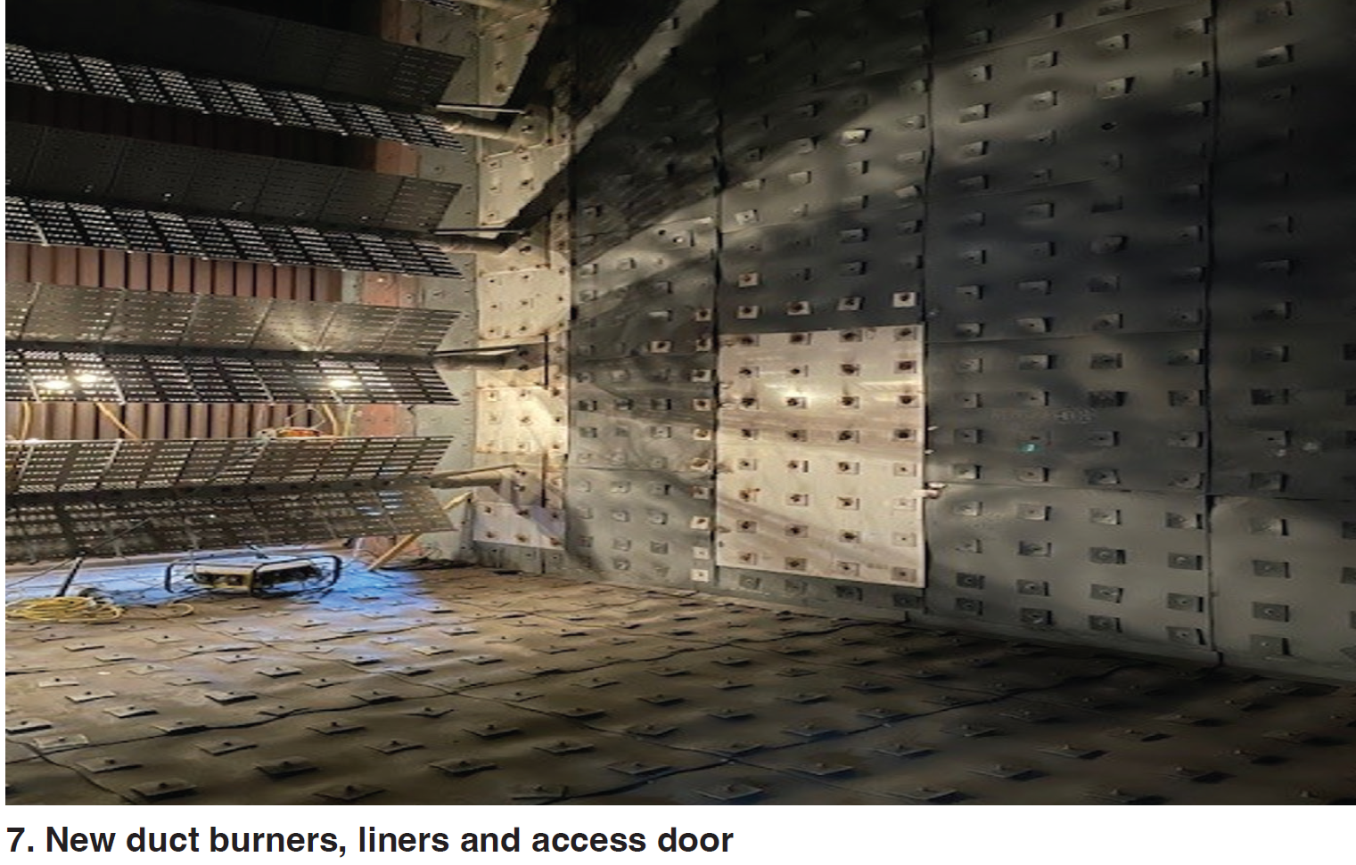

Bill Kitterman, SVI Bremco, offered two distinct projects for HRSG duct burner replacement.
One case was a Frame 5 modification from vertically fired to horizontally fired, including gas piping and controls.
He first showed the existing vertical system and existing piping system. Explaining access points, Kitterman then showed the horizontal arrangement during construction.
Next was a 7FA HRSG retrofit involving runner replacement (Fig 6) as well as small piping (ignitor, etc.). The unit had also suffered severe liner damage.
Scope included removing existing burner runners and header and modifying support sleeves.
New burners were then installed, piping was replaced, and new liners were secured (Fig 7).
The project was completed in 14 days (28 shifts).

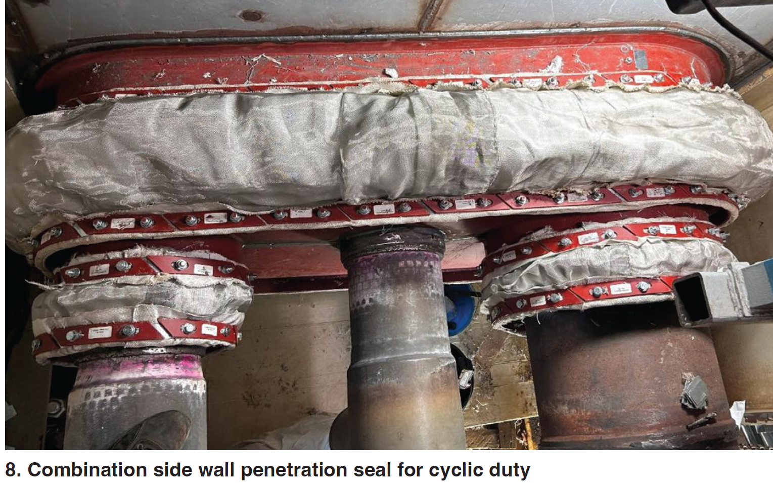

Jake Waterhouse, Dekomte (UK), focused on how penetration seals and GT exhaust joints can be specified and installed for high-cycling service common at CCGT plants. The target is gas tightness, stable metal temperatures, and predictable life under frequent starts and load swings.
- Cycling classes were shown from baseload to very high cycling, with design validation using transient temperature data and analysis. Field experience indicates low fatigue usage when frames are kept at even temperature and internal flow shields calm the hot gas stream.
- Typical leaf flex seals struggle in cycling duty. Foil layers can crease, crack, and leak, and the many small parts complicate maintenance near sensitive equipment.
- Replacement concept: formed multi-layer fabric with PTFE membranes, insulated frames, and internal flow shields. The package is aimed at reducing leakage, lowering casing temperature, and shortening outage time.
- For HRSG side wall penetrations, split steel collars and fabric bolsters allow replacement without post-weld heat treatment. This supports fast installs during short cycling outages and simpler future maintenance (Fig 8).
In practice, cyclic service drives larger relative movements and thermal gradients at side wall nozzles. A combination approach was highlighted: renew casing insulation, cap and shield the liner around the nozzle, and use a staggered fabric penetration seal to limit gas circulation inside the seal cavity. Early surveys at a reference site showed low fabric and casing temperatures after one year of cycling.
- Operator notes for cycling fleets:
- Trigger a retrofit plan when there are persistent gas leaks, paint discoloration or hot spots at penetrations, frequent repacking, or degraded insulation.
- During the outage, specify internal flow shields, confirm insulation details around the nozzle, and use bolted collars where feasible.
- After return to service, trend start counts and verify low frame and casing temperatures, then plan a mid-life inspection of fabric layers and pillows at about five years for high-cycling units.
