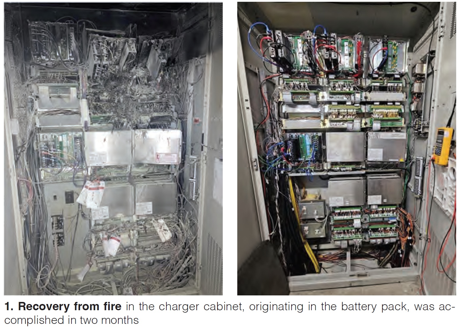

Fire in the cabinet!
Moral of this story is to assess old control system battery pack chargers, especially if you are migrating from Mark V to Mark VIe and you’ve retained the old chargers and I/O. Or just take some time to assess them period, including your fire suppression system.
A user with five dual fuel, standard combustion, 7EA machines commissioned in 1994 experienced a fire (dubbed an “unplanned combustion incident”) in the battery pack and charger cabinet (Fig 1) in February last year while the unit was in outage for a major inspection (MI). The plant had upgraded to the MKVIe MMV in 2016, but left the original battery charger in place. Batteries had been replaced in 2010. Photos reveal the extent of the smoke during the fire, and substantial damage to the cabinet.
Subsequent RCA revealed a flood of diagnostics and alarms from the subsystem, beginning in November the previous year, which would clear in milliseconds while the unit was off-line. This happened for “days and days when the unit was off-line.” It had “probably been years” since the unit was operated at its high voltage shutdown (HVSD) threshold of 150 VDC.
Lead theory of cause was that the charger was not charging the batteries and the DC voltage was cycling between low and high, which could lead to high heat conditions. An alternate theory, however, that could not be ruled out was that AC had gotten into the DC circuits via the failing battery charger or external source in the field.
Other RCA findings were that a planned maintenance (PM) strategy didn’t exist for the MKVIe MMV hardware and I/O, the only DC power to the MKVIe MMV was the batteries (no DC-to-AC converter, or DACA, also known as the transformer assembly, existed, which was “uncommon” according to the OEM and AP4 Group, who was assisting the plant)), and the wrong kind of fire extinguishers were stationed (not Class C CO2) in the area for this type of fire.
After evaluating options, the plant’s post-incident actions included correcting the gaps in PM and fire suppression, replacing original battery chargers, adding high/low DC voltage and other alarms, and establish voltage monitoring in PI and graphics in the MKVIe MMV.
AP4 agreed to rebuild the cabinet in two months while others, including the OEM, proposed schedules up to eight months. The slide deck includes photos of the cabinet rebuild and rewiring (during which the “sins of the past” were fixed), schedule, and ancillary tasks. Aside from a ground fault in the DC system and a damaged exciter card, which was inspected, cleaned, and returned to service, there had been no other incidents of note, nor any failed starts or trips.
An audience member noted that his plant had found oscillating charger voltages months before an “event” and that the chargers were “acting weird.” A second suggested that these components should be on a monthly NERC PM check. Best practice noted in the room: Make sure you have properly refurbished control cards on the shelf.

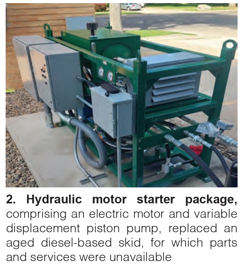

Hydraulic motor starter saves day
A facility with Frame 5 units in far north Plains country (i.e., really cold in winter) lost its aged diesel starting motor at the beginning of 2023. The unit had to be on-line by June 1, it was impossible to get parts for this Cummins machine. Multiple service vendors would not engage with the project because of “difficulty dealing with this particular starter package.” Thus, the owner/operator opted for a replacement skid consisting of a large electric motor plus a variable displacement piston pump (Fig 2).
Focal points for the presentation were (1) the need to “weld in and weld out” to extract the diesel motor from inside the gas turbine housing in two pieces through the roof, without pulling the top off of the turbine, and (2) making sure new equipment in the gearbox room (designed for “someone four-foot tall”) was compatible with the components which were reused, such as the clutch.
Regarding the second, a repurposed carrier bearing was added inside the torque converter to the middle of the shaft. A stub shaft was also added to make a 2-in rotor on the motor side compatible with the 3 in rotor on the clutch side. Both affected the weight and structural design parameters. The new clutch “spins freely in one direction, engages in the other.”
Cold weather design points are particularly salient here. The facility required an insulated housing. Hoses had to be wrapped with heat tape. A separate start sequence had to be programmed into the controls, during which the pump motor is first run in neutral to warm the lube oil while limiting amp draw to maximize torque. When the pump hits full stroke, it is closed to light off the turbine.
The vendors involved with the project, ST Cotter Turbine Services and HPI Energy Services, reported that they rescued the facility “with a luxury yacht instead of a tug.” While they’ve completed hundreds of starters for FT4s, FT8s, and other machines, this was the first frame 5. Cummins is now said to be recommending the duo to customers in similar situations.
Other issues to consider:
  • You need a specialist for the controls.
  • Make sure the concrete pad for the skid can handle potentially higher vibration levels, which may also affect complying with sound level limits.
  • Local codes for black start may require a soft start or variable frequency drive (VFD) set up.
  • Motors up to 400 hp have been used, although this site required a 300-hp unit. Larger motors come with a larger footprint.
  • Make sure you have enough fuel for multiple starts during commissioning.
The project schedule for the new starter was four months from finalizing paperwork to a fully commissioned skid. Actual installation took 7-10 days. At conference time, the unit successfully handled 21 starts. Plant is looking at obtaining additional hardware (larger valves, for one) so that two GTs can be started with the one unit.
Slide deck includes a more detailed description of the machine train and clutch assembly, an excellent series of project photos and a handy list of considerations for those contemplating a similar project.
