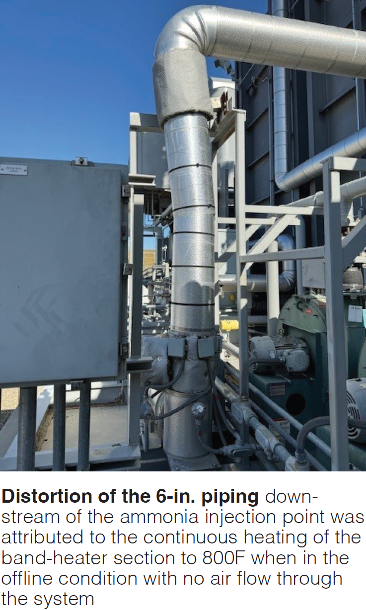

The first improvement to the system: Turn off the 90-kW and band heaters when the unit was offline. While doing this, personnel found that all units showed significant distortion of the 6-in. piping downstream of the ammonia injection point. The distortion was attributed to the continuous heating of the band-heater section to 800F when the unit was offline with no air flow through the piping; plus, insufficient piping support (photo).

Improvement 1. By only running the electric heaters during plant operation, plant auxiliary load was reduced. Warped piping was replaced before its inevitable failure.
