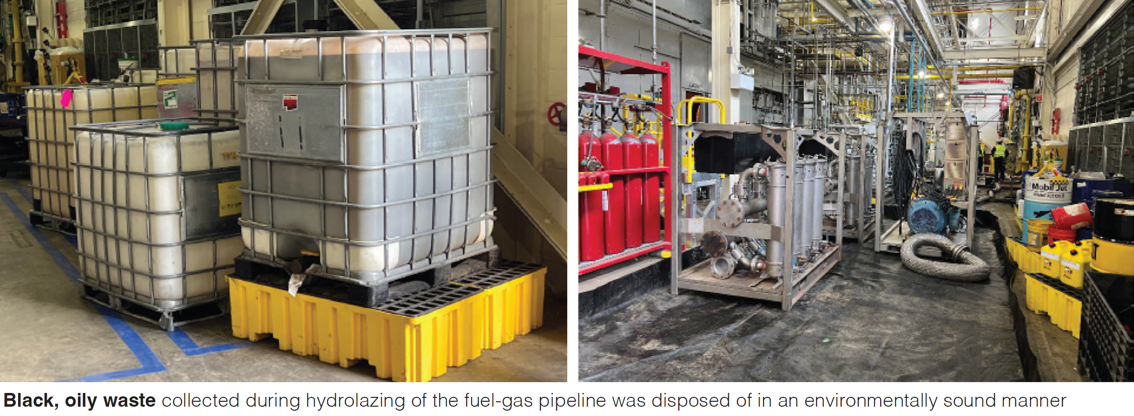

Pipeline cleaning started at the outlet of the plant’s gas compressors. An underground portion of pipe spanning about 400 ft with no low-point drain was cleaned first, followed by flow through the new horizontal filter and then through each gas turbine’s dedicated vertical final filters up to the wye strainers in each turbine package.

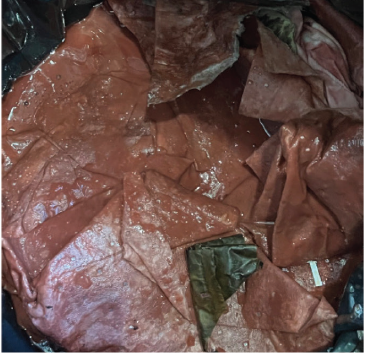

The pipeline was cleaned thusly: The underground portion was hydrolazed and the rest chemically cleaned. The first segment of pipe contained an estimated 300 gallons of dark oil and particulate matter (photos). Red compressor oil found in the remainder of the piping was manually removed from the recirculation tank during the chemical-cleaning process—not a typical task.
