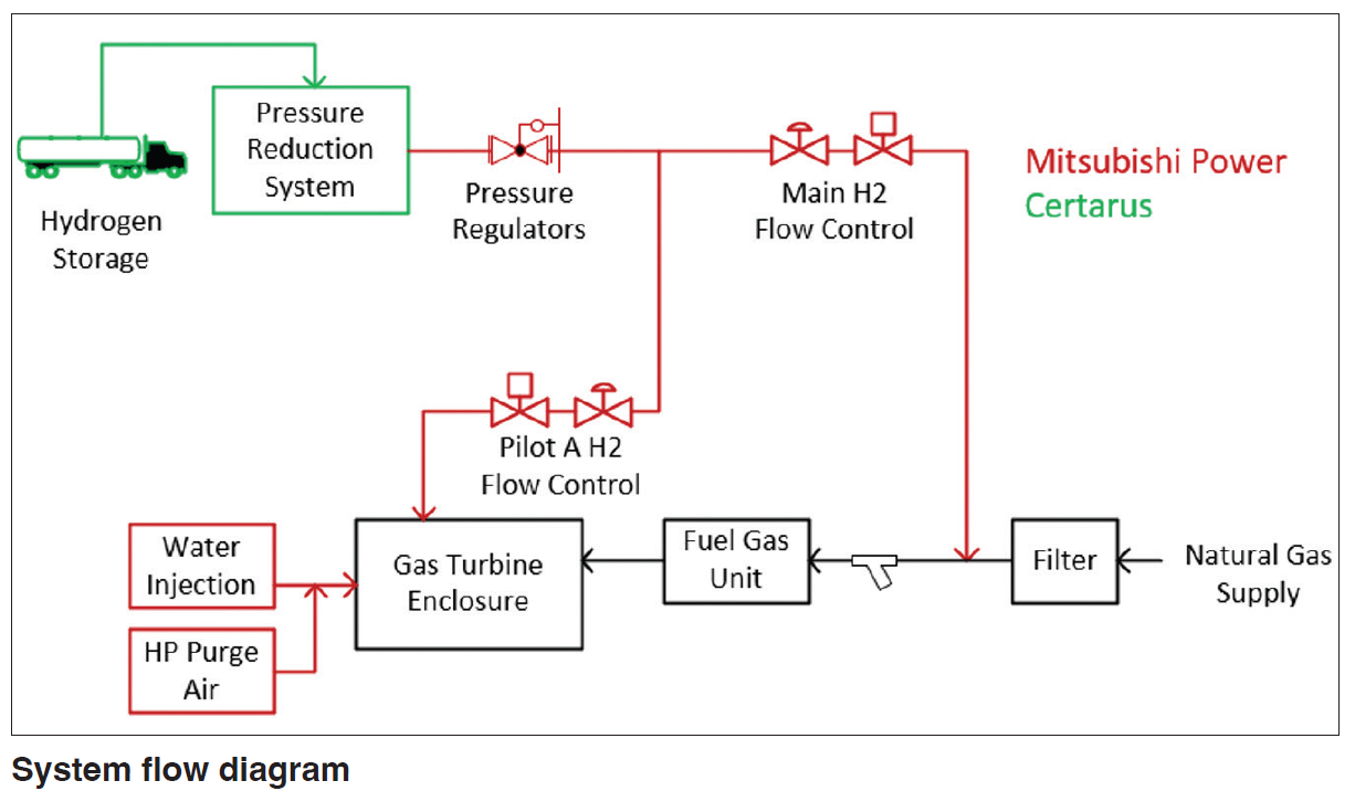

Independent regulation of H2 blend ratios for multiple fuel circuits was accomplished using an advanced fuel gas blending system made up of flow meters, control valves, and pressure relief devices — all automatically controlled via custom-designed logic. The system design addressed key technical challenges including pressure management, equipment protection, and safety systems under high-flow conditions. Compliance with ASME, along with other piping, storage, and safety codes, required careful interpretation to ensure overpressure protection was met while maintaining operational flexibility.

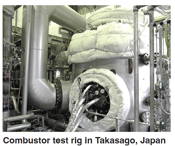

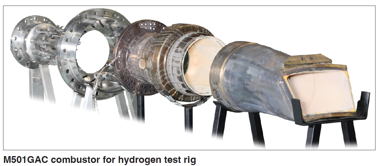

Increasing the pilot ratio and injecting water for NOx emissions control were the primary mechanisms for achieving 50% H2 co-firing. The success of the project was made possible by extensive combustor research and development and rig testing performed in Mitsubishi Power’s headquarters in Takasago, Japan.

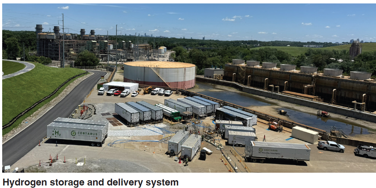

Along with gas turbine conversion, several new auxiliary systems were required for the project including (but not limited to) mobile H2 storage, H2 pressure reduction, H2 flow control stages, H2 blending, high-pressure purge air, water injection, nitrogen purge, control oil, trip oil, instrument air, etc.
The infrastructure additions for the 50% co-firing demonstration were more significant than the previous 20% co-firing project. This was driven by two main factors: 1) H2 injection into multiple fuel stages and 2) the requirement for NOx reduction system(s).

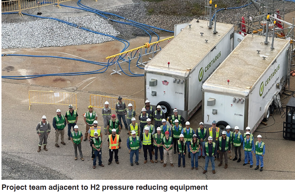

Hydrogen pressure control was challenging due to existing system constraints. A very narrow pressure window (~30 psi) exists between the required pressure for operation and the existing fuel gas piping system design pressure. While this was not an ideal operating scenario, it was manageable.
Overpressure protection is required by various codes (e.g., ASME B31.12 [7], B31.1 [6], API 521 [10], NFPA 2 [11]). It typically is accomplished using a full flow sized relief valve. However, a full flow relief valve was not desired for several reasons, including a very high-pressure safety valve (PSV) reaction force, large discharge piping size, risk of large H2 release (resulting in noise, possible deflagration, etc.), lack of redundancy, and the potential for a PSV release to trip the gas turbine.
During the previous 20% demonstration, implementation of a full flow relief valve was complicated and arduous. To avoid this during the 50% demonstration, an alternative protection method was chosen which relied on three main components: 1) tandem gas regulators, 2) a trip stop valve, and 3) a small safety pressure relief valve (sized for leakage flow only).

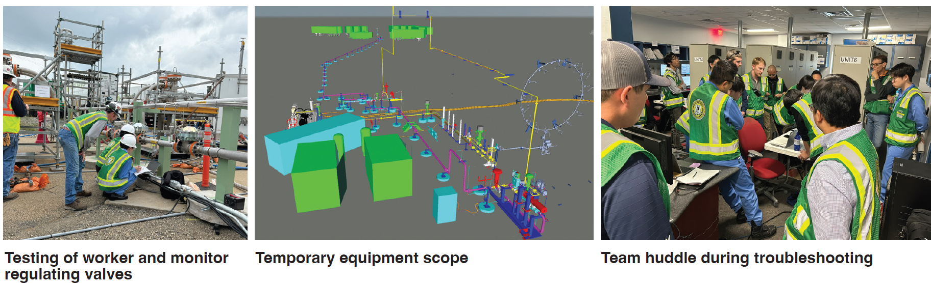

Ultimately, this method was used with worker and wide-open monitor pressure-regulating valves, which allowed for failure of any single control device. The tandem pressure regulator configuration creates a controlled, layered safety strategy that meets ASME B31.12 requirements for H2 systems without requiring full-area venting.
In the arrangement, the primary worker valve fails open and the back-up monitor valve fails closed. During normal operation, the back-up monitor valve pressure is set slightly higher than the primary valve, forcing the monitor valve to fully open. If the worker valve fails, the spring forces it open. As the downstream pressure increases above its set pressure, the monitor valve takes over control. Primary regulator failure is detected via an increase in the downstream control pressure.
Trip stop valve(s) functionality was satisfied by adding a feature to the shutoff valve, which required a special style of solenoid valve with manual reset. Upon reaching the trip pressure, the solenoid valve, (hardwired from a pressure switch) de-energizes and locks out. The trip stop valve then slams shut and can only be opened after manually resetting the solenoid via a local reset button. This feature was intentional and required by code.
A PSV was also required to protect against leakage through the regulator valves. The leakage rating of the regulators (class II [8]) only required a small orifice, limiting the amount of H2 released. A direct-acting pressure relief valve was not feasible due to the poor seat tightness approaching the set pressure (leak-tight up to 90% of set pressure). To avoid constant leakage to atmosphere, a pilot-operated relief valve was used instead (leak-tight up to 98% of set pressure). Both types are allowed under ASME BPCV Section XIII [5].

Creating the new H2 system(s) presented challenges, especially considering the temporary nature of the project. Atypical system requirements included execution duration (installation and removal), lead time, space restrictions, power supply, control system compatibility, etc. These requirements were considered early in the design phase, which facilitated smooth execution.
Numerous factors were considered when designing the layout of the new temporary systems, including emergency egress, new hazardous areas, NFPA 2 equipment setback distances, access for normal plant operation, and all normal service-related equipment and tooling (e.g., cranes, laydown space, etc.)

During testing, it was learned that self-contained pressure regulators should have a local vent line and a small throttle valve to bypass the main supply isolation valve. As the H2 piping pressure was increased to the set pressure, the (fail open) worker valve began to close, but slower than anticipated. During initial testing using nitrogen and CNG, the worker and monitor regulators did not respond fast enough and caused the downstream pressure to spike past the setting, opening the PSV. Consequently, the test procedure was modified for a very slow fill rate.
In addition, the narrow operating pressure window was exacerbated by the weather. When the H2 pipeline was on standby (i.e., pressurized, no flow), solar load on the piping caused the gas to expand and pressure to rise. Even with the worker and monitor regulator valves closed, the combination of leakage flow and solar loading caused the downstream pressure to slowly creep towards the trip pressure setting. While the trip stop valve and PSV were in place to protect the system from overpressure, it was preferred to keep the system active by manually venting the gas. Piping insulation may have prevented this but was not considered due to other factors.

Refueling the 11 H2 mobile storage units was a challenge as well. Refueling of the tractor trailers occurred four times, each requiring four days of logistics. Between tests, the gas turbine operated in normal dispatch. For additional safety, the H2 system was completely vented and purged with inert gas after each test. The time between tests was used to carefully evaluate the previous test data and make any adjustments to control parameters.
