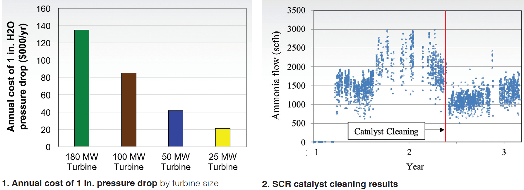

They continued with typical current capital and operating costs of SCR and CO catalysts with F-class turbine examples. This section ended with a look at how the overall system works, and primary considerations for design and operation.
Questions and discussions included impact of fuels, use of dual catalysts (SCR and CO), and optimization vs cost insights.
Session two focused on catalyst system evaluation, beginning with a chemistry review and a look at preferred SCR and CO catalyst temperatures. Typical dual-function configurations (and performance) were discussed.
An interesting analogy: dual-function catalysts are similar to all-season automobile tires, which have limited functionality at the extremes.
Visual inspections followed, noting the most common catalyst types, beginning with CO catalyst plugging, pressure damage and frame migration. Next was the ammonia injection grid (AIG) showing grid, nozzle and lance plugging, and flow-control unit and riser deposits. Common SCR catalyst types were next with discussions on plugging, brick shifting, seals and bypass. Esposito then held a session on system maintenance and cleaning for CO, AIG and SCR (Fig 2).
Attendee questions included the impacts of cycling, catalyst cleaning schedules, outage durations, and the impacts of cleaning on downstream HRSG components and total backpressure.

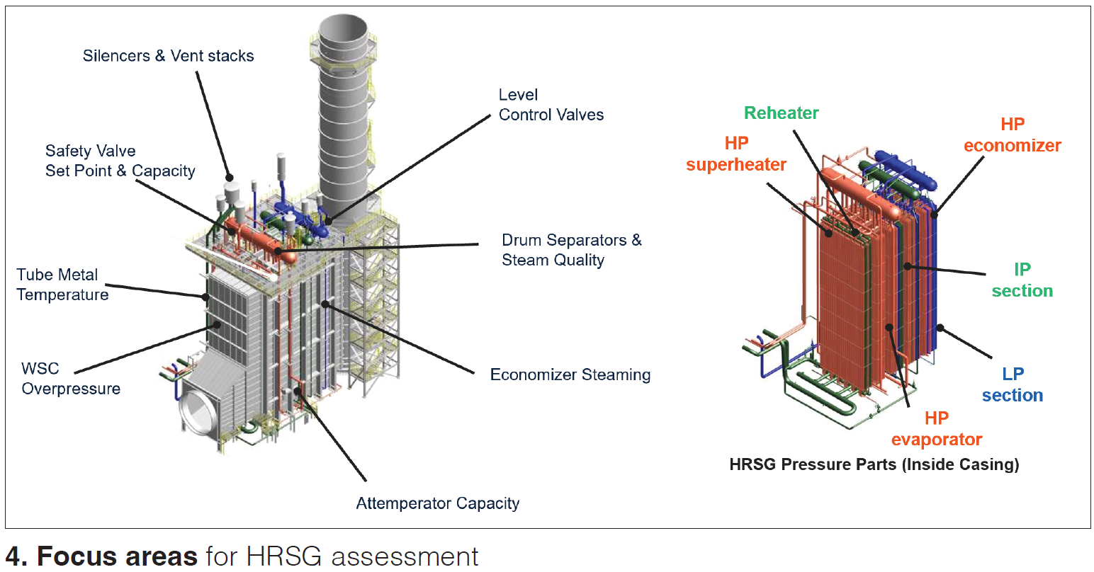

Marc Babine and Katie Koch, PSM, discussed The impact of gas turbine upgrades on total balance of plant. They began by reviewing turbine upgrades and options, and modifications to achieve wider operating profiles.
This covered, in detail, HRSG systems including pressure parts designed to support elevated pressures, condenser reliability, gas-side pressure drop, controls, and reduced heat rate. Emissions were also covered.

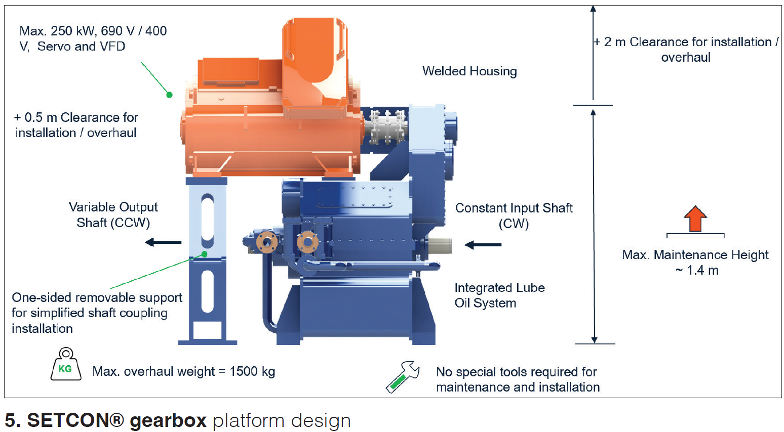

David Crossley, KSB Pumps, ended Monday sessions with Boiler feed pump upgrades. He stated, “Good units can be made even better; optimize pump systems with retrofits.”
He offered a case study project in Austria to upgrade performance, improve efficiency, and simplify operation. Scope of supply included:
  • Bearing upgrade to eliminate forced oil lubrication system.
  • Special baseplate design.
  • Installation of KSB mechanical seals.
  • New Siemens E-Motors with frequency converters.
  • KSB installation and startup services.
He ended with a discussion on SETCON® Gearbox Platform Design that can “boost pump power and speed by 10 percent without replacing the main motor.” See Fig 5.

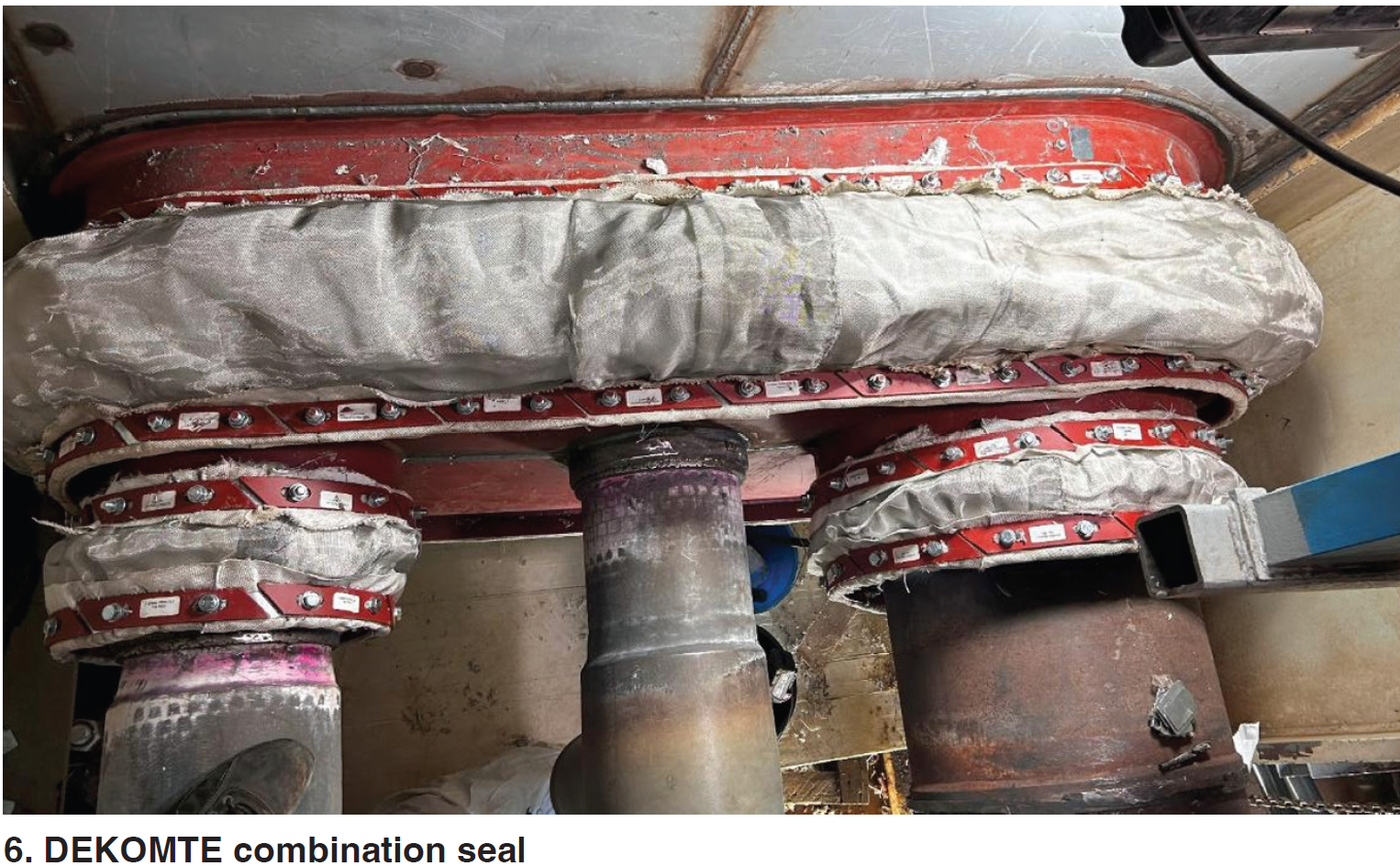

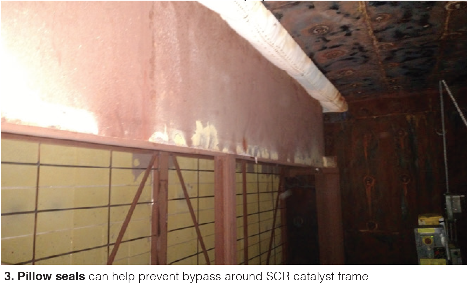

Jake Waterhouse, DEKOMTE de Temple, first presented Side wall large movement penetration seal replacements. He discussed both GT exhaust expansion joints and HRSG penetration seals.
Due to temperature and movement and corrosion, he noted, the expansion joint is the weakest link in the chain. His first example, the hot casing at GT exhaust/HRSG inlet. He discussed his company’s “cycling solution suitable for large duct movements and all GT applications.”
One case study was a GE 6FA transition DEKOMTE fabric expansion joint with internal insulation. He then moved to the GE Flex Seal vs a DEKOMTE solution for longer life, more predictable maintenance, and reduced adjacent temperatures. He then moved to penetration seals and a bellows-to-fabric retrofit (formed vs. flat fabric).
This led to a review of a combination seal solution installed in 2023, focusing on insulation integrity in the casing and around each nozzle (Fig 6).
A number of questions and discussions focused on metallic vs fabric designs.
An interesting topic appeared during the participant questions. Waterhouse summarized that standard HRSG OEM manuals do not discuss the finer points of subsystem maintenance. More inspection and maintenance activities are probably required. He continued: “You need to look beyond what you bought. Look at what you need now, especially with cycling.”

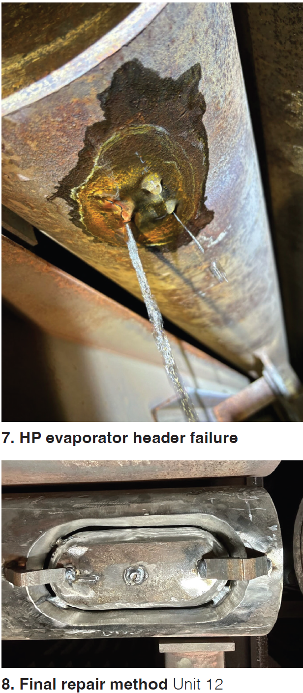

Ryan Geist, Alpha Generation, discussed HP evaporator header cracking and HRSG issues behind H-class GTs. He began with lower header repairs.
At the 2 x 1 Keys Energy Center in Maryland, an HP evaporator header failed near the end cap in late 2024 (Fig 7). Externally, the crack was approximately 3.5 in. in length and 3 to 4 in. from the header end cap. Field NDE revealed the length of the wasted area internally was 5 in.
Structural Integrity (SI) performed the failure analysis. Chlorine was concentrated along the center of the crack oxide deposit. Said Geist, “SI surmised that the failure mechanism is likely chemistry influenced, exacerbated by heavy collections of iron oxide sludge and deposits allowing localized chemistry conditions to potentially affect the base metal.” The HP evaporators include lower capped drain connections (or inspection ports) that are also developing leaks.
A repair plan was developed working with both Vogt and EPRI using SA-106 Grade C, 8.25 in. OD and 1.25 in. thick. A core was removed from Unit 12 Evaporator 4. Repairs were then made (Fig 8).
Issues were found on another unit in Spring 2025. HP/IP evaporators included lower capped drain connections developing leaks, and similar repairs were made.
Contributing factors were identified:
  • Potential for flow instability in an area or individual tubes.
  • Low or no flow at the tubes near the header end caps.
  • Lower heat flux and flows through this evaporator section, more likely to collect iron oxide.

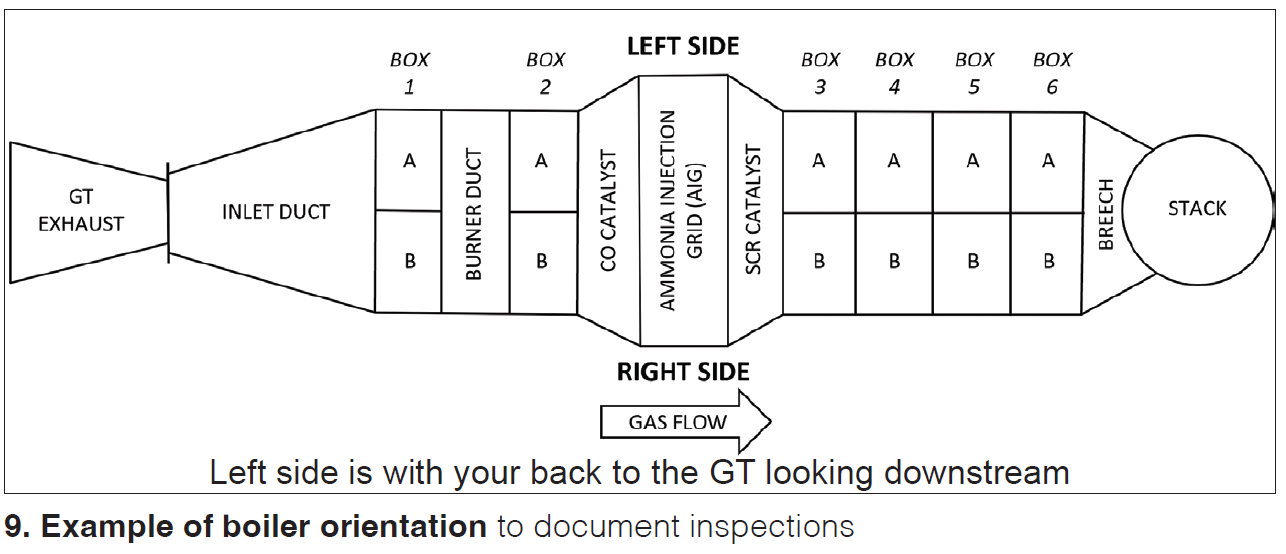

Eugene Eagle, EPRI, ended the day discussing HRSG offline inspections. He focused on offline internal HRSG inspections to “find small issues before they become large.”
Typical scope, he noted, is extensive: “GT exhaust expansion joint to the exhaust stack, drums, external areas, blowdown tanks, attemperators, and evaporator tubes (borescopes).” He added that “it is important to inspect/test attemperator piping and nozzles regularly.” He also recommended scheduling a drone inspection and scheduling NDE as needed.
Eagle highlighted unit orientation to properly record findings and establish inspection continuity, noting that the standard for numbering (including tubes) is left to right, front to back. See Fig 9.
“Annotate as you go,” suggested Eagle, “and take photos.” He showed selected examples of typical findings.
Most questions focused on specific system components and inspection frequency.

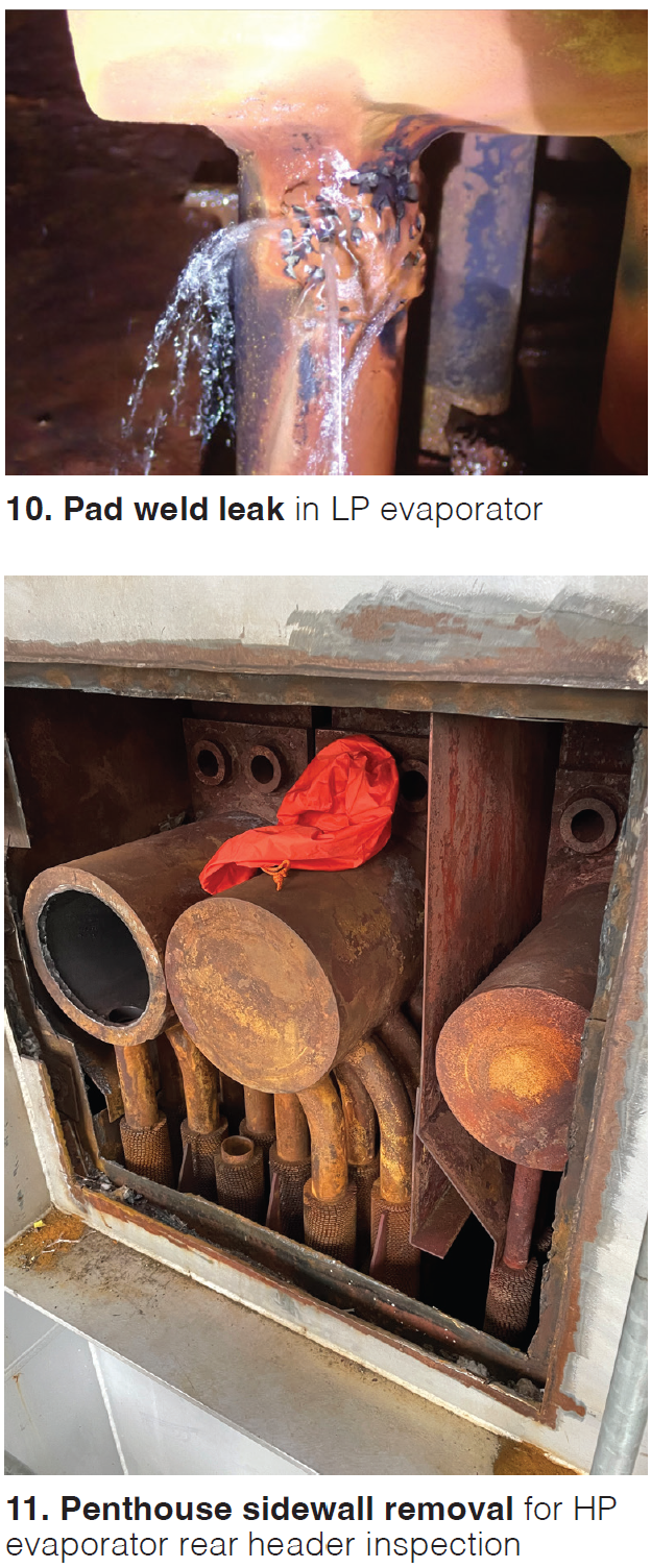

In case histories Beaty said a wet spot was found on the floor under an LP evaporator, traced back to the penthouse with a thin-edged hole found on a tube. TVA made a temporary repair. Then, the pad weld began leaking in multiple locations “likely lining up with all the previous FAC pits.” See Fig 10.
A more conventional repair was performed using both windows cut in the headers and tube plugs. The next step was flat plate plugs.
Access to the LP evaporator is difficult on this unit. Inspection required cutting a wall section out of the penthouse and removing the header end plate (Fig 11).

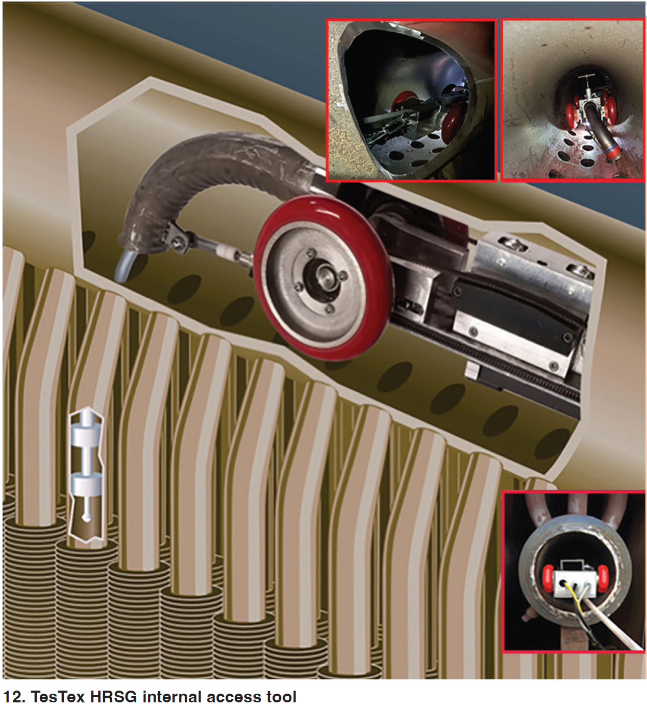

Gowatski (TesTex) then presented Inspection of HRSG tubes using the internal access tool. See Fig 12.
A case history inspection found that 27 tubes had at least 50 percent wall loss. Other units were inspected with similar findings.
“TesTex is currently working with both EPRI and Bob Anderson (Competitive Power) to develop a mechanism to measure the thickness of deposits in HP evaporator tubes that will be attached to a modified version of the Internal Access Tool,” Gowatski said.
He noted another benefit of tool use: it can help determine an exact location for any tube sample removal.
Gowatski requested tube samples from the attendees for this development program.
