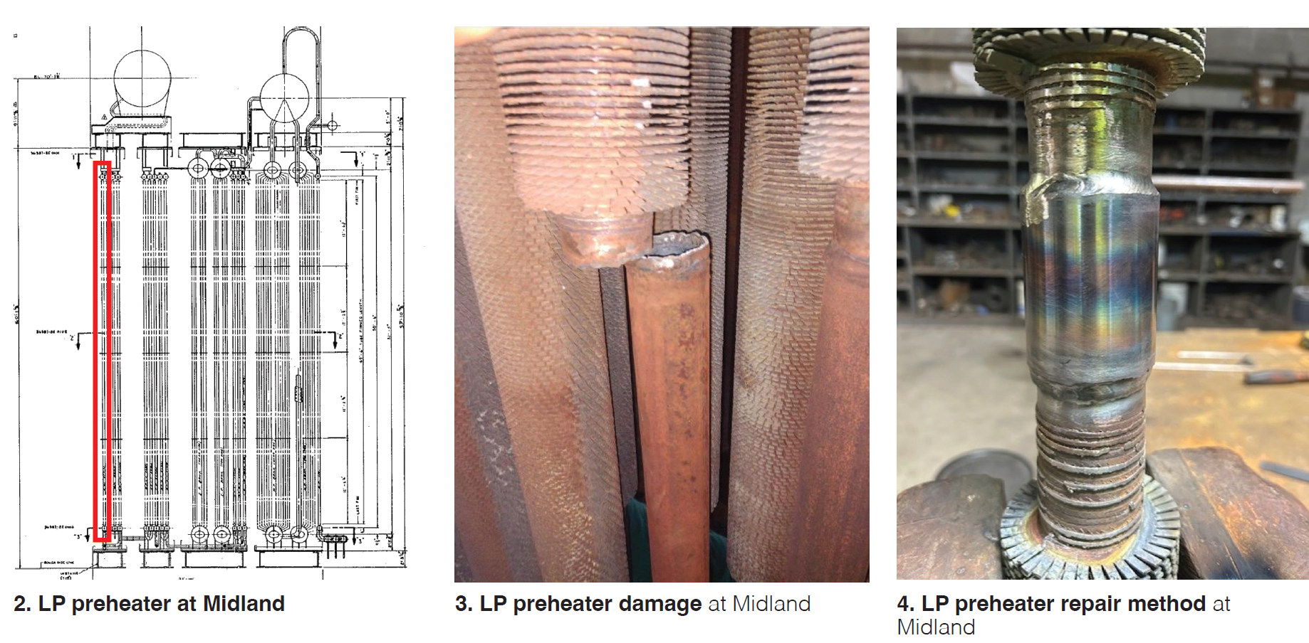

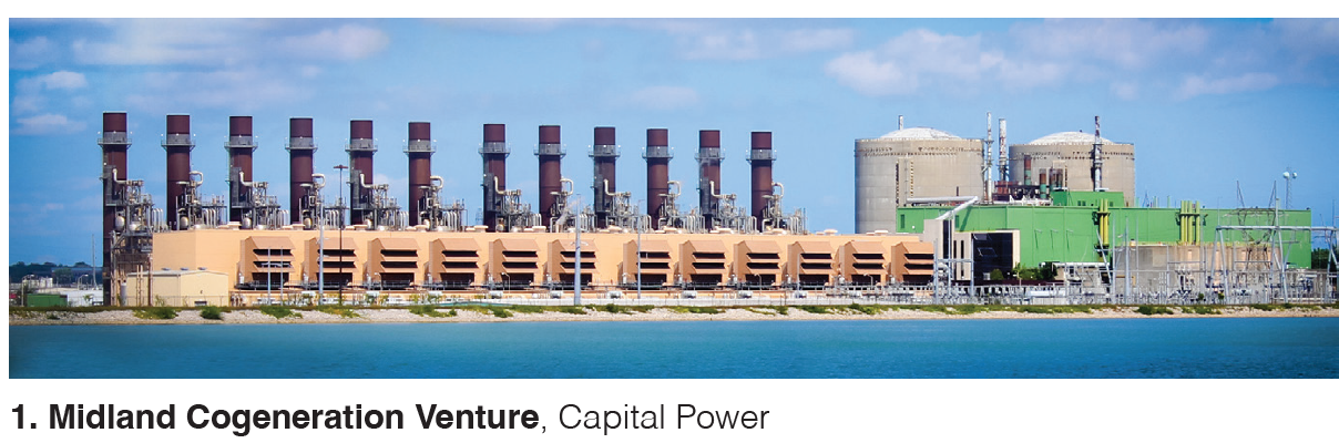

Kristi Gledhill, plant manager, Midland site, opened the user presentations with a look at cleaning old base-load heat recovery steam generator (HRSG) units at Capital Power’s 1500 MW Midland Cogen Venture in Michigan (Fig 1).  “HRSG leaks were the number one cause of maintenance outages,” she said. Gledhill is plant manager, Midland site.
She discussed using the Pressure Wave explosive tube-cleaning process on Unit 10. Coking had become a major issue.
Midland evaluated historical outages, tube leak locations, and estimated costs per year due to the leaks. Root causes were:
  • Thermal fatigue – cycling.
  • Flow-accelerated thinning – water side.
  • Long operating life degradation.
Between 2022 and 2024, Midland experienced 115 HRSG tube leaks. More than 65 percent occurred in the LP preheater. See Fig 2.
This was the first significant cleaning in 35 years, and will now be conducted in as little as 3 years.
The cleaning was successful, Gledhill explained. Debris analysis included rust and insulation, but she cautioned that “you will never get all of the insulation out; it can be unforgiving.”
An interesting takeaway: “Next time we will alert the neighbors to the noise. We got some calls.”
Eric Wolf, Capital Power, returned to these issues later on Day 1. He discussed tube leaks on these 12 Combustion Engineering HRSGs, in operation for 35 years but now causing four forced outages per year.
“Butt welds break apart over time,” he explained, following failure analysis by Structural Integrity. The problems stemmed from both weld procedures and post-weld heat treatment on these older units. See Fig 3.
Structural Integrity was contracted to perform detailed tube section failure analysis. Based on their results, repairs began. Quarter-chrome sleeves (Fig 4) are now being used in some locations. Baffle plate condition was also discussed and reviewed in detail.

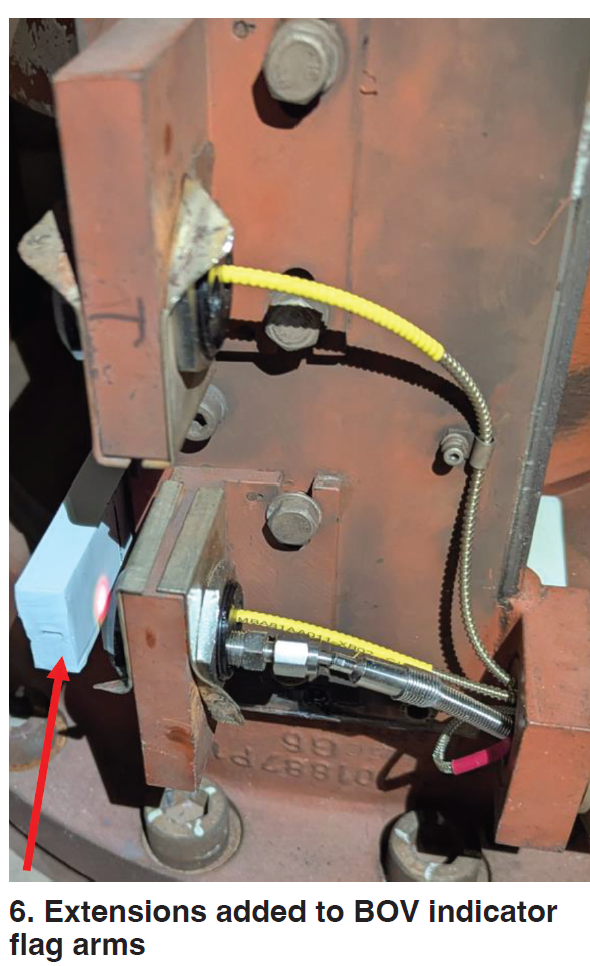

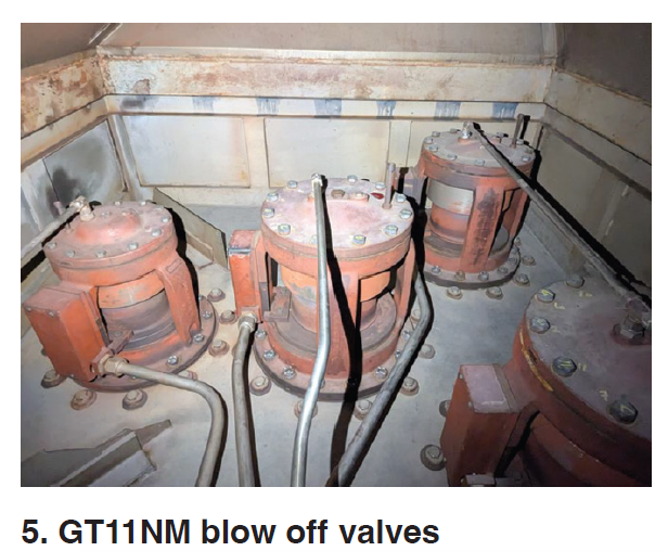

Ross Goessl, We Energies, next discussed Blow off valve control upgrade (GT11NM) at a Midwest utility (see Fig 5). He covered project need, project scope, execution, emergent findings, and next steps.
In this case, “Blow off valves on multiple units stopped opening fully within three years of the major, resulting in the plant needing to force the open indication.” This became a complex, multi-unit issue throughout 2024. Proximity switches failed and were sourced through the AOG Users Group. Further issues developed and workaround ideas were also found through the Users Group.
The plant pursued a valve indication upgrade from Hughes Technical Services (HTS). This involved fiberoptic sensors, reflective coating on indicator arms, additional thermocouple feedback at each stage, and a new control junction box. Extensions were added to the valve indicator flag arms to pick up open indications more quickly. See Fig 6.
The plant also pursued the HTS blow off valve control upgrade which replaced the hydraulic pneumatic safety relay with separate power-oil and control-air systems with solenoid-operated valves and pressure switches, and replaced the control air pressure regulators. Cast iron drain traps were replaced with automatic drain valves.
Work was completed during a seven-day planned outage, including commissioning. This work would be performed on the remaining units.

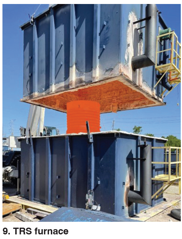

Developments and repair capabilities focus on hot gas casings and furnace capital projects as well as vanes, blades, and turbine vane carriers. He featured hot gas casing modeling and fixture design.
One highlight was the TRS furnace capital project capable of heat treating up to GT13DM hot gas casings and lower combustor chambers while assembled, withstanding temperatures up to 2300F. See Fig 9.

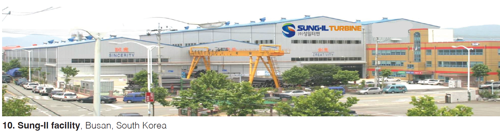

Ta-Kwan Woo was on hand again this year to discuss Blade manufacturing technology available from Sung-Il Turbine, Busan, South Korea (Fig 10). Business lines include turbine parts (blades, vanes, segments), combustor parts, and hot gas path repair services.
He stressed the company’s ongoing research and development. Capabilities include vacuum casting furnaces (vanes and blades, combustor and turbine parts), machining and heat treating, in-house ceramic core manufacturing, and thermal barrier coatings. Also, hot gas path parts repair services, inspections and evaluations are extensive at Sung-Il.
Questions included parts lead times and expected life of spare parts.

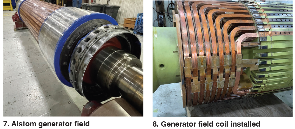

Howard Moudy, Managing Director, NEC, discussed Generator rotors.
The key word is “cycling,” he said, causing “monumental problems for generators.” Focusing primarily on smaller and larger air-cooled generators, he listed known Alstom rotor issues that include:
  • End winding blocking/spacer block looseness and movement.
  • Top turns conductor distortion.
  • Slot liner cracking.
  • Conductor turn joint cracking and failure.
  • Pole-to-pole crossover cracking and failure.
  • Main lead failure.
  • Damper winding cracking and finger liberation.
He then listed key rewind specification recommendations:
  • New pole-to-pole connectors.
  • New baffles.
  • New retaining ring liners.
  • High speed balance with overspeed, running electrical testing, and balance.
He reviewed conductor and slot configuration, copper conductor crushing and distortion, rotor conductor distortion, slot liner cracking, turn-braze joint configuration thinning and fatigue, and turn-braze joint failure.
Further details showed crossover failures, damper winding alignment finger liberation, and examples of negative sequence current. “Heat generated by negative sequence current events,” he said, “can damage a rotor very quickly.”
He followed with visuals of a generator rotor rewind in process. Moudy then moved to retaining ring repairs and replacement.
He stressed that the “copper supply chain is challenged,” then summarized as follows:
  • The pedigree of installed Alstom fleet of generators is wide and deep.
  • A large portion of the fleet is at or past the 30-year design life milestone, and should be considered for life extension.
  • While the Alstom rotor fleet has known challenges, those challenges can often be effectively overcome by applying proven engineering solutions, experienced labor, and diligent planning.
  • Market challenges relating to skilled labor, facility availability, and key materials are important considerations which should NOT be ignored.
