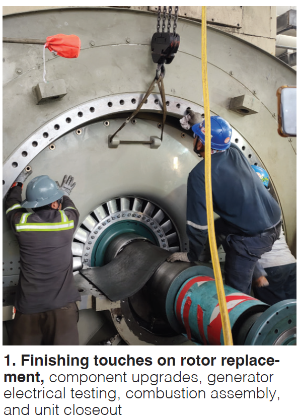

On the GT side, GE Vernova replaced the existing 7FA.03 rotor with an RLE rotor intended to provide longer operating life and incorporate updated design improvements (Fig 1). It also replaced S5 robust vanes in the compressor section to reduce exposure to blade-detachment events that can trigger major downstream damage and extended outages.
This upgrade addresses both life consumption and catastrophic risk. A rotor replacement can extend the service envelope of the unit, but the compressor hardware upgrades also aim to prevent the type of failure that turns a planned outage into a long forced outage.
Taken together, the package strengthens the GT train in three ways:
- Extends rotor life with updated hardware
- Reduces compressor damage exposure
- Supports future availability by addressing major risk items during one planned window

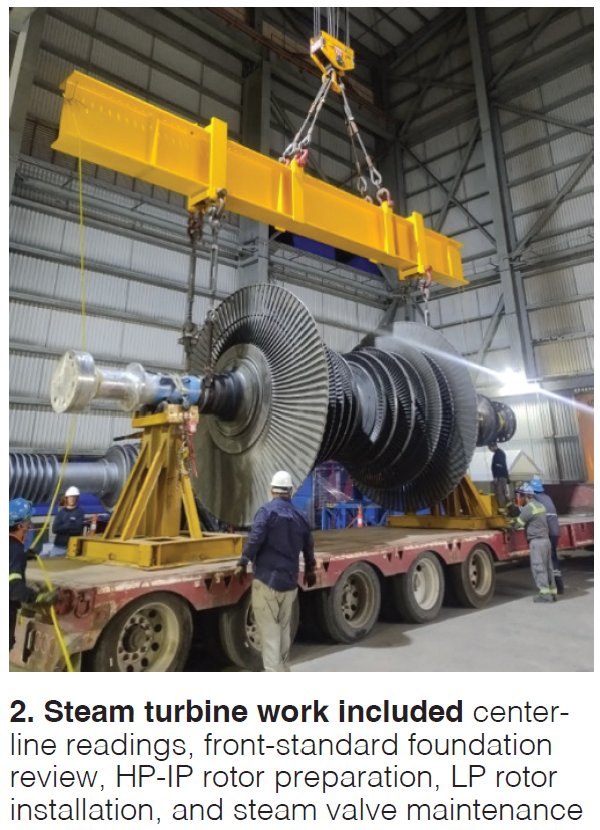

Steam-turbine scope focused on vibration risk rather than waiting for a forced event. The OEM replaced the GEV D11 HP rotor to reduce the potential for high-pressure vibration associated in part with rotor bow seen elsewhere in the fleet (Fig 2). It also used FARO laser alignment to restore centerline geometry and reduce the risk to bearings, deflectors, and the rotor itself.
That is a practical reliability move. Vibration issues on the steam side rarely stay confined to one component, and correcting alignment during a rotor replacement improves the value of both activities.

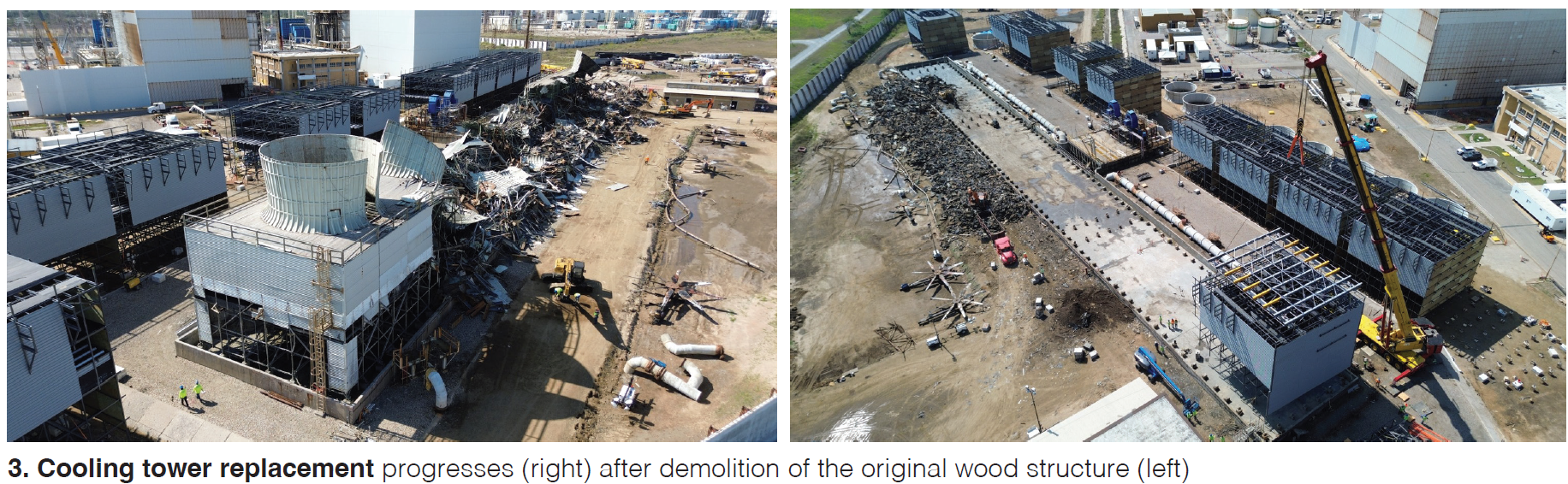

The outage also extended well beyond the turbine train. Cooling tower 2 was replaced with a fiberglass-reinforced-plastic tower from Evaptech in place of the original wood structure (Fig 3). The reported benefits are operationally significant: better saltwater resistance, lower salt-particle drift, and new mechanical equipment from established suppliers.

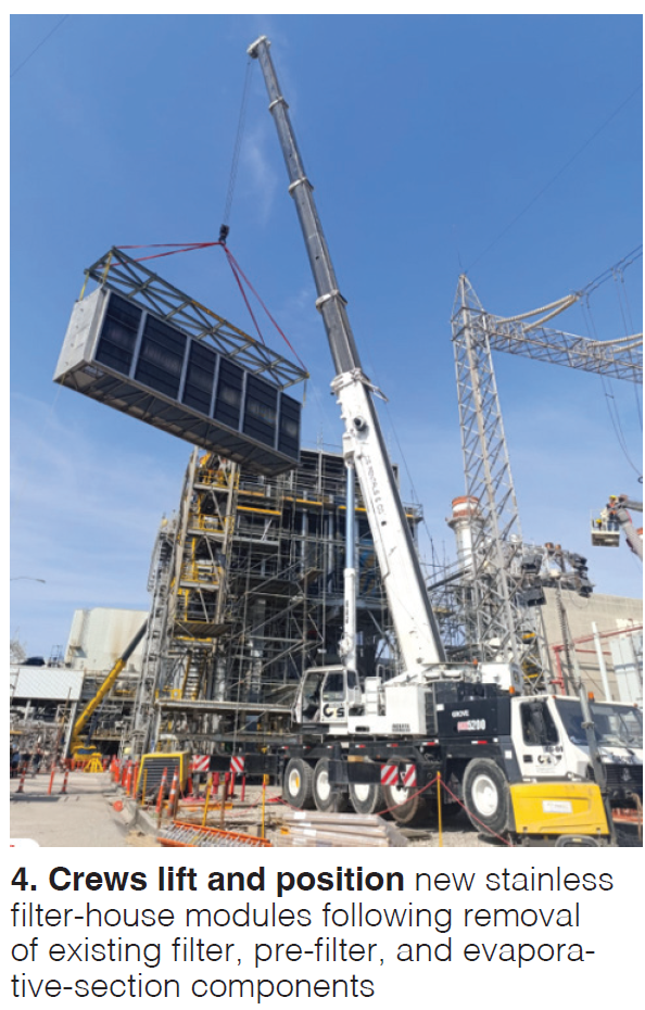

Filtration upgrades were handled with the same long-view approach. The plant utilized Camfil Power Systems to replace carbon-steel gas-turbine filter houses with 316L stainless-steel units and upgraded the filtration system from class F9 to F10 while retaining a two-stage arrangement also provided by Camfil (Fig 4). The target replacement interval also moved from two years to four.
That combination is important because filtration performance depends on more than media efficiency. Housing integrity, corrosion resistance, sealing, and bypass control all affect actual machine cleanliness. Replacing the housings along with the filters suggests the plant is treating inlet-air quality as a system issue, not simply a consumables decision.
Quantum’s stated goal is to maintain compressor cleanliness well enough to eliminate four scheduled offline water washes per year, based on prior plant experience. If achieved in service, that would reduce downtime burden while also improving compressor condition between major inspections.
