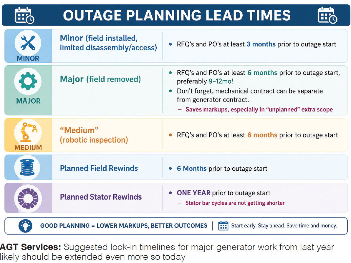

AGT Services warns on generators. Users responsible for aging generators can get uncomfortable (but very knowledgeable) in a hurry reviewing Jamie Clark’s slides on generator outages. To put it simply, supply of shop services and components and demand for repairs, upgrades, and replacements are out of sync. Review how he builds the case in the slides.
Balance of slides help users “get their minds right” regarding the different types, levels, and duration of inspection techniques; repair durations; when to lock in resources (earlier, not later) for major work (illustration); evaluating winding resistances; realities of procuring spare fields; and limitations on field inspecting and repairing only “what you can see and feel.” Comparison between a robot wedge map from a spring outage and a hand wedge map from a spring outage three years later is especially illuminating.

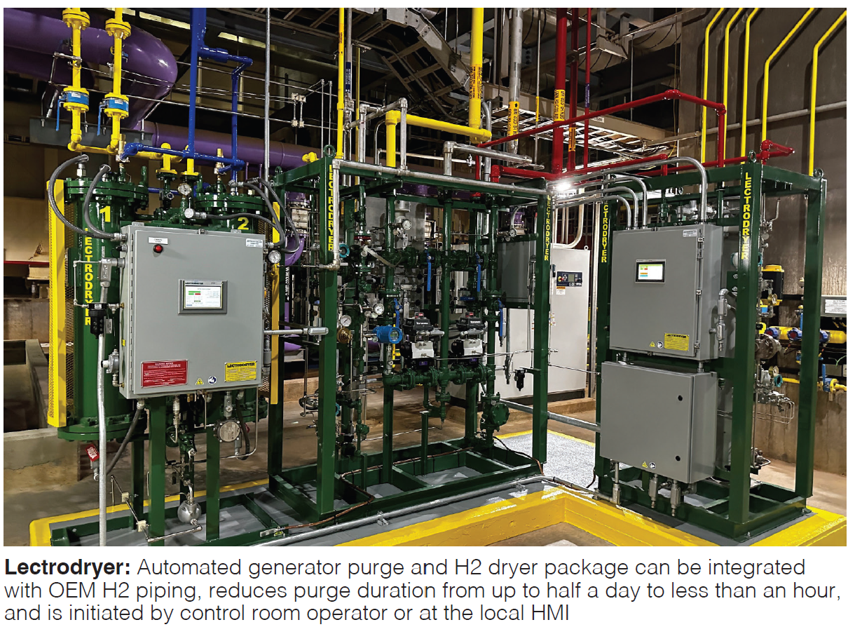

Lectrodryer’s generator fast purge. Rob Kallgren surely got the audience’s attention with photos of three catastrophic generator explosions, then proceeded to explain how a fast automated H2-purge and dryer installation (specific features covered in slides) can avoid them and reduce purge duration from 6-12 hours to less than one hour. He covered three case studies – shutdown for a hurricane, cracked H2 piping weld, and loss of seal oil. Details are not in the slides but Kallgren would be pleased to fill you in if you contact him.

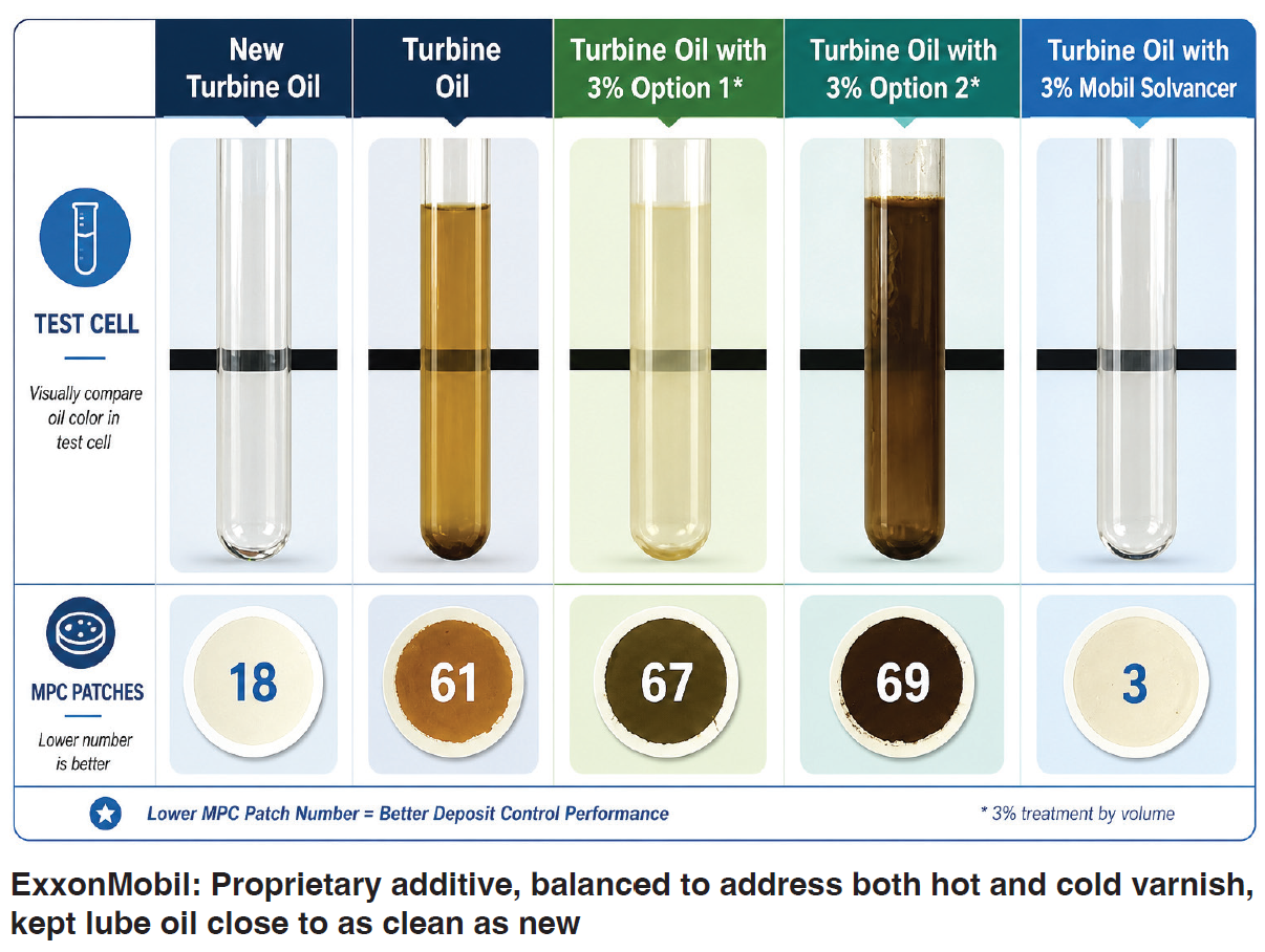

ExxonMobil – address hot and cold varnish. Cody Evans distinguished between hot and cold varnish in lube oil systems, characteristics, how formed, where each is found in different areas of the turbine, and why it’s important to test for both. Oil analysis (slides review four standard techniques) is a good predictor of cold varnish, which may not impact operation if the tolerances in the hydraulic systems are not too tight.
Hot varnish, or sheer-stress-induced deposits, is almost always the result of another mechanical or environmental cause and is best indicated by a gradual rise in bearing temperature (not caused by other factors). Oil analysis and vibration may not correlate.
Company’s Solvancer additive is said to be the only one on the market formulated to adequately treat both hot and cold varnish and suitable for long-term use. Other options, in fact, like PAG with amine antioxidant, may actually aggravate varnish formation when used for more than three months.

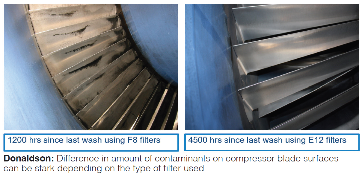

Donaldson urges optimizing filtration. Bob Reinhardt encourages users to focus as much on operational impacts from poor filtration as they do on maintenance aspects. He stresses that all the important filtration objectives are not necessarily addressed by current industry standards. Total cost of ownership (TCO) of a GT can be optimized with modern intake air housing designs and by selecting filter materials which may have a higher first cost but pay dividends over the life of the machine (illustration).
Opening slide is a stunner, an illustration of the volume of air moving through a 7FA per hour and the amount of contaminants collected (180 lbs/hr in a desert location!). Following slides show how to do a thorough TCO assessment of filters, for example comparing filters using a rating system that includes efficiency rating, water tightness, and cleaning pulse recovery rate, then plugging those values into a TCO model for the unit.

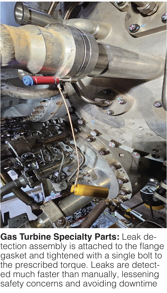

HP Leak Detection – all in the name. There’s a better way to detect leaks at piping flanges than having a worker do the “flag flutter” test. Experts from HP Leak Detection explained their patented, demonstrated “CRANK” technique, in which the system is tested at 1 psi with a “balloon” clamped to the flange. The balloon deploys at 0.2 psi signifying a leak. If the flange passes the balloon test, it is ready for continuous monitoring and a gold cap replaces the balloon (illustration).
Should a leak occur during operation, the gold cap lifts off, acting as a warning flag to workers. A pressure switch/transmitter can be added to provide a signal to the control room or a remote location. Technique accommodates a wide range of gases and flange types. One important application is turbine compartment airflow. Several prominent O/Os have signed on with testimonials.

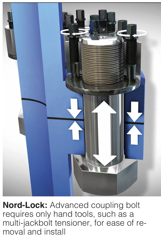

Nord-Lock offers better bolts. Removing friction-drive and shear-drive coupling bolts often isn’t straightforward, and workers resort to destructive removal. The drop-in (no mods required), permanent replacement Superbolt EZFIT design offers “tremendous radial expansion and joint clamping power,” thanks to a split expansion sleeve which mates with the customer’s machined holes.
The advanced bolt avoids the wing-type locking feature, 50-lb tensioner device, mis-aligning the tensioner puller screw into the conical thread, dangerous windage plates/covers, and rental of specialty hydraulic equipment. Design, manufacturing, and engineering details are covered in the slides, along with several applications in GT powerplants and short list of customer sites using the technology.
