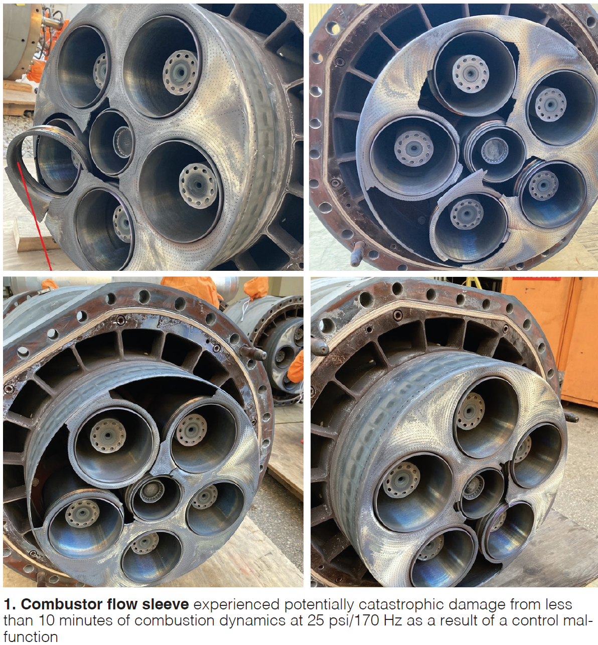

Here’s a word of warning from an O/O rep presenting on a candidate for “catch of the year”: If you don’t have the enhanced compressor components (all 7Fs with an 18-stage axial unit), do the inspections recommended in TIL1509. Staff at this site found cracks in compressor blades which could soon have led to a catastrophic event.

Read the tea leaves. Kicking off the conference with an in-depth primer on the DLN 2.6 combustor hardware, flow diagrams, and tuning, the presenter urged his audience to “learn to read the tea leaves” of your components. For example, dark areas on combustion liners indicate poor air distribution and/or too much air leakage. Leaking air is often the root cause of NOx issues.
Discussion focused on essential terminology and potential issues with fuel/air ratios, tuning constants, combustion dynamics (Fig 1), leakage in compressor bleed (CBV) and inlet bleed heat (IBH) valves, part load operation, emissions, and axial fuel staging. Combustors are not as predictable as a gearbox, says the presenter; fire still has a “dimension of mystery.”

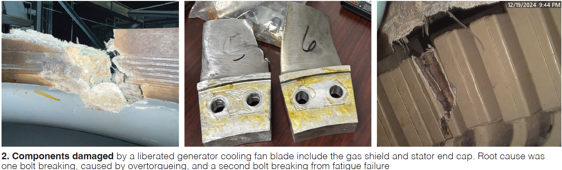

On the fifth day before Xmas in 2024, operators noticed a step change in vibration from 0.07 in/sec to 0.36 in/sec on the 7FH2 generator T4 bearing (BB7 and BB8), not high enough to trigger an alarm, and coinciding with a step change in generator fan blade differential pressure (DP). Personnel hypothesized that the cause was a liberated fan blade.
Sure enough, there were no findings from a borescope inspection (BI) on the turbine end, but inspection of the collector end (T4) revealed a liberated cooling fan blade, and damage to the gas shield (fiberglass exterior with a balsa wood core) and stator end windings. What a time for a forced outage!
Nevertheless, the plant was back on-line by January 7, thanks to a coordinated effort between the O/O and the OEM, which was able to provide all the parts except the gas shield. Securing the gas shield, a challenging aspect of the recovery, was accomplished by having it repaired by a non-OEM firm and using ancillary parts from the OEM. The plant was lucky that the stator end cap could be repaired in situ.
Blade liberation was likely caused when the No. 1 bolt of cooling fan blade No. 5 broke because it was overloaded due to overtorqueing at install. The remaining No. 2 bolt could not hold the blade in place under cyclic stress forces and likely failed from fatigue (Fig 2).
In response to audience Q&A, the presented noted that the last time these parts were “looked at” was in 2017, three years after the fan blades were installed and that they believe the unit had undergone a number of starts and hours “typical” of a ten-year period.
Words of wisdom from the presenter: Do not ignore the M&D alerts!

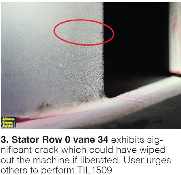

Avoiding a compressor wipeout. If your machine has non-enhanced compressor components, do the annual inspections recommended in TIL1509 R4, urges the presenter. Indications were found in one unit at his plant, with two 7F.03A peaking units, which could have resulted in a liberated S0 row vane and a machine wipeout. Those indications were not present a year ago and fifty starts earlier. Units have undergone relatively low starts and hours.
TIL1509 recommends the inspection because vanes can lock up and reduce damping, causing trailing edge distress. Locations vary between the root and halfway up the vane. Multiple cracks may be observed and several vanes may exhibit them. Vanes at bottom dead center are most susceptible. At this plant, vane 34 exhibited a significant crack (Fig 3). The plant underwent a forced outage and replaced S0 vanes and other stator rows, which had been in service for 15 years (and were “rusting”) with “enhanced” compressor components.
Presenter noted that insurance company was “very interested” in seeing this upgrade occur and that other users have been “encouraged” by their insuruers to replace original vanes with enhanced ones available from the OEM and one non-OEM supplier. During the Q&A, one seasoned veteran noted that these issues apply to both the flared and unflared compressors, and that one site did not replace the S3 row when they upgraded and it ended up failing. So, change out all stages when you upgrade.

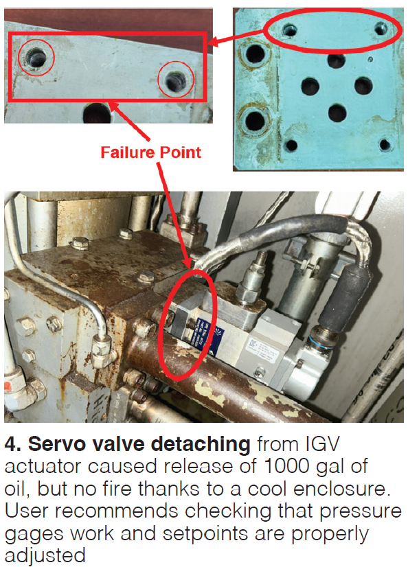

IGV hydraulic blowout. Workers at a baseload 2×1 CC site with 7FA.03 units (2002 vintage, but initial operation 2011) noticed an oil leak in the turbine compartment during a planned shutdown. Fortunately, the compartment was cool enough that no fire occurred. Initial investigation revealed that the servo valve detached from the IGV actuator via stripping of smaller bolts holding the device together (Fig 4). Around a 1000 gal of turbine lube oil was released, with minor escape through small cracks between floor and walls (though not reaching drains or ground).
At conference time, the incident was being more thoroughly investigated, but the presenter offered a few theories, and as importantly, these suggestions:
  • Make sure pressure gages on the low and high sides of the pumps are working  and consider adding transmitters and trending them in the control room. At time of incident, local gages had topped out, and no trending is done, but it is believed that pressure surpassed 4000 psig.
  • Ensure hydraulic PMs are conducted and confirm pressure setpoints. Periodically confirm relief valve operation.
This site replaces valves on a five-year cycle but this PM may change pending results from the investigation.

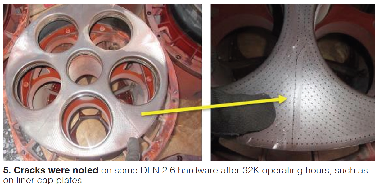

Important O&M detail: After 4.5 years of operation, some DLN 2.6 hardware at one site exhibited small cracks (Fig 5) and had to be recoated, but the fourteen combustions liners and transition pieces “looked good.” One lesson learned is to anticipate unforeseen work, in this case exhaust frame leak repair and exhaust flex seal replacement.

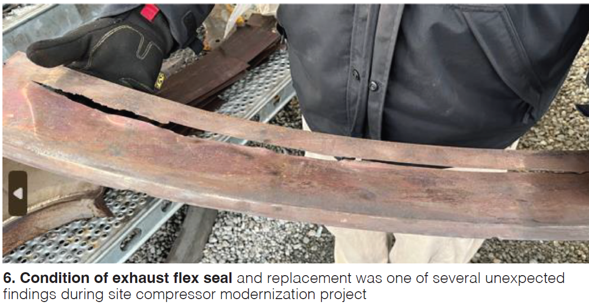

  • Exhaust flex seal inspection and replacement (Fig 6)

Other major component replacements include the turning gear and the AO42 exhaust diffuser duct. The slide with the list of obsolescence/end of life concerns is also an eye-opener.

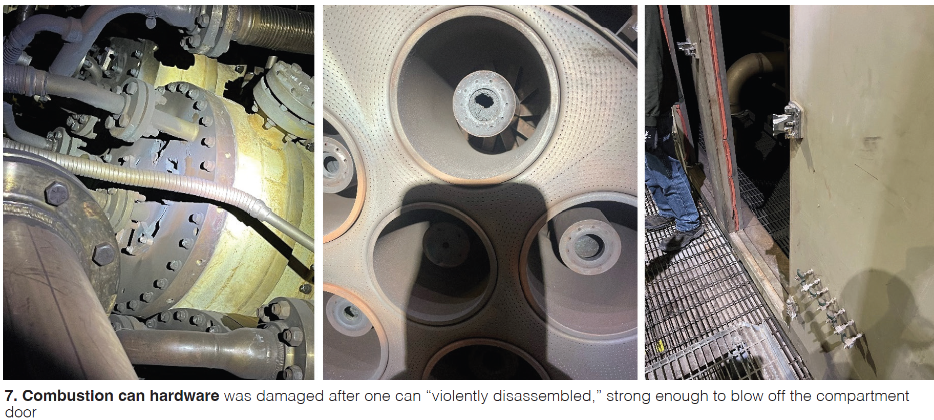

During a session on combustion, one user described the event which led to TIL2552 addressing fire protection trips. Several months after an HGP outage, one GT at a facility with two 3×1 CC blocks tripped on fire protection. CO2 had discharged into zone 1, combustor can 13 had “violently disassembled” at the end cap, and the turbine compartment door blew off its hinges, yet there was no active fire.
Damaged components (Fig. 7), such as the end caps and fuel nozzle assemblies for cans 12-14, fuel gas flex hose for can 13 (pig tails), and can 13 to 14 crossfire tube, were quickly replaced. Combustion and turbine sections went through BIs. Some cooling passages on the stage 1 nozzle were found to be clogged, requiring additional inspection work.
Why and why can 13? The RCA revealed that, after the outage, the site was dealing with a hot spot swirling back to can 13 or 14 for which tuning efforts were unsuccessful. Multiple subsequent BIs revealed nothing unusual. An engineering case was opened with the OEM and active at the time of the event. Other possible contributing factors were that the compartment was only rated for 2.5 in H20 pressure, the nozzles in can 13 may not have been refurbished or flow-tested, and the compartment door had surpassed its expected life of 20 years.
One year later, the OEM issued the TIL and stated that the unit exhibited elevated exhaust spreads, though remaining below trip limits. The O/O did not recognize this as a potential contributing factor during its initial investigation. Further, the O/O is concerned that the logic changes recommended in the TIL could result in even more trips.
One audience member reported his plant ran for 3-4 months after an HGP outage and also had combustion issues. At one point, bolts sheared off, liberating whole end caps. They don’t yet understand what caused the event.

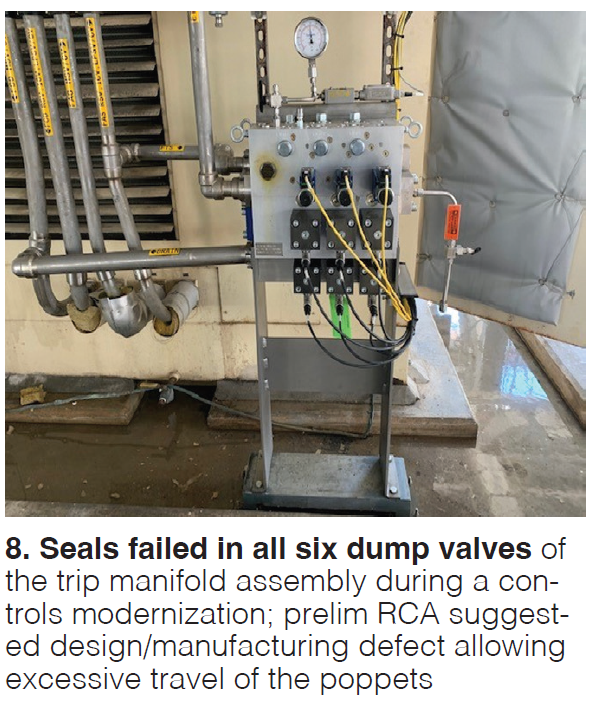

To a “triple major” outage last year, one site added a control system modernization and a complete cooling tower replacement. Scope on the controls included Mark VI to Mark VIe upgrade, migration of steam turbine/generator controls from Ovation to the Mark VIe, and an upgraded vibration monitoring package from System One to Orbit 60.
Overall performance results were impressive: 6.4% gain in net output, 2.1% heat rate improvement, 142-MW improvement in net 2×1 mode turndown, and 71-MW improvement in 1×1 mode turndown.
Challenges, observations, and lessons learned include:
  • Failure of a capacitor in a digital valve positioner after 3000 hours service.
  • Shortcomings in the valve hydraulics original design
  • Seal failures in all six dump valves (Fig. 8) in the trip manifold assembly attributed to excessive travel of the valve poppets within their sleeves).
  • Incompatabilities between the old and new ST/G trip controls logic design philosophy
  • High turnover of OEM technical advisors and varied familiarity with systems
  • Incorrect sizing of the HP main level valve
  • Some TILs did not get captured in the upgrade
  • 10-12 days required to commission control system per unit.
  • Improvements necessary for lube oil lift valve hydraulic system and bleed capability.
