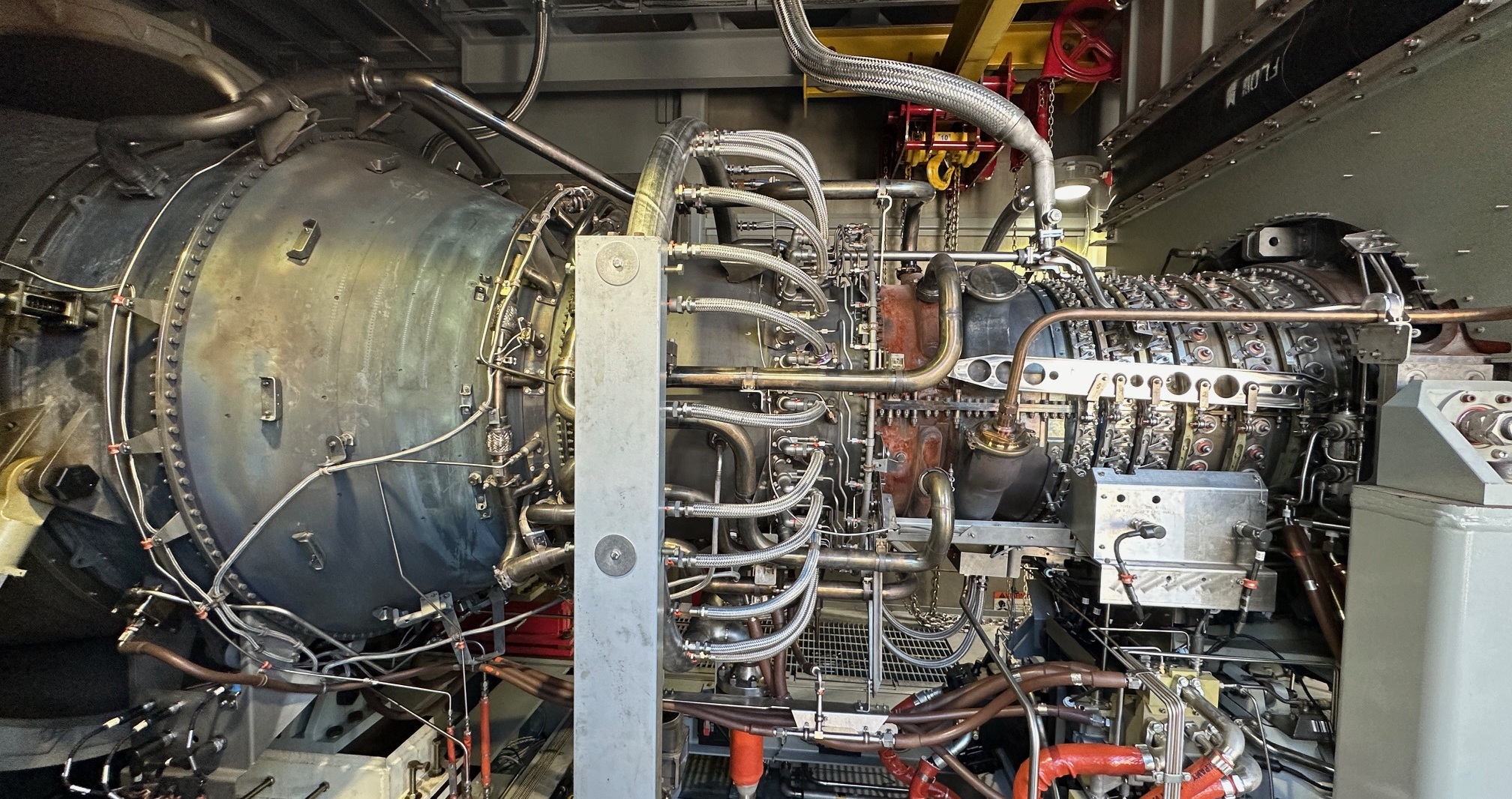

LM2500, GE
GEV kicked off the LM2500 session with several of its engineers presenting. Product Leader Nam Tram began the company’s participation with a safety moment and GE Vernova fleet overview: More than 40 million operating hours (in round numbers) recorded by1161 LM2500 base, LM2500+, and LM2500+G4 machines. Highlights of the presentation include the following:
Completed engine programs
- Multiple spline wear events in the field, usually detected when the engine is unable to start after shutdown. Wear is caused by inadequate oil bath levels in the spline area. Enhancements and recommendations are offered to correct the issue.
- Gas fuel hose contact wear on DLE engines caused by small variations in length of individual hoses. Procedure for checking the clearance between adjacent fuel hoses is provided along with enhancements to correct the issue—including a new P-clamp assembly.
- Wire-mesh ejector screen to prevent ingestion of foreign objects into the sump pressurization system has suffered damaging flow-induced vibration in many cases, causing wear at the wire filament crossings. Guidance on identifying wear, and screen replacement, are provided.
- Some engines were shipped with lube and scavenge pumps that have non-conforming drive keys installed on the shaft driving scavenge element. Operation with heavily contaminated lube can shear keys prematurely and flood the engine sumps with oil. Cause: A heat-treat anomaly. Recommendation: Check OEM correspondence to see if your unit has been identified for replacement.
- Nitride bearings 4B, 5R, and 7B have been identified with several “events” caused by hard-particle contamination. Recommendation: Install nitride bearings in accordance with Service Bulletins, 304, 305, 306, and 309.
Active engine programs
- Displaced fuel-manifold hinged brackets can cause contact between the bracket and liquid-fuel tubes, possibly contributing to fretting wear and a fuel leak. Flex brackets without hinges are in development. Stay tuned.
- Reports of leakage from the flexible hose integral to the sump vent manifold are attributed to fretting wear between the corrugated hose and protective braid. Inspect for manifold leaks and replace with current configuration until new hardware is available.
- Fracture of the TLO lube-oil pump spline manifold causes oil loss and potential clutch starvation. Belief is that miss-handling/installation created a preload on the tube. Instructions for proper installation are reviewed; possible solutions are under review.
- LM2500+G4 HPT first-stage blades have experienced trailing-edge oxidation, especially in wet SAC applications. Early maintenance and higher scrap rates are concerns. Service Bulletin was expected end of last year, assuming availability of spare blades.
Completed package programs
- Be on the lookout for 360-deg crack/damage on the inner skin of the exhaust tunnel at the gas-turbine end, which was reported on one unit in the fleet. Dissimilar thermal growth between two liner sections welded together are the apparent cause. Retrofit instructions are presented for this repair.
- Control software has been updated for implementation of the logic to add resettable start (cycle) and hours counters on the HMI screen for subassemblies (LPC, HPC, combustor, LPT, and HPT). Recall that counters and timers, and run hours, for the subassemblies must be easy to reset when parts are swapped or replaced. Field recommendations for software updates are covered in Product Bulletins 325-327.
- Quality issues identified with the large quick-disconnects for the hydraulic starter motor, vent van motor, and liquid boost skid pump have been corrected. The installation procedure for the disconnects was a major contributor to the distresses documented. Consult Product Letter IND- 24-001 to dig deeper.
- Blowdown hoses between the pulse header tank and the blowdown pipe supplied with the air inlet houses from one GE subcontractor had inner diameters too large to fit securely to the connection points at each end of the hose. Fix is simple: Replace hoses with those of smaller ID. Consult Product Letter IND-24-002.
- Mixed fittings for Hamlet (Ket-Lock) and Swagelok connections in LM packages, not endorsed by GE Vernova, may contribute to leaks. Recommendation: If mixed fittings are identified, rework the components to assure Swagelok only hardware. Consult Product Letter IND-24-003.
- Investigation of distressed power-turbine blades concluded that uncompensated combustion during startup, which could be caused by any significant disturbance in fuel-nozzle flow,
- thermally distressed the blades. Issues can be avoided by use of the latest software to monitor individual T48 probes and spread during sub-idle operation and to shut down the unit if limits are exceeded. Consult Product Bulletin IND-328.
- LM/TM2500 product bulletins released since the 2023 WTUI conference and not mentioned in the completed package programs listing immediately above:
- IND-317, “LM2500 turbine enclosure air flow improvement,” which provides instructions for modifying some components to improve ventilation air flow inside the turbine room.
- IND-319, “LM2500 liquid fuel supply flex hose/pipe replacement,” to mitigate fuel leak distress on units designated as TM2500 GEN8.
- IND-320, “LM2500 and TM2500 exhaust-collector tunnel repair,” provides instructions for repairing the exhaust-collector tunnel when cracks are in evidence on the front end—specifically on the inner liner.
- IND-323, “LM2500 Xpress/K115 relay dial settings.” Purpose is to introduce the latest settings for relay K115 for proper reset action after emergency shutdown.
- IND-324, “TM2500 GEPC generator cooling-fan blade liberation,” references the relevant customer technical communication letter from GEPC.
- LM/TM 2500 product letters released since the 2023 WTUI conference and not mentioned in the section immediately above:
- IND-24-004, “LM2500 Xpress gas fuel manifold leakage, hose leak TP” provides guidance on gas-fuel leak checks for the LM2500 Xpress.
- IND-24-005, same as 004 except for the LM2500 Universal.
- IND-24-006, same as 004 except for the LM2500 Gen 8.
Active package programs
- Vibration monitoring. Introduces Orbit 60 as the latest vibration monitoring system to replace the BN3701, declared obsolete by Bently Nevada. At the time of the 2024 WTUI meeting, GE was developing instructions to replace BN3701 with Orbit 60.
- Ethernet configuration mismatch in the vibration signals from the turbine rear frame, gas generator, and power turbine being communicated between Bently Nevada and the HMI. Crossed signals affect HMI readings, high-speed data logs, and onsite monitoring. The good news: Vibration protection of the unit is not impacted. Suggestion: Implement the product bulletin when it is released (was targeted for the second half of last year).
- An Rx3i firmware update is required by those TM2500 Gen8 units running with Rx3i controls. The issue: A group of signals were shown as “0” and then recovered back to previous values a few seconds later. Investigators found that Rx3i firmware was not updated across the fleet and a Peripheral Component Interconnect interface logic bug was found in certain I/O modules. Recommendation: Implement the product bulletin when released (was expected before the end of 2024).
Best practices
- Preservation topics for installed units:
- For units in storage, (1) Ensure the gas turbine is preserved as recommended in GEK procedures presented in Appendix B. (2) Keep packaged systems dry using covers, silica bags, and/or heaters. (3) Protect from rain and direct sunlight. (4) Keep drains free and manual ball valves open.
- For units ready to run or in standby, merge operational needs with preservation activities. Example: Full speed/no load operation can be used to wet the gas-turbine and generator bearings.
Also, prepare your local preservation and maintenance plan according to site operational needs and standby time, with consideration for ventilation and the combustion path, fluids, electrical components, and motors.
Record activities performed during the standby period.
- Air filtration systems:
- Perform regular inspections of the air filtration system—including hoods, dust hoppers, and conditioning coils/coolers. Remember that proper cleaning and maintenance facilitate filter-media performance.
- Conduct regular inspections of components downstream of the filter section. Be sure to look for and eliminate (1) gaps allowing ambient air to enter, (2) leaks and dirt accumulation in instrumentation, (3) buildup of foreign material in drain lines.
- Lube oil maintenance recommendations provided in the last slide in this section of the presentation are critical to maintaining oil quality. Recommendation is to retrieve the presentation and develop a checklist.

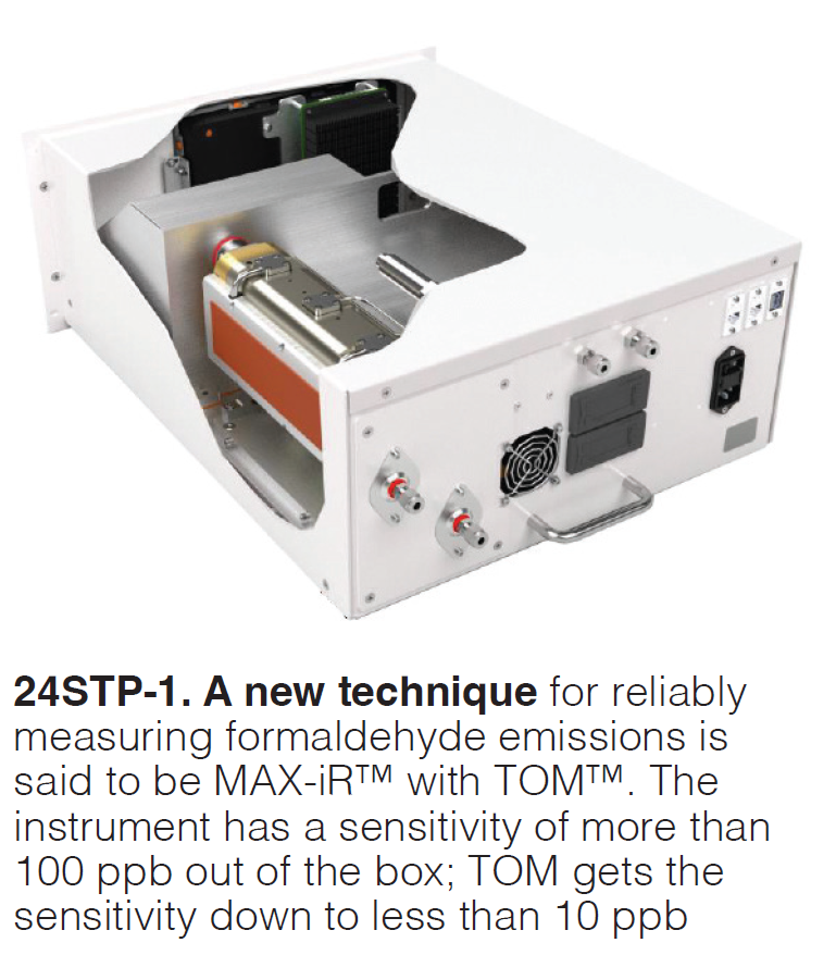

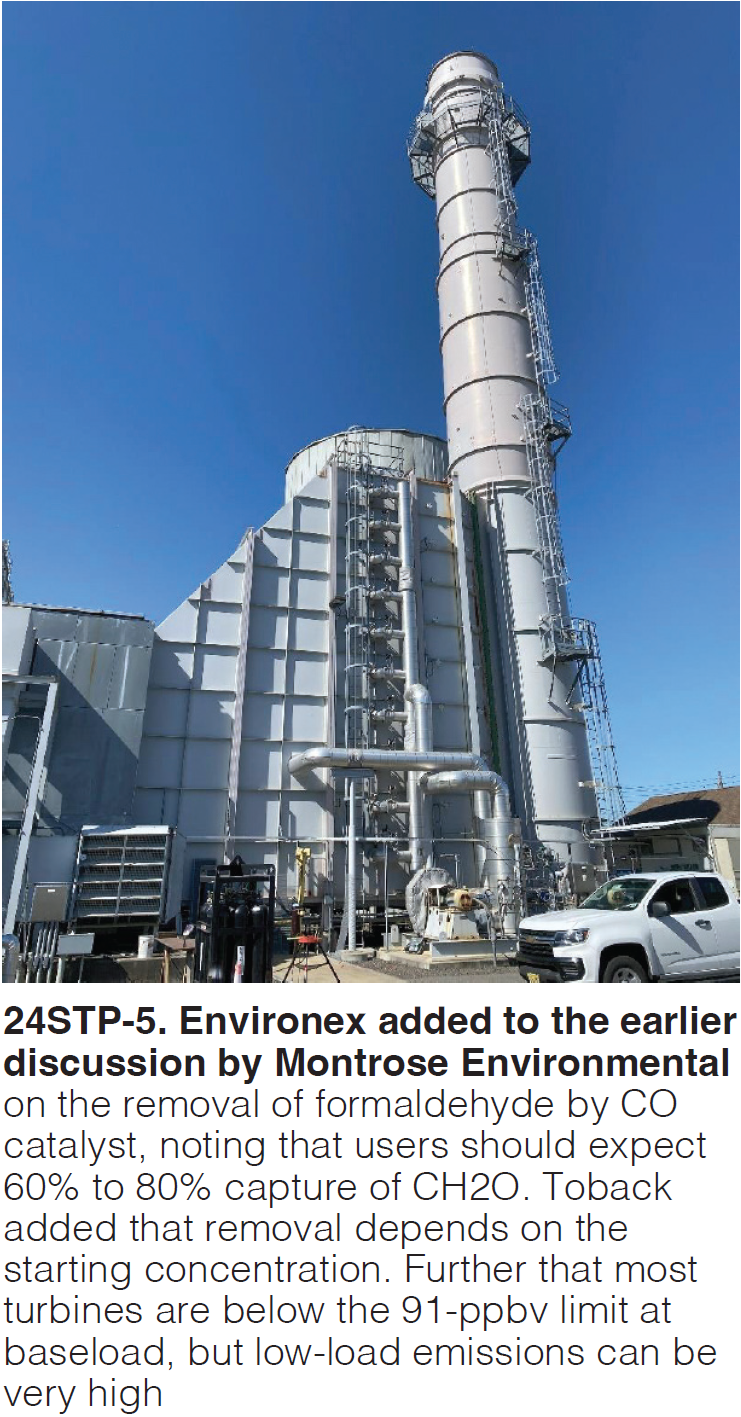

Formaldehyde regulations and air testing on LM2500 and LM6000 turbines, Blake Ericson, Montrose Environmental Group.
New regulations require that many LM2500 and LM6000 gas turbines be tested for formaldehyde emissions. Recall that formaldehyde forms from the oxidation of methane and typically is found in concentrations of 200 to 800 ppb at the catalyst inlet. Also, that lean premix combustors emit lower levels than diffusion-flame systems.
One of the challenges faced by some owner/operators is that traditional testing methods cannot accurately determine formaldehyde emissions below several hundred ppb, let alone the 91-ppm threshold specified.
Ericson identified new optimized techniques for measuring formaldehyde emissions at much lower concentrations than are possible using standard methods (Fig 24STP-1). Some are said to provide continuous and real-time data useful in combustion tuning, compliance, engineering, and demonstration of combustion or post-combustion controls.

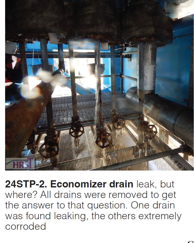

Advanced inspection ahead of major outages for maintenance planning, Jack Odlum, HRST Inc.
Aging HRSGs experience problems that require greater effort to find and assess compared to those associated with newer boilers. Pressure-part component degradation mechanisms like creep, fatigue, and pitting require advanced inspection tools—those that allow you to see what you normally would not—to detect problems early and allow adequate time for planning of repairs to coincide with already-scheduled major turbine outages (Fig 24STP-2). This approach saves time, money, and effort.
Presentation highlights several inspection techniques—including UT, borescope, pulsed eddy current, MT, PT, phased-array ultrasonic testing, infrared imaging, replication—and identifies strengths and applications, as well as the locations and timetable to target their use ahead of major turbine outages. Examples and photos of these techniques, significant findings, and the impacts they have on future outage planning are instructive.

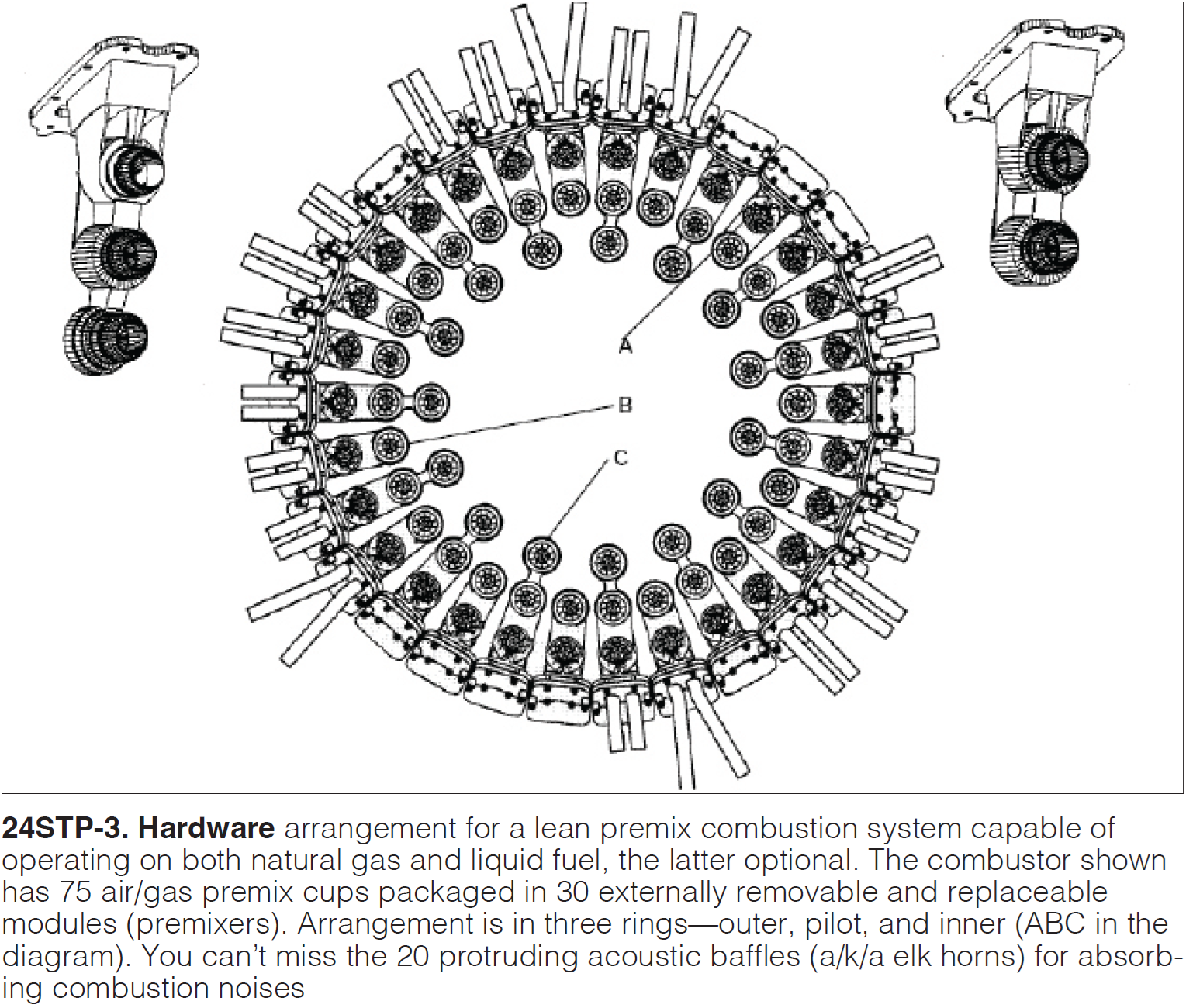

GE LM series DLE, “DLE 101,” Marc Forget, ENGIE Electrabel-EMS Aero.
GE LM DLE technology differentiates itself from SAC (single annular combustor) by using lean premix combustion. Aim of the presentation is to educate DLE users and demystify DLE technology and controls, a goal achieved. It enables users to come away with a better understanding of operational issues they may encounter and be better prepared to efficiently troubleshoot problems.
The presentation is divided into the following sections and easy to follow:
- DLE introduction, including discussion of the NOx versus CO emissions compromise.
- DLE hardware (Fig 24STP-3).
- Flame temperature control.
- Controls protection.
- Mapping basics.
- Real world issues, including sulfur deposition, gas system fouling, premix air leaks, acoustic baffle liberation, etc.
Forget began by outlining the differences in construction and setup between the two combustion systems—including combustors, premixers, and DLE fuel-system layout and controls.
The need for DLE unique instrumentation—such as gas-quality and combustion-stability measurements, GP sensors for fuel-flow calculation, and accurate fuel regulating valves—is discussed, as well as the impact of these instruments and components on gas-turbine operability.
Following an overview of the basic principles of DLE combustion controls, users are introduced to key system parameters—such as the different calculated flame temperatures, combustor staging, window operation, and fuel-flow regulation and distribution—as well as the impact of ABAL logic.

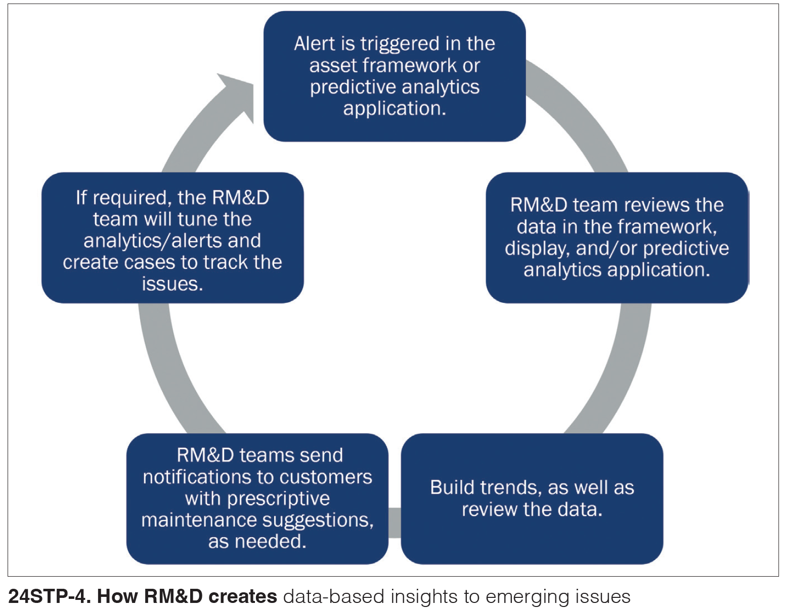

Predicting failures and minimizing downtime with remote M&D, Donovan Duncan, PROENERGY, and Steve Worthington, Arizona Public Service Co.
Duncan noted that the demand for dispatchable power generation continues to increase. Witness the record starts, stops, and overall usage of aeroderivative gas turbines nearly each quarter for the past three years. A result is an increase in equipment wear and tear.
This is important: The power market’s reliance on aeros means WTUI members cannot afford unplanned outages caused by being blind to actual equipment condition between inspections, the speaker said. That would force them operate reactively to alarms or failures.
Remote monitoring and diagnostics (RM&D)—proven outside of peaking applications—enables users to take a proactive approach, predict when problems are developing, and give operators the opportunity to mitigate those problems until a planned outage is possible (Fig 24STP-4). True predictive analytics have proved elusive to peaking facilities because of their very nature—including change operating profiles, run times, and varied stops and starts.
Duncan discussed the application of intelligent technology—such as predictive analysis, machine learning, and advanced pattern recognition—to discern the asset’s operating profile, subtle performance variations, and actual condition. The data result in accurate site-specific trend analysis, a failure-severity analysis, an estimated time to failure, and real-time performance deviations.

How NOx and CO/VOC control have changed in the post-2020 world, Andy Toback, Environex.
Emissions control technology has advanced considerably over the past several years to meet the power industry’s ever-evolving challenges. The need for operational flexibility and the advent of low-carbon fuels has created even more challenges for catalytic emissions-control systems already being pushed to their limits (Fig 24STP-5). Catalyst technology researchers and suppliers have stepped up with new formulations and designs to meet the industry’s latest demands.
Toback brought aero users up to speed on the new tools available to help them meet current and expected emissions-control challenges—including the following:
- High-temperature dual-function catalysts developed especially for use in simple-cycle peaking plants. Experience and data provided will help users decide if high-temperature dual-function catalysts are viable for their plants.
- Hydrogen fuel blending. Integrating hydrogen into the fuel mix may help to reduce carbon emissions, but CO₂ is not the only emissions consideration involved with using hydrogen. Be aware that the higher firing temperatures associated with burning hydrogen increase gas-turbine NOx emissions which, in turn, increase the NOx conversion requirements for SCR systems.
Toback discussed the impact hydrogen blending has on SCR/CO systems and the factors to consider when evaluating what changes may be needed to ensure reliable emissions performance with hydrogen use.
- Other catalyst technology developments—including low-DP designs along with their intended and unintended consequences, new catalyst formulations and designs, changes to the supplier landscape, etc.

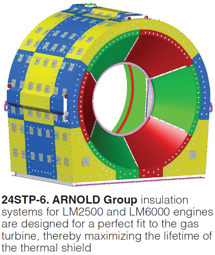

Optimized insulation for gas turbines, Pierre Ansmann, ARNOLD Group.
Ansmann began by pointing to the problems ARNOLD’s insulation systems avoid with the company’s highly engineered 3D-shaped blankets that fit perfectly to the shape of exhaust system components (Fig 24STP-6)—including the following:
- Interlocking steps between blankets, and use of stainless-steel coil and super-tight wire mesh to virtually eliminate vibration damage.
- Blanket damage requiring repair/replacement every outage.
- Surface hot spots conducive to insulation damage.
- Overheated noise enclosure.
- Loose fibers and dust that can cause health and safety issues.
Photos and drawings abound in this detailed presentation likely to answer any questions related to the design and effectiveness of the ARNOLD insulation system.

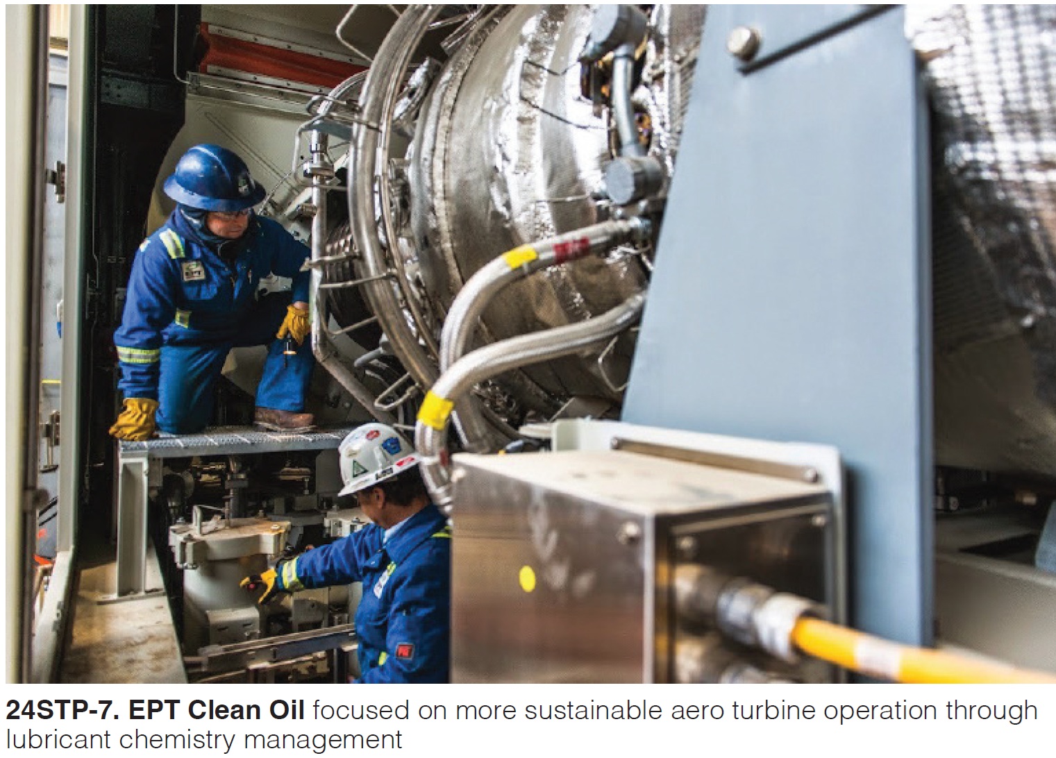

More sustainable aero-turbine operation through lubricant chemistry management, Dr Matthew Hobbs and Peter Dufresne, EPT Clean Oil.
While aeroderivative GTs (LM2500, LM6000, RB211/Siemens A35, and PW4000) are efficient, aero lubricant monitoring and maintenance practices lag behind those established for analogous industrial gas-turbine oils, according to the experts at EPT Clean Oil (Fig 24STP-7). Most jet oil programs neglect the application’s primary cause of failure: Inadequate management of the GT’s lifeblood—its oil. Because maintenance and sustainability go hand-in-hand, methods for better oil management can have a significant positive impact on aero engine operation.
Hobbs and Dufresne stressed that business as usual isn’t good enough and that owner/operators can close critical gaps in their lubricant chemistry programs to operate more reliably, profitably, and sustainably. Their recommendations:
- Run the tests presented in the slide deck and act on results.
- Apply your maintenance budget towards the causes of failures and address the root causes of oil and equipment failure
The speakers recommended that EPT Clean Oil’s oil conditioning skid (SVR-JET) is critical to successful lubricant chemistry management. It uses engineered ion-exchange media (ICB-JET) to remove varnish and acids and a dry nitrogen generator to manage water and oxygen content to prevent varnish and acids.

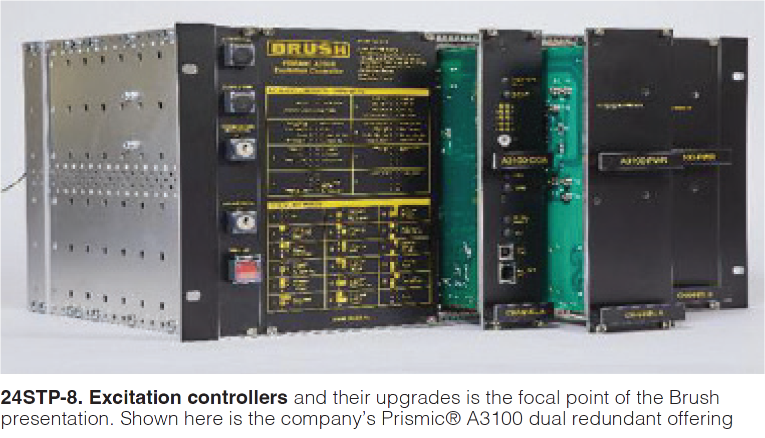

BRUSH® power generation: Solutions, Ian Golightly, Baker Hughes. Golightly’s presentation is all about helping you mitigate unscheduled generator outages with an excitation controller upgrade. As your generator’s excitation controller ages, he said, the need for maintenance increases, as does the chance of components becoming obsolete or unusable. Regular maintenance and repairs are important to ensure longevity and optimal operation. Another option is to replace your analog controller with a modern digital-based version. The focus of that recommendation is the Brush Prismic® A3100 excitation controller (Fig 24STP-8).
The senior controls engineer began with a look at today’s Brush, which is considerably different than the 1957 version of the company which traces its roots to the UK and Hawker Siddeley. The latest iteration is Brush Power Generation, purchased in 2022 by Baker Hughes as part of its vertical integration strategy. The highlights of Golightly’s presentation:
- Evolution of the excitation controller product.
- NERC compliance.
- Modern digital excitation controllers.
- Upgrade methodologies.
