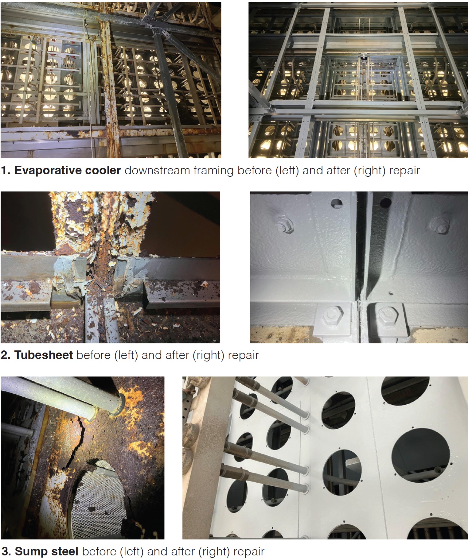

Also, remember that most turbine inlet systems are constructed using coated carbon steel. Over time, these components can degrade, leading to rust, chipping paint, and metal deterioration. And when such debris enters the clean air stream it can affect critical components within the turbine proper.
Corrosion in GT inlets is particularly common in humid climates. Systems with evaporative coolers or fogging systems introduce humidity, increasing the likelihood of corrosion—especially if coated surfaces are not properly maintained or if the conditioning equipment is not operated correctly. Exposure to corrosive cleaning agents can also damage coated surfaces and accelerate metal degradation. Once coating systems fail, the exposed steel surfaces become vulnerable, resulting in increased maintenance costs and reduced performance.
To mitigate these risks, the Dürr Universal team recommends the following best practices:
- Regular inspections and maintenance. Conduct annual inspections to identify coating failures early, preventing minor issues from escalating into major repairs. Early detection of rust, peeling paint, and/or structural weaknesses allows for timely intervention and cost saving.
- Proper surface preparation. Before applying new coatings, ensure surfaces are thoroughly prepared to maximize coating adhesion and longevity.
- High-performance coating systems. Use industry-approved multi-layer systems—such as zinc primers, epoxy intermediates, and polyurethane topcoats—for long-term durability and resistance to harsh environments.
- Filtration system maintenance. Effective inlet filtration prevents contaminants from entering the turbine, reducing the risk of corrosion and fouling. A well-maintained filtration system not only prolongs coating life but also minimizes recoverable and non-recoverable degradation.
Investing in preventive maintenance and proper coating systems significantly reduces long-term expenses. Recoating a surface is far more economical than replacing steel structures compromised by extensive corrosion. Additionally, well-maintained coatings help improve efficiency, reduce downtime, and extend the lifespan of gas-turbine components.
