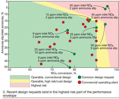

Equally important to the SCR design is the impact from the ammonia-slip limit. A Frame 7F turbine with dry-low-NOx technology and a turbine-exit NOx level of 9 ppmvdc can rather easily meet a 2-ppm NOx/2-ppm ammonia-slip limit with 78% NOx removal and allowance for 22% excess ammonia (2-ppm stack/9-ppm inlet = 22%). When the turbine-exit NOx increases to 30 ppm, a 2-ppm NOx/2-ppm ammonia-slip limit requires 93% NOx removal with only 7% excess ammonia.
The success of the SCR design is critically dependent on the amount of excess ammonia that can be injected. Systems should be designed for greater excess ammonia at higher NOx removal requirements, Ott said, but the regulations currently do not allow this.
Fig 2 compares designs with different NOx-removal and excess-ammonia allowances, taking into account the complexity and operability of the designs. Note that most of the newest, higher-efficiency designs are in the “highest risk” zone where the risk of failure on commissioning is high and maintenance (catalyst replacement, catalyst cleaning, and ammonia tuning) is frequent and costly.

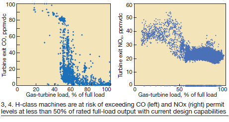

All turbines, including the newest designs, are now required operate at low and variable loads to respond to dynamic grid demands. This is in due in part to the growing impact of renewable power. Output down to 20% load is not uncommon.
Figs 3 and 4 show real-time operating data for NOx and CO emissions versus load for an advanced-class turbine. Most low-NOx/low-CO combustor technology is designed to function within guaranteed limits for NOx and CO above 50% load. Below that, NOx and CO increase rapidly because of suboptimal fuel/air mixing. These spikes in emissions at low load require the SCR and CO catalyst systems to achieve emissions reductions as high as 98%, far exceeding the capability of most designs.
