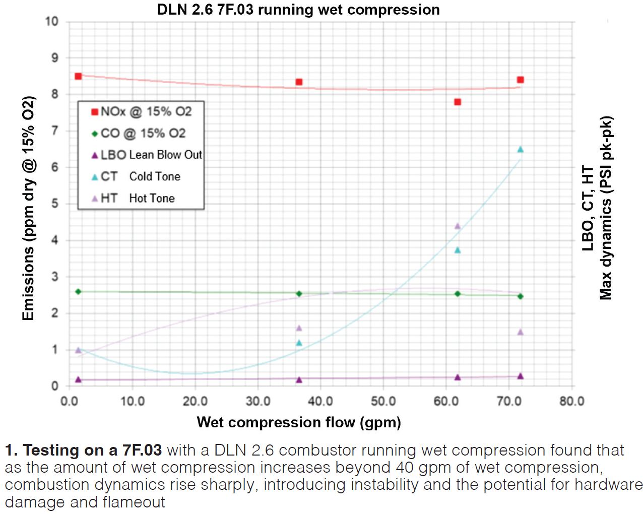

The limiting issue on a 7F.03 is not whether wet compression works. It is whether the DLN 2.6 combustor can tolerate the cooler compressor discharge temperatures that come with higher water flow. According to Mee Industries, combustion dynamics on that combustor become more sensitive as wet compression reduces compressor discharge temperature. Those dynamics arise from the interaction of fuel-air mixing, heat release, and acoustic pressure waves in the combustion system. Left unchecked, they can drive instability, hardware damage, flame blowout, and emissions spikes (Fig 1).
Mee Industries’ practical limit on a 7F.03 with DLN 2.6 typically is 1% wet compression unless the plant has either an SCR or an emissions permit that allows higher NOx. The reason is simple. More water lowers firing temperature. To break through the resulting dynamics zone, operators may have to raise firing temperature again, and that can push NOx above the permit limit. Mee Industries notes that other OEM DLN systems generally can operate at higher flows, and on other OEM gas turbines the company has successfully run wet compression levels of 2%.

For operators, the real story is how the package changes the tuning window on a 7F.03. Mee Industries cited a case with no SCR and a 9-ppm hourly average NOx limit. In that configuration, 1% wet compression lowers compressor discharge temperature by about 100F. Beyond that point, combustion dynamics become unacceptable. The DLN 2.6 combustor cannot tune them out, and restoring firing temperature enough to clear the dynamics zone pushes NOx above the permit limit. Result: wet compression is capped at 1%, even though that still adds about 10 MW.
A nearly identical 7F.03 with no SCR but a 15-ppm hourly NOx limit had more room to maneuver. When dynamics appeared at 1% wet compression mass flow, operators could raise firing temperature back to 2420F, break through the dynamics zone, and move to 2% wet compression. That unit gained 16 MW. Same machine class, same basic wet-compression concept, different answer because the combustion system and permit envelope set the boundary conditions.

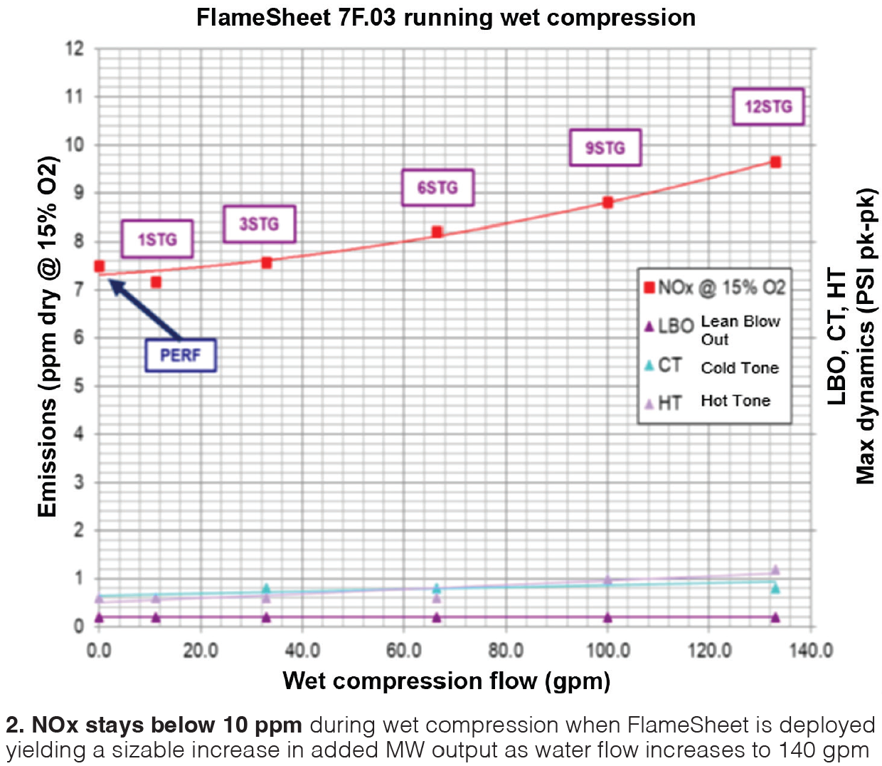

Hanwha Power argues FlameSheet changes that equation. Testing on a 7F.03 with DLN 2.6 showed combustion dynamics rising sharply once wet-compression flow exceeded 40 gpm on the OEM combustor. With FlameSheet in place, Hanwha Power says water flow can be pushed to 140 gpm while keeping NOx below 10 ppm (Fig 2). The company attributes that to multiple fuel-injection stages inside the combustor and to the AutoTune system, which shifts fuel distribution among stages to hold dynamics at acceptable levels.
The commercial effect can be material, particularly for plants in capacity markets. On a 7F.03 with the OEM combustor, Hanwha Power says 1% wet compression is about the practical ceiling if the goal is to avoid a NOx increase and damaging instability. That still can yield roughly 12 MW. With FlameSheet, the same machine can reach 2% wet compression, keep emissions below 10 ppm, and add about 22 MW. For a plant selling dependable capacity into PJM or a similar market, that difference is not academic.
