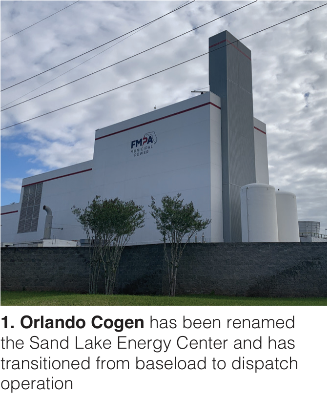

Take the case of the Sand Lake Energy Center (SLEC) in Orlando, Florida. Built in 1993 and originally a cogeneration plant, its new owner Florida Municipal Power Agency (FMPA) is investing in the facility with the view to achieving another two decades of service.
“We have switched from running 8,000 hours per year to where we will now have fewer hours but more starts,” said Danny Slade, Maintenance Manager, Sand Lake Energy Center. “We are engaged in several improvement projects including gas turbine hot gas path (HGP) upgrades, improved grid connectivity, and perhaps the installation of duct burners.”

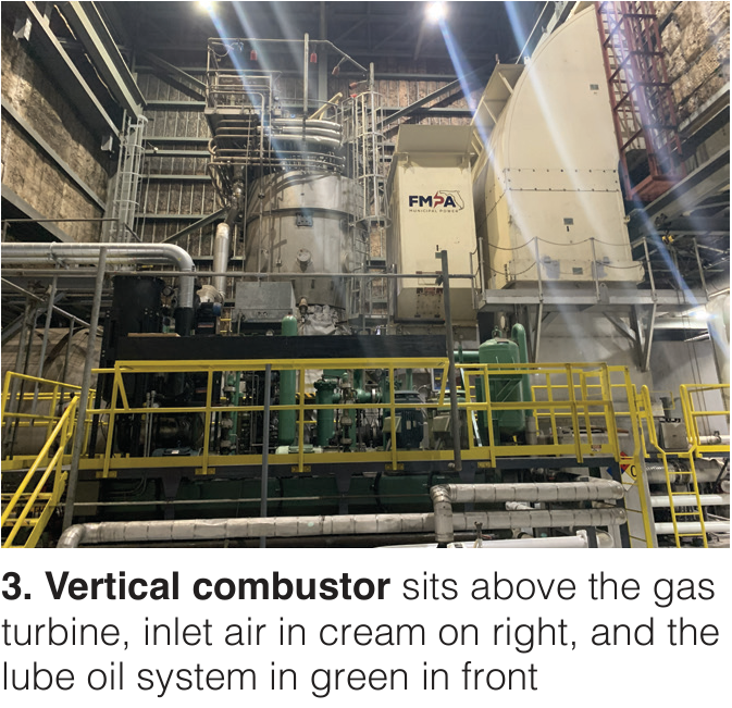

SLEC comprises an ABB 11N1 gas turbine (later Alstom and then GE) configured in a single-shaft arrangement with an ABB VAX steam turbine and a water cooled 144 Brush MVA generator. The combined cycle unit is rated 125 MW at 22°C and 60% relative humidity. Power sales contracts with Florida utilities covered 114.5 MW of base-load output, and deliveries of extra power at peak times as available. The original cogeneration plant supplied 15 t/h of steam at 1.4 bar to an absorption chiller located onsite to chill cooling water for Air Products.
The 11N1 heavy-duty gas turbine was introduced in the early 1990s, specifically designed for high-efficiency, reliable peaking power, and cogeneration applications. It featured a silo combustor, corrosion-resistant blades, and a water-cooled, cold-end generator drive. It uses a single large silo-type combustion chamber located on top of the machine known for fuel flexibility. OCL was one of the first installations in the world of this turbine.

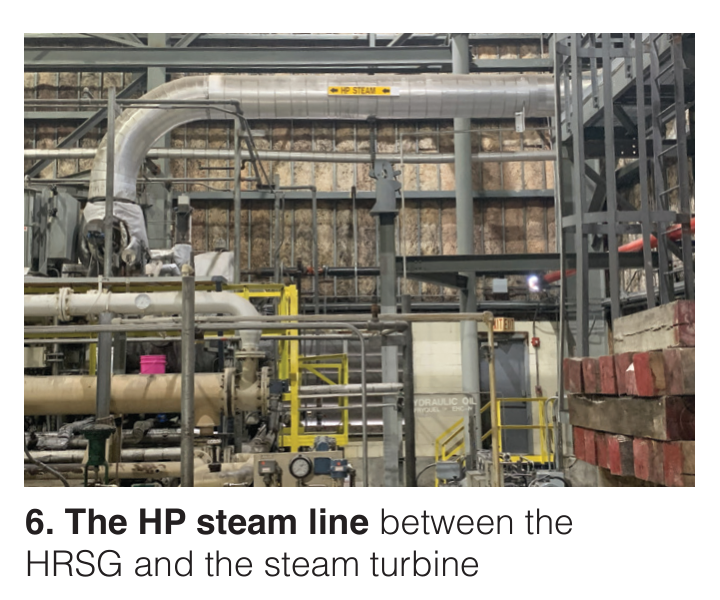

The ABB HRSG is a dual-pressure unit with finned tube construction throughout. Its design allowed for future installation of an SCR in the event emissions limits were lowered. However, no SCR was ever installed or required.

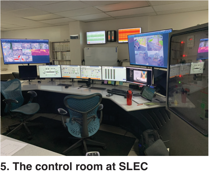

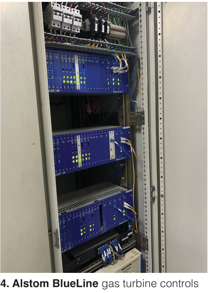

The original plant control system hardware in 1993 was provided by ABB, a Taylor MOD 300 microprocessor-based distributed control system (DCS). The gas turbine control system was ABB’s Egatrol 300 which communicated directly with the DCS. A full controls upgrade to Alstom BlueLine technology in 2012 included new gas turbine controls, balance of plant (BOP) BlueLine controls in 2014, and steam turbine BlueLine controls in 2017.

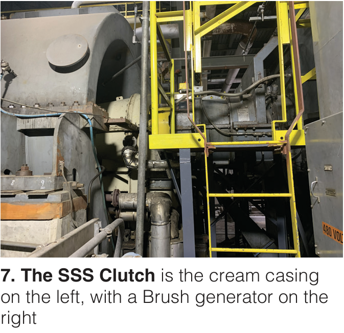

“Although Orlando Cogen was not the first single shaft combined cycle plant with an SSS clutch in the USA, it was the first large plant over 100 MW,” said Dave Haldeman of SSS Clutch. “Since then, there have been many more installations, some up to 400 MW.”
The clutch operates between the exciter end of the generator and the LP section of the steam turbine. It enables the gas turbine to start independently of the steam turbine. It can accommodate large axial movements if necessary. It features high overspeed and overload capacity.
“Air Products specified that a disconnect clutch be included to decouple the steam turbine operation from that of the gas turbine,” said Slade. “With the clutch, a steam turbine trip does not necessitate a gas turbine trip, and the gas turbine can rapidly provide power while the steam turbine is being readied for operation.

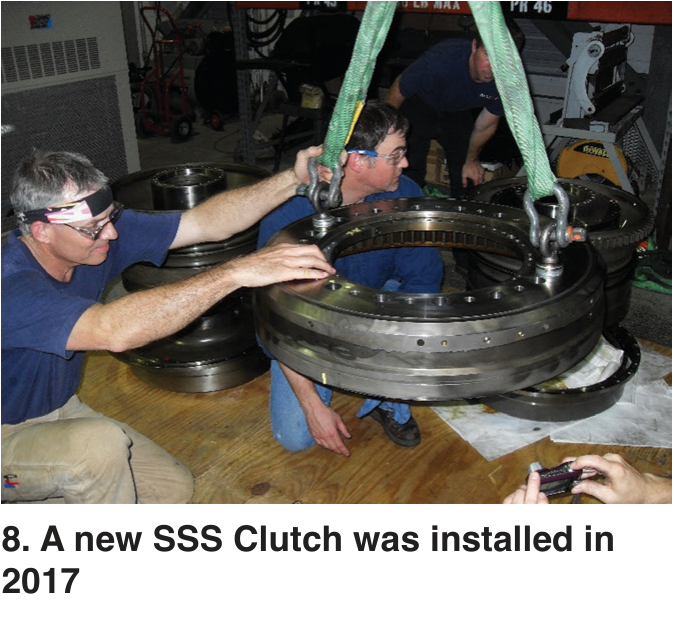

The next major event took place in 2011 when a hard engagement of the clutch took place.
“During a plant restart after a scheduled outage, an unusual steam turbine trip subjected the clutch to an unusually high relative acceleration rate at engagement,” said Haldeman. “The results were damaged pawls that prevented the relay clutch from engaging.”
Slade contacted SSS Clutch who flew immediately to the site. Together with OCL crew, they repaired the clutch and got it back into service. Utilizing parts from a relay clutch component, the damaged unit was rebuilt on site. That “temporary” clutch remained in service until 2017. OCL decided to replace it as a precaution.
“That hastily repaired clutch from 2011 ran for six more years before we replaced it,” said Slade. “When it was shipped back to SSS Clutch, inspection revealed it to still be working perfectly.”
Many use a clutch to switch from power generation mode to providing ancillary services such as spinning reserve or synchronous condensing. This is not the case at SLEC. Its purpose is to enable a faster start up. Without the clutch, it would take 45 minutes or more for the plant to produce power. By disconnecting the steam turbine, the gas turbine can be started independently to provide 10 MW within 20 minutes. The GTs power output steadily ramps up from that point and the steam is gotten to the right heat and pressure to run the steam turbine.
“We can do a hot restart to full power in 45 minutes thanks to the clutch,” said Slade. “Otherwise, it would take us about three hours from a cold start to achieve full load.”

Florida Municipal Power Agency took over OCL in 2024, signaling the end of the plant’s cogen and baseload era. FMPA is a wholesale power agency owned by 33 municipal electric utilities throughout Florida. It operates a pool of generation resources stretching from Chattahoochee and Bloutstown on the Florida panhandle to Homestead to the south of Miani. Its goal is to provide low-cost, reliable power to more than three million Florida residents.
FMPA announced the purchase of OCL and two other central Florida power plants in summer of 2023. The Mulberry Energy Center (formerly Mulberry Cogeneration Facility) will supply 115 MW and the Bartow Energy Center (formerly known as Orange Cogeneration), will supply 104 MW.
“With this acquisition, we had an opportunity to secure three highly functioning Florida-based power plants for our generation fleet at a time when electricity demand began rising faster than expected with continued population growth and manufacturing resurgence,” said Jacob Williams, FMPA general manager and CEO.
FMPA took over OCL in 2024, renamed it Sand Lake Energy Center and placed it into its power pool. During most of its life, the facility has been in long-term power purchase contracts, the most recent of which ended in December 2023. FMPA immediately shifted its mode of operation to standby dispatch. That led to the removal of the chiller system. FMPA then looked at what was needed to ensure reliable operation into the future. It engaged ICT Industrial to replace the aging cooling towers in 2025 with a four-cell cooling tower replaced with a fiber reinforced polymer design. ICT completed one cell initially and then added the other three cells at the end of 2025.

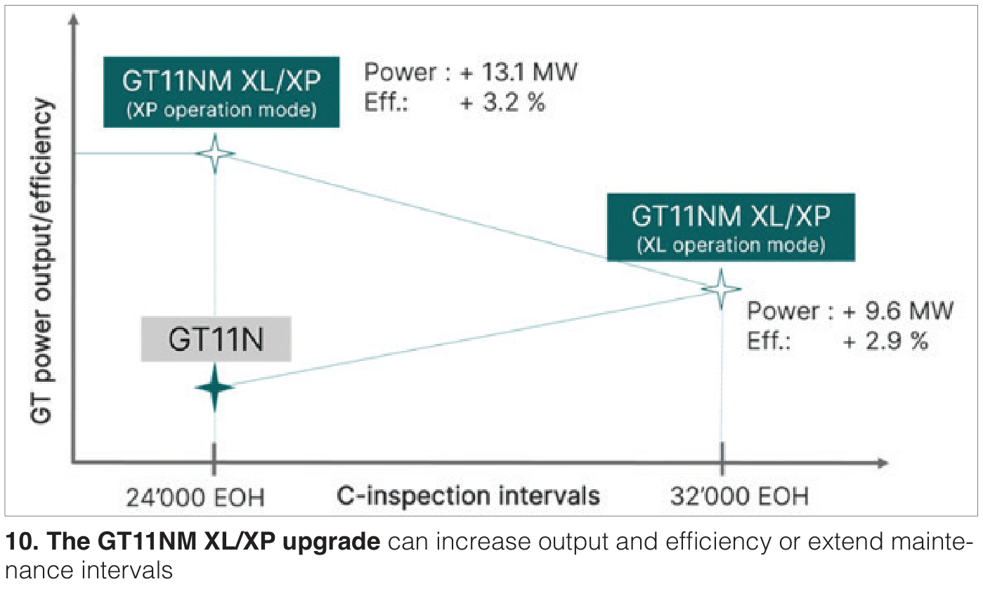

FMPA is in the process of upgrading the 11NM gas turbine. The GT11NM XL/XP upgrade takes major inspection intervals from 24,000 to 32,000 EOH in the XL operation mode, improves output by 9.6 MW and efficiency by 2.9%. Alternatively, the XP operation mode keeps the maintenance internal at 24,000 EOH but boosts output by 13.1 MW and efficiency by 3.2%.
This XLXP package entails new hardware on row 4 of the compressor, cooling improvements, and upgraded controls. Hughes Technical Services will be installing the upgrade package during the next major scheduled outage.
“We have switched from running 8,000 hours per year to where we will now have fewer hours but more starts,” said Slade. “The XL/XP upgrade and the addition of duct burners will enable us to provide far more MW whenever we are called upon to operate.”
