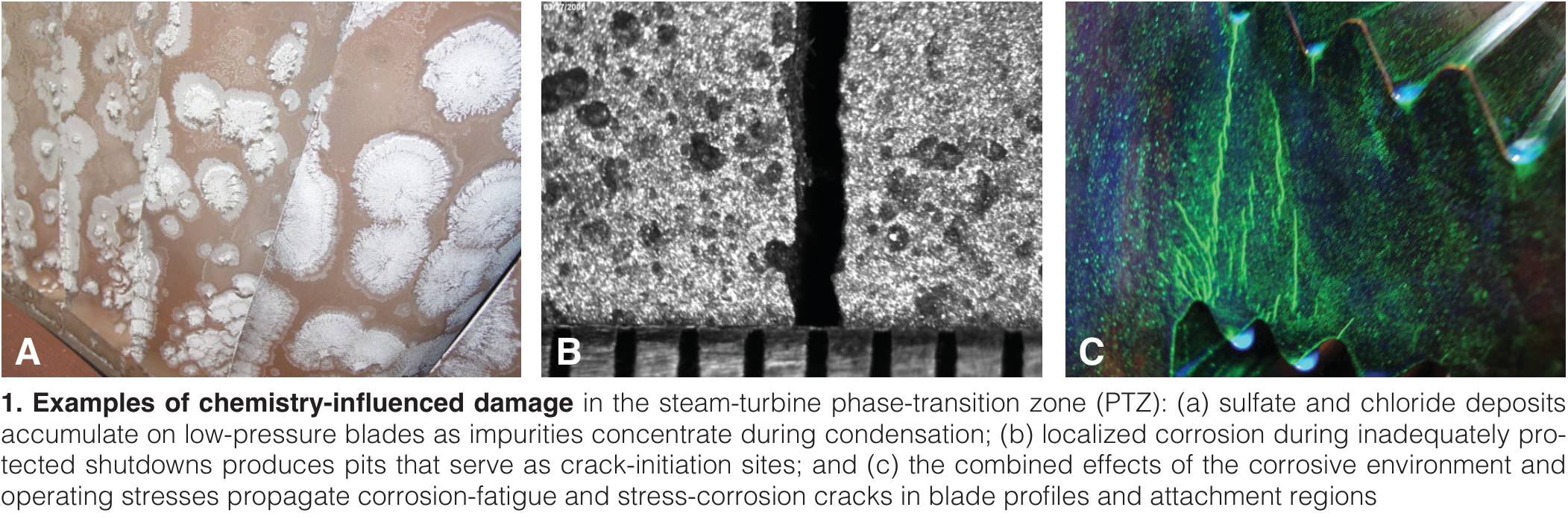

Dooley began with the damage mechanisms most strongly influenced by cycle chemistry. For the PTZ, the leading concerns are corrosion fatigue of blades and discs in the low-pressure section and stress-corrosion cracking of discs in the same region. Deposition and pitting are part of that story, not side issues. In Dooley’s experience, pitting is where these failures start.
He showed failure examples from L-1 and L-0 rows, attachment areas, and blade profiles. The message was not subtle. Cracks may present differently, but the initiating condition is the same. Deposits form, shutdown protection is absent or inadequate, oxygenated moisture develops on the surface, pits form, and those pits can transition to microcracks and then to full damage mechanisms under operating stress.

The sequence starts with impurities entering the steam from volatility, partitioning, carryover, or attemperation. Once the PTZ forms, droplets and films concentrate those impurities on blade and disc surfaces. Deposits accumulate. During shutdown, if the turbine is not protected with dehumidified air or another effective method, those deposits can become moist and oxygenated. That sets up passivity breakdown and pitting.
Dooley distinguished between metastable and stable pits. The former may form and die. The latter survive and grow. Repetitive non-protected shutdowns are what allow pits to reach critical size. Once large enough, they can nucleate microcracks. If the area also contains an electrolyte film during operation, the microcrack can transition into corrosion fatigue or stress-corrosion cracking.
One reason plants are caught off guard is that the initiation stage can last a long time and be hard to detect. Dooley said many investigations begin with a familiar complaint from the owner: the unit had an NDE exam or inspection only months earlier and nothing alarming was reported. Early pit growth and microcrack initiation can escape routine inspection. A clean report is not proof that the mechanism is absent.
