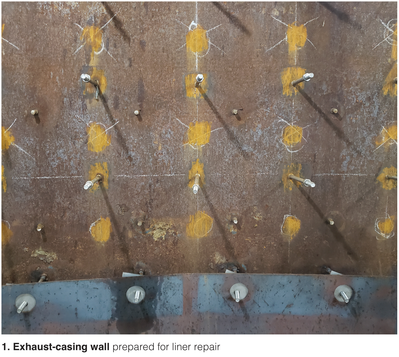

Schreeg points first to stud welding. Attachment quality, he argues, is one of the most important variables in liner life. Poor weld penetration, bad field procedures, and cold welds all show up later as broken support points. Once studs begin failing, liner sheets lose restraint and become more vulnerable to vibration, movement, and distortion under exhaust flow. Retrofit work can be especially tricky because crews are working with existing surfaces, field conditions, and material variations that complicate installation quality (Fig 1).

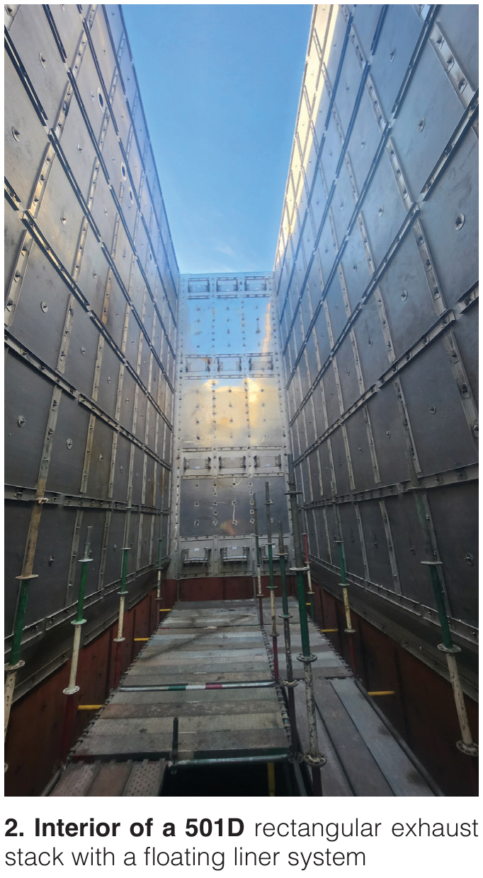

Other repeat offenders are design-related. Excessive stud spacing, especially near turbine outlets and diffuser sections where turbulence is high, reduces rigidity and invites liner movement during thermal cycling. Lack of edge stiffening does the same thing at the seams. Batten channels or similar reinforcement methods are often needed to keep edges flat and maintain overlap (Fig 2). Sheet size matters too. Larger sheets carry greater thermal-growth forces and are more likely to distort or buckle in a floating design. Then there is lapping direction. If sheets are installed so the flow sees an exposed edge instead of a protected overlap, exhaust gas can begin lifting the liner during operation. Once flow intrusion starts behind the sheets, failure tends to accelerate rather than stabilize.

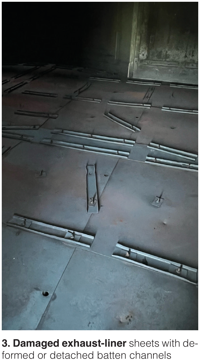

The practical inspection picture is familiar to outage teams: broken studs, missing hardware, displaced insulation, visible fiber debris, distorted sheets, lifted corners, thermal stress near joints and transitions, and areas where hot gas appears to have been running behind the liner (Fig 3). The trouble is that by the time several of those signs are obvious, the job may already have moved well beyond a localized repair. A small corrective scope taken during a planned outage is one thing. A large casing repair or an unplanned outage during a tight operating period is something else entirely.
