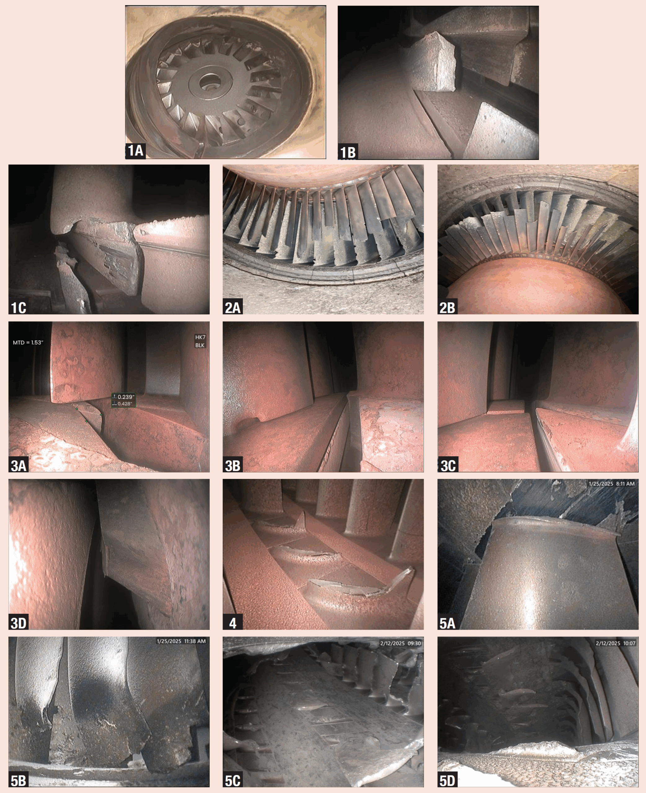

Unusual significant findings
Advanced Turbine Support’s Mike Hoogsteden, director of field services, shared some examples of what he considers “unusual significant findings” identified during recent borescope inspections of GE gas-turbine Frames 5, 6B, 7EA, and 7FA running harder and cycling more frequently because of changes in power-market dynamics.
1. Separated fuel nozzle in 7EA photo A is something that had not been seen previously by an Advanced Turbine Support inspector. Photos 7EA B and C show disengaged and protruding S2 knife seals contacting S2B. In B, the seal is behind the trailing edge of the second-stage; in C, the seal and bucket are in contact
2. Damage here resulted from the failure of a 7FA third-stage bucket. The fix was believed to require a hot-gas-path inspection at a minimum
3. Series of photos shows R17 migration in a 7FA
4. There were seven S17 liberations in this Frame 6B
5. Rotor dropped in this Frame 5 causing extensive compressor damage. A bearing failure was the assumed cause early in the investigation. Photos 5C and 5D, show the large number of seventh-stage stator vanes and rotor blades, respectively, lost in the accident
