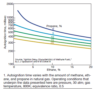

Autoignition. Hydrogen and higher hydrocarbons also significantly decrease autoignition temperature and times, leading to increased autoignition risks. While symptomatically similar to flashback, the physics of autoignition is different. In this case, if the autoignition time of the fuel mixture falls below its residence time in the premixing tubes, the fuel mixture may spontaneously ignite in the premixing zone.
Similar to flashback, autoignition can damage premixing passages, swirlers, and fuel lances. As with any of these other operability issues, liberation of any of these parts poses a threat to the power turbine. Fig 1 shows the how quickly autoignition times decrease with increasing amounts of ethane and propane in natural-gas fuel.
Takeaway 4: Higher hydrocarbons (especially when coupled with the higher compressor discharge temperatures of aeroderivatives) pose the greatest autoignition risk.

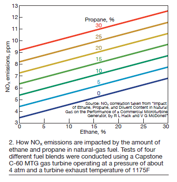

Nitrogen oxides. There are two main NOx formation pathways:
- NOx produced in the flame, which generally is a few ppm and heavily influenced by fuel composition.
- NOx produced post-flame, which really only depends on flame temperature.
Thus fuel composition influences on NOx emissions are somewhat dependent on the nominal NOx emissions of the gas turbine. Assuming the firing temperature stays fixed as fuel composition varies, for units with relatively high NOx emissions (nominally 15 ppm and higher), NOx production is dictated mostly by the firing temperature and is largely insensitive to fuel composition.
On the other hand, units that have fairly low NOx emissions (less than 5 ppm) will see a significant effect from changes in fuel composition. Data suggest that NOx concentrations may even double with changes in fuel composition for such low-NOx systems. Fig 2 shows how much NOx production can increase, in the low-NOx case, with increasing amounts of ethane and propane in natural gas.
Takeaway 5: The lower a gas turbine’s NOx emissions, the greater the impact of fuel composition on those emissions.
