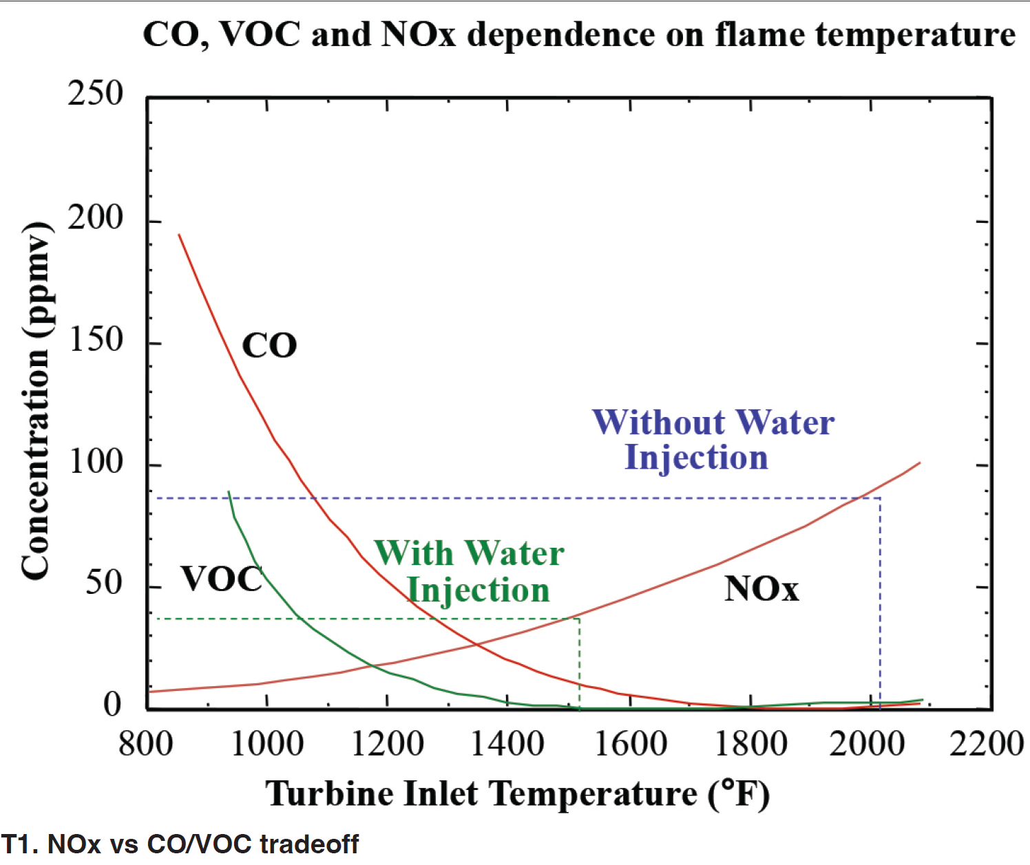

He then offered a look (Fig T1) at what he called a “NOx vs CO/VOC tradeoff” explaining how CO, VOCs and NOx are dependent on flame temperature. As he explained, CO and NOx work against each other.

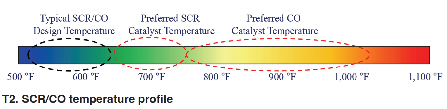

This led to a chemistry review, and an interesting temperature chart depicting the fundamentals (Fig T2).

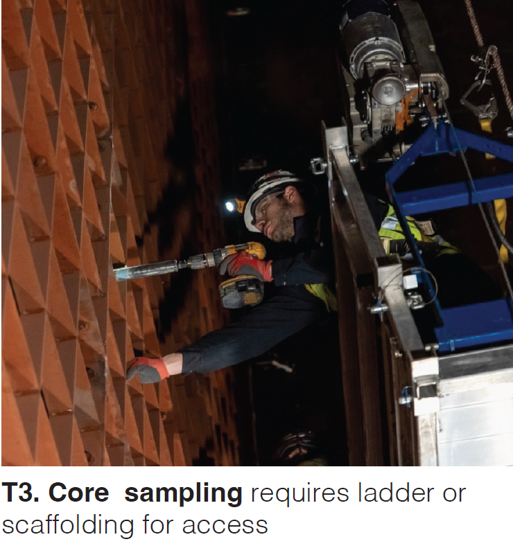

Catalyst core sampling has both pros and cons:
  • Pros:
    • Can be taken directly from bulk catalyst.
    • Multiple sample locations possible.
    • Works with any honeycomb catalyst.
  • Cons:
    • May not follow vendor’s guidelines.
    • Ladder or scaffolding required (Fig T3).
He stressed the benefits of multiple sample testing.

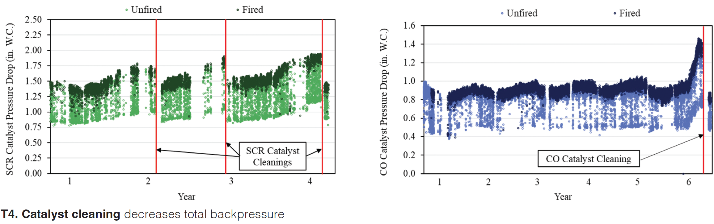

This ended with a discussion on SCR catalyst cleaning to reduce backpressure and increase system efficiency.
The bottom line: Catalyst cleaning lowers pressure drop and increases fuel economy (Fig T4).
“Every inch of backpressure is megawatts you are losing,” he stated. A secondary benefit of clean catalysts, he added, is reduced tube cleaning.
