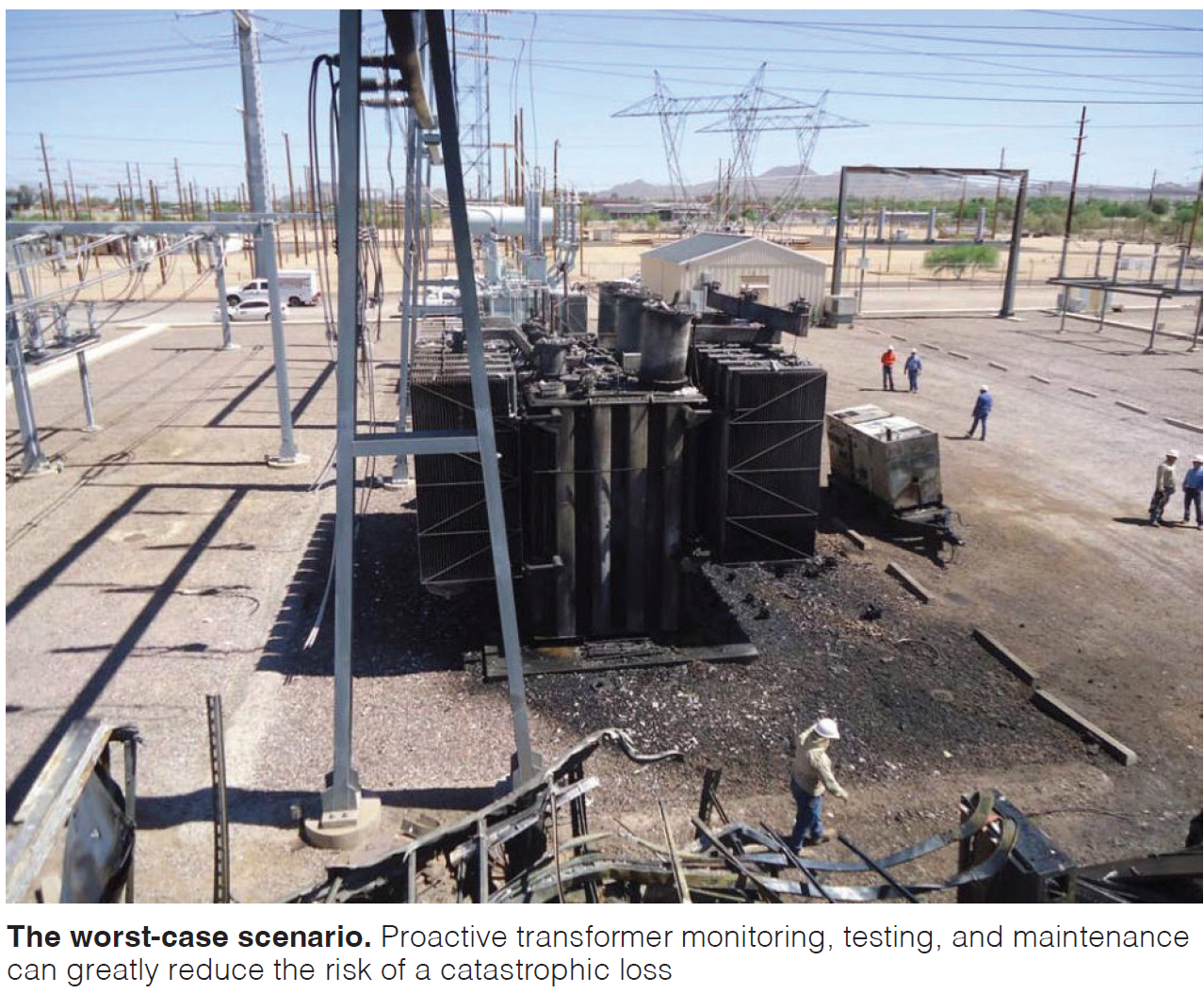

- Bushings, both transformer and breaker types, degrade from internal cracking, moisture ingress, or surface contamination. Early symptoms include subtle partial discharge, localized heating, or tracking visible under wet conditions. Because the damage is internal, the exterior often appears normal. Escalation can be rapid once underway.

For transformers: record winding and oil temperatures against historical maximums, check bushing oil levels, look for tracking or contamination on bushings, inspect desiccant breathers.
