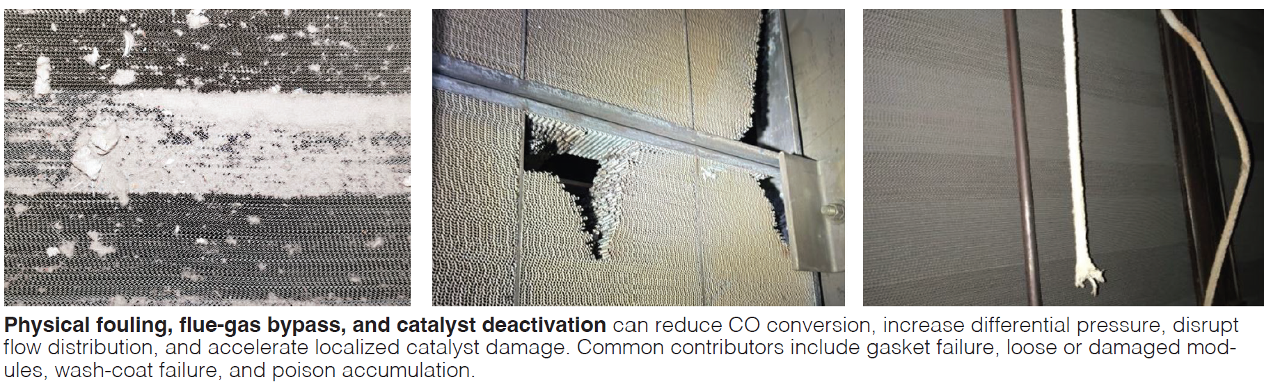

That does not mean every weak catalyst should be washed. The first technical point in the webinar was that poor CO performance often starts with conditions outside the catalyst chemistry itself. Sobotik pointed to physical fouling, bypass, and deactivation as the three main buckets operators should separate. Fouling raises differential pressure and blocks exposed surface area, reducing the number of active sites available to oxidize CO. It also can drive erosion when insulation particles or boiler rust lodge in the passages and abrade the washcoat. Bypass tells a different story. Bad gasketing, damaged seals, loose modules, or holes in the catalyst can let gas take the path of least resistance, producing poor conversion without the same DP signature. Deactivation, by contrast, is a chemistry problem and is where the rejuvenation discussion begins.
Toback explained the mechanism in simple terms. A CO catalyst works by oxidizing CO and unburned hydrocarbons to carbon dioxide and water on a thin washcoat applied to metal or ceramic foil. Most of the action happens in that porous coating, not in the substrate. If the pores are blocked by deposits, performance falls because mass transfer is restricted. If platinum active sites are contaminated by sulfur, zinc, or phosphorus, performance can fall for a different reason. The shape of the catalyst light-off curve can help distinguish the two. A generally depressed conversion curve may indicate fouling or removable contamination, while a shifted curve can suggest more permanent poisoning or aging. That distinction matters because wash viability depends on what is actually sitting on the catalyst surface.
