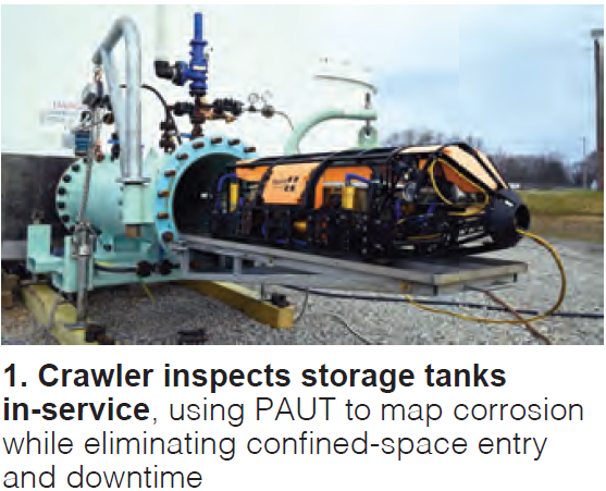

End users have long treated API 653 tank inspections as necessary pain from challenges associated with fuel handling, confined-space entry, outage coordination, and weeks of operational uncertainty. A recent Electric Power Research Institute (EPRI) Incubatenergy Labs demonstration with Tennessee Valley Authority (TVA) shows there’s a safer, faster path: submersible, autonomous robots that perform phased-array UT while tanks stay online.
The system, developed by Square Robot (Westborough, Mass), was deployed on four TVA tanks across two sites to test coverage, data quality, and real-world logistics against traditional out-of-service (OOS) methods.

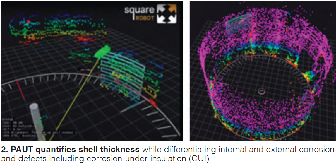

  • Eliminate OOS disruptions. Robots inspect from inside the product, avoiding drain/clean/vent cycles that drive outage days and safety exposure. The platform uses proprietary navigation plus 256-element PAUT to image bottom plates, size corrosion on product and soil sides, measure coatings/linings, and track settlement patterns—with location accuracy to roughly six inches.
  • Shift inspections from “project” to “activity.” Keeping tanks in service simplifies staffing, trucking, and back-up fuel planning, while preserving plant flexibility during peak or contingency periods.

At TVA’s Marshall Combustion Turbine site, three identical 62-ft tanks (~1,000,000 gal each) were inspected robotically in 3.5 days total—versus weeks to a month per tank for OOS. Coverage averaged ~60% of the bottoms, with ~100 GB of PAUT data per tank; by comparison, the previous OOS effort collected 28 single-point UT readings across a bottom, orders of magnitude less information.

  • Data density. Moving from “dozens of spot UTs” to hundreds of gigabytes of PAUT creates richer corrosion mapping and settlement insights, useful for RBI models and capital planning.
