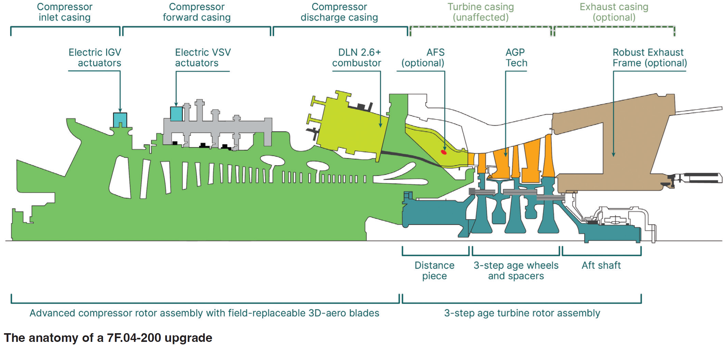

7F upgrades sales leader Robert Campbell and 7F product manager Jason Shaffer described the 7F.04-200 upgrade as a coordinated set of advancements across the compressor, combustion, and turbine sections. These upgrades extract more output, reduce heat rate, and expand turndown without changing the basic machine footprint. The scope also modernizes actuation and controls, enhancing part-load flexibility and simplifying maintenance. Access “7F.04-200” to watch the presentation and Q&A session.
The compressor upgrade introduces a new 14-stage configuration with redesigned inlet and casing, and field-replaceable blades. GE Vernova reports up to about 16% additional hot-day output and a ~3% heat-rate improvement. Electric variable-guide-vane actuation replaces hydraulics, enhancing reliability and reducing maintenance.
In the combustor, the DLN 2.6+ system with updated fuel nozzles and liners maintains 9/9 ppm NOx/CO compliance while extending turndown to roughly 25% of baseload with Axial Fuel Staging. The upgrade replaces legacy hydraulic valves with electric gas control valves, reducing leak points and enhancing response.
The AGP hot-gas-path kit brings advanced-material buckets, nozzles, and shrouds that raise gas turbine output by as much as 12% and enhance cooling effectiveness. A more robust rotor material further strengthens the platform for higher output and longer life.
Controls are modernized to Mark VIe with integrated BOP signaling and diagnostic capability. Across the fleet, GE Vernova cites gains of about 46 MW on hot days and 32 MW on cold days from a 7F.03 baseline.
