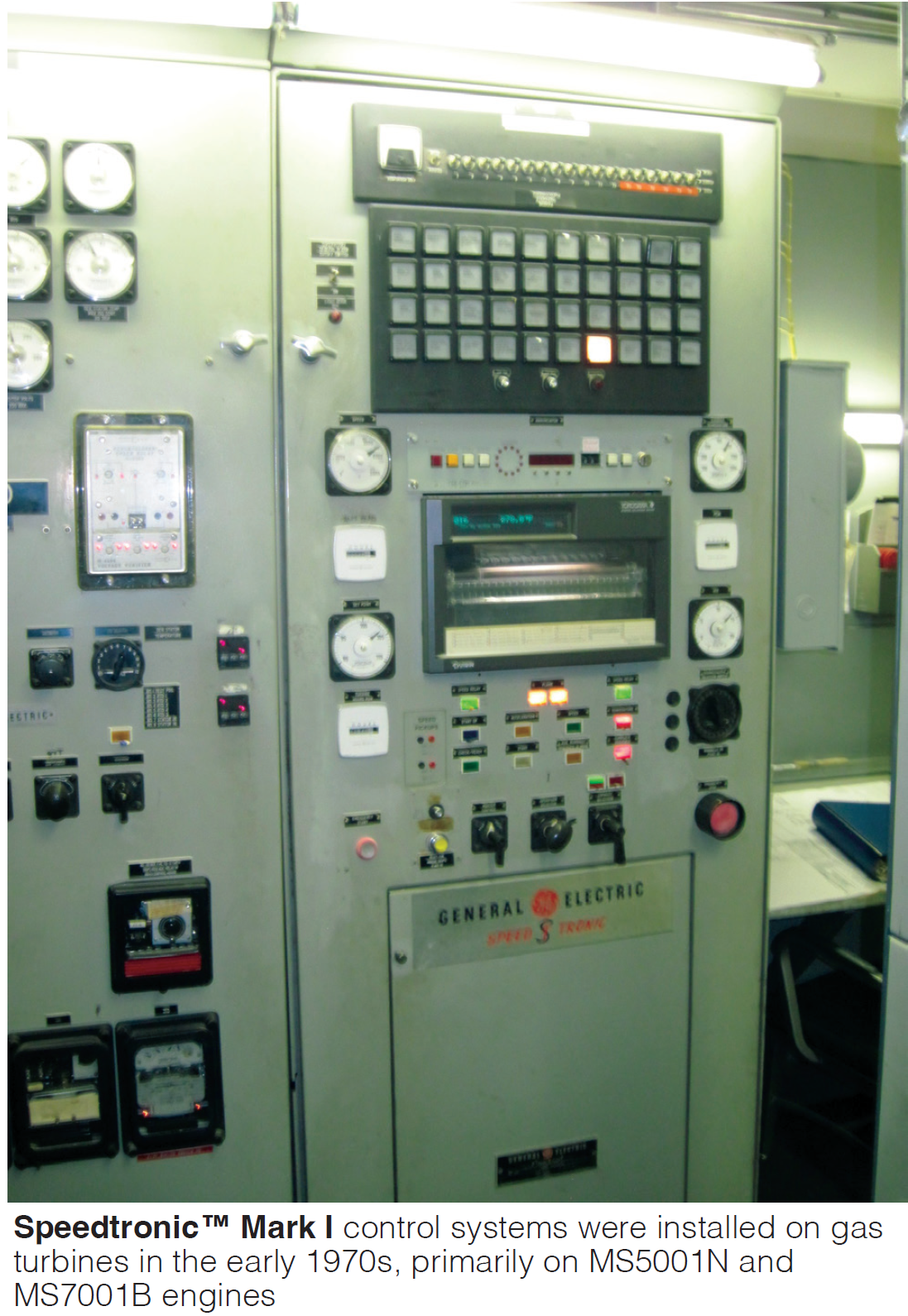

An MS7001B engine with Mark I Speedtronic™ controls failed to start reliably for about a year. Failure-to-start causes included loss of flame, trip at Complete Sequence to full-speed/no-load (FSNL), trip on 95% speed (14HS), TNH (high-pressure shaft speed) bog-down, and unknown. The troubleshooting effort was complicated by inconsistency in the different results recorded between starts. Because of the inconsistency of results on each start, the troubleshooting effort was directed at turbine hardware, the Mark I controls, and control wiring.

The majority of trips occurred at 95% speed; 14HS and 3 Complete Sequence trips were identified as the consistent problem. Flameout on unit deceleration had not caused a recent trip. Troubleshooting focused on the 14HS relays and wiring. There are eight 14HS relays and four 3 relays.
