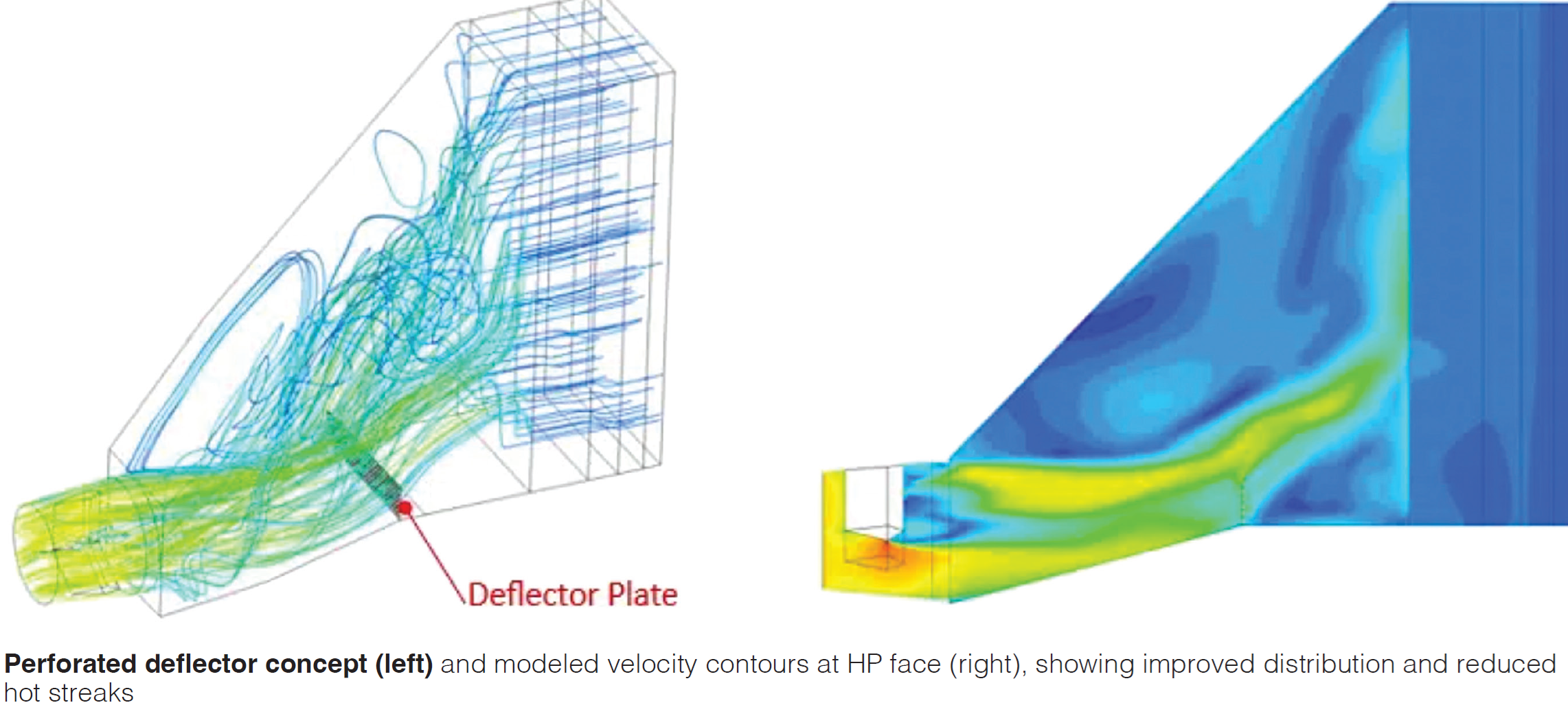

SVI Bremco then evaluated the following options for deflectors and perforated plates, hardware easier to fabricate, install, and service than multi-piece vane weldments:
  • A 36-in deflector with 4-in holes (~15.7% open area) and a serrated top edge improved uniformity to ~29.9%, though there was a predictable wake right behind the plate
  • Increasing height to 48 in and open area to ~37% (larger perforations) lifted uniformity to ~30.8%. The serrations helped break up large flow structures, smoothing gradients
Bottom line: a perforated, serrated deflector reliably pushes flow toward under-served regions and tames extremes without the complexity of vanes.
Alternative concept: partial distribution grid
A tall, perforated grid (~114 in) performed best in modeling, ~45.7% in-band with acceptable modeled loss, but site realities dominated: higher loads, tougher installation, and maintenance safety concerns. The incremental uniformity did not outweigh those risks.
Recommended implementation and practical notes
The preferred solution is a 48-in-tall, perforated deflector (about 37% open area) with a serrated top edge. Depending on fabrication preferences, 4-6-in holes will typically hit the open-area target while keeping plate stiffness reasonable. This choice balances better distribution, simpler structure, easier access, and safer maintenance (Figure). While the uniformity does not reach textbook best-practice ranges, it replaces a failure-prone vane set with rugged, serviceable hardware and reduces thermal-mechanical risk at acceptable cost and complexity.
