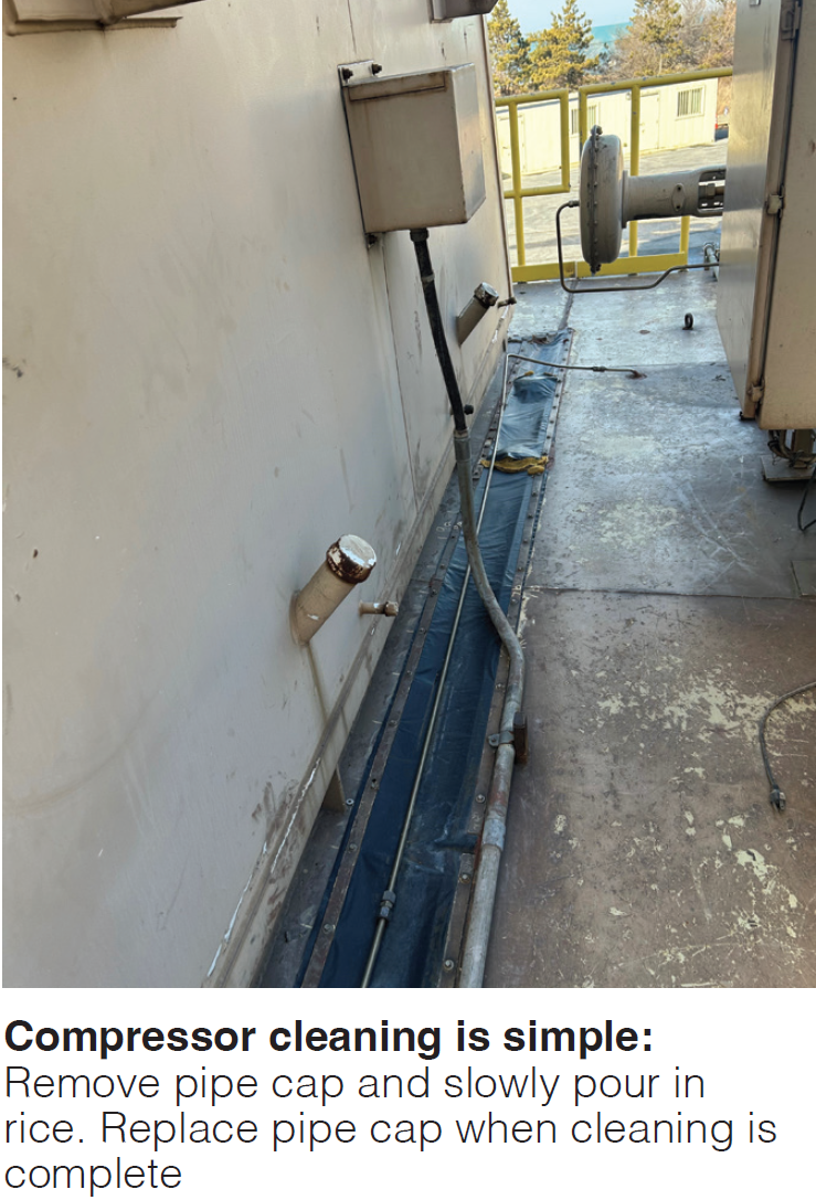

The standard in Schenectady was 9 lb of Uncle Ben’s rice poured slowly into the fitting provided in the inlet transition piece (photo). Interestingly, the current transition-piece design still includes this port on the turbine side of the transition. The fitting is a 6-in. capped pipe installed at a 45-deg angle.
To clean the compressor with the organic compound, the following procedure is recommended:
- Reduce load to about 50%. For DLN units, reduce load to at least Lean-Lean.
- Using the turbine control instrumentation, observe exhaust temperature.
- Remove the cap from the fitting on the transition piece and slowly add the rice. The pressure inside the inlet will make sure most of the rice goes into the fitting. Performing the procedure slowly is important as it is possible that, if done too quickly, the flame detectors may be affected by smoke from rice combustion.
- The exhaust temperature should start to decrease as the cleaning takes effect and compressor air flow increases.
- Continue adding the rice until the exhaust temperature steadies out.
The organic-compound cleaning process was used on the unit described above and output and compressor efficiency improved by about 2%.
