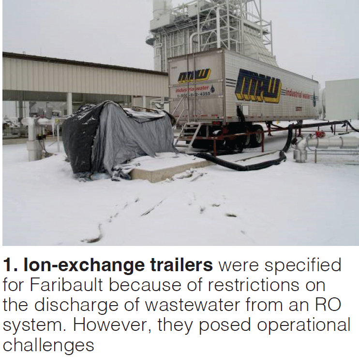

Initially, Faribault used mobile ion-exchange trailers for steam makeup water because of restrictions on discharging wastewater from a reverse-osmosis (RO) system. This setup posed operational challenges, particularly during Minnesota’s harsh winters, leading to icy conditions and potential safety hazards (Fig 1).

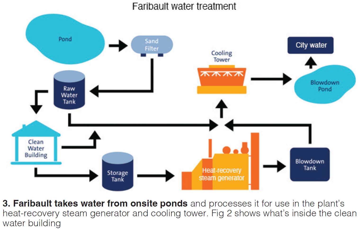

The plant is supplied water from a well that feeds the multi-pond storage system prior to entering the plant. The pond system also collects rainwater from the area and provides buffer capacity during periods of peak demand. In addition, the ponds are open to the public for recreational sport fishing. The pond system experiences high turbidity peaks and high water-temperature variability, which introduce challenges for a membrane system design.

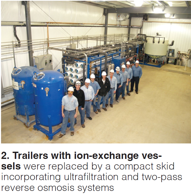

Given the variable water quality and temperature, UF was selected to pretreat water flowing to the RO system. It provides superior and consistent water quality compared to conventional media filtration and is fully automated, including CIP (clean in place).
UF can filter particulate matter down to 0.1 micron as compared to MMF’s typical 20-micron capability. The coagulation + MMF would have required higher operator involvement for chemical and operational adjustments because of turbidity levels and temperature variability. Veolia Water Technologies and Solutions was selected and provided a UF and two-pass RO in a compact skid design system (Fig 2), which is located in the clean-water building (Fig 3).

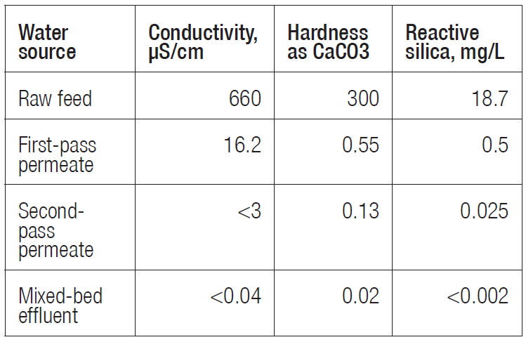

RO (two pass)/MBDI exchange. RO maintenance over the last 14 years included quarterly membrane cleanings and replacement of a few instruments, rebuilding of a couple of valve actuators, and standard pump service. Personnel estimate that an average of 15 min/day is spent on data collection and general maintenance.
Based on water sampling completed in March 2022, with original membranes operating for 12 years, the water quality was as follows:
RO membranes were replaced in February 2024 after 14 years of service, versus the original projection of five years. The membrane reload took plant personnel four hours with OEM support. Saving based on membrane life versus budget was about $10,000.
