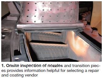

Refurbishment of components should begin with parts inspection and condition assessment at the plant before disassembly (Fig 1). The information compiled is helpful in selecting the repair and coating vendor, developing the repair and bidding specifications, and avoiding rework caused by fit-up problems.
Checking dimensions. Before removing any parts, check clearances at critical locations (Fig 2). Recall that hot-section components are subject to creep, which causes them to deform and reduce as-built clearances. This is especially true for unsupported components exposed to high temperatures and stresses—such as shrouded blades (second-stage buckets) and second-stage vane segments (a/k/a nozzles), so-called shroud lifting and downstream deflection (DSD).
Wear can increase clearances beyond those recommended by the OEM (original equipment manufacturer). It occurs most often where a rotating part rubs a stationary component, such as at blade-tip and angel-wing locations. Wear also results from prolonged slow rolling of the turbine rotor on turning gear. So-called “blade rock” is caused by an increase in clearances between blade roots and the mating root slots in the wheel (Fig 3). The problem gets worse with time as shutdowns accumulate.
In most cases, manuals provided by the OEM describe in detail how plant staff can measure clearances, shroud lift, DSD and blade rock. Alternatively, a repair vendor or IGT consultant can assist plant staff. The data gathered, coupled with a thorough visual inspection, helps determine if dimensional correction is necessary. Such work can involve blade-tip and angel-wing restoration, DSD correction, restoration of blade clearances (shroud blocks and blade tip heights), and/or application of an anti-rock coating.
The information compiled also is valuable in the verification both of dimensions taken during the repair vendor’s incoming inspection and of its proposed repair process. Doing the job correctly the first time avoids unnecessary repairs, late deliveries, and time-consuming fit-up problems during reassembly.

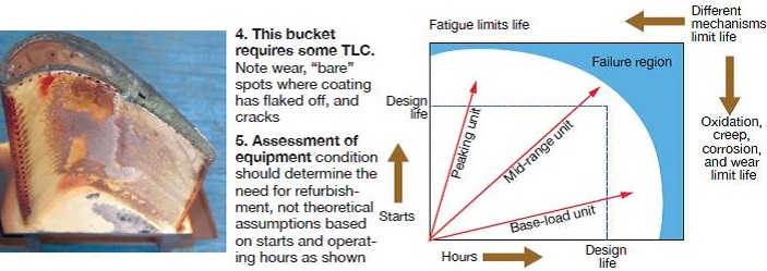

Importance of operating history. The actual number of starts, type of shutdown (normal or trip), and hours of operation are used by the OEM to determine when it believes an overhaul is necessary (Fig 5). This calculation can be further defined based on theoretical assumptions such as firing temperature and fuel. It is not in the best interest of most owners and operators because results often suggest overhaul earlier than may be necessary. When overhauls are governed by an OEM’s long-term service agreement, you may have no other option.
However, absent an LTSA, a better method might be to base overhauls on the actual condition of critical components. Plot your assessment of component condition (based on NDE, dimensional check, metallurgical evaluation of coating and base material, mechanical testing, etc) against operating conditions (fired temperature and hours, starts, etc) and identify the component that is driving the need to initiate an overhaul. Develop a plan to extend the operating life of this part through better weldment, coating selection, heat treatment, etc, thereby extending the time between planned outages.
Key to this approach is the development of a meaningful database. Carefully track and record the operating history of all critical parts, making sure to include such information as parts coatings and base materials, hours at temperature, use of water or steam for emissions control and power augmentation, etc. Access to such an information resource facilitates decision-making on outage scheduling, identification of components to repair and those to replace, etc, based on your plant’s actual needs. Currently there are software programs and online maintenance services available to assist the IGT operator with this.

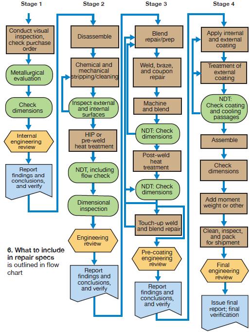

To ensure quality work, divide the repair process—and your specs—into logical stages. You want the repair facility to report its findings and recommendations after each stage and not proceed with the work before you or your representative approves. In most cases, dividing the repair process into the four stages illustrated in the flow chart will produce positive results. The steps are:
- Stage 1 Receive and conduct the initial inspection.
- Stage 2 Disassemble components, clean/strip, heat treat, and inspect.
- Stage 3 Repair, heat treat, and inspect.
- Stage 4 Coat, reassemble, and make a final inspection.

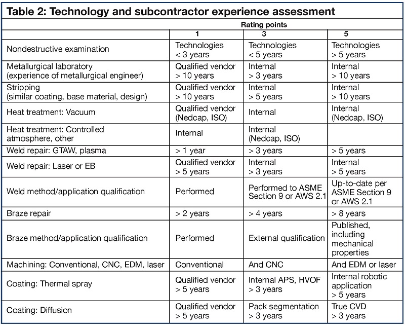

Technology and subcontracting. The assessment of IGT components conducted as part of Step 1, and the repair scope developed in Step 2, provide information of value for determining the optimum technologies for parts refurbishment. At this stage, keep in mind that it is not always necessary to apply the same coating system provided by the OEM on new parts. For example, in the past, MCrAlY often was applied on advanced blades and buckets with LPPS or VPS; today, however, HVOF-applied MCrAlY typically is used for repairs, and even new parts.
Information gathered from the onsite visual inspection, and from the AR (as-received) condition NDE and metallurgical inspection at the repair facility, sometimes suggests a customized repair and coating solution that can reduce the expected cost of refurbishment and/or extend the service life of components. Make sure you don’t miss an opportunity for competitive advantage by selecting a service provider that will partner with you to advise unselfishly on repairs and coating systems (Table 2). An independent IGT consultant could also be helpful in this.
Refurbishment of IGT components for late-model machines often requires sophisticated stripping, cleaning, repair, coating, and inspection technologies that are expensive to install and support. Thus many shops are not equipped to perform all these processes and steps in-house for all IGT models and they rely on subcontractors for certain tasks. To illustrate: Chemical stripping of IGT components poses environmental and health concerns and is often subcontracted to a specialty shop. Recently, however, the most experienced subcontractor was taken over and later closed down for these same reasons, leaving the repair facilities scrambling for an alternative.
To have certain repair or coating steps performed by a specialized subcontractor can be advantageous. However, your repair facility is still responsible for final product quality and must monitor the subcontractor to ensure conformance to specifications. This requires expertise on, and experience with, a process not present at your vendor. And, since the subcontractor is an extension of the primary company, it should be audited as part of your capabilities assessment.
