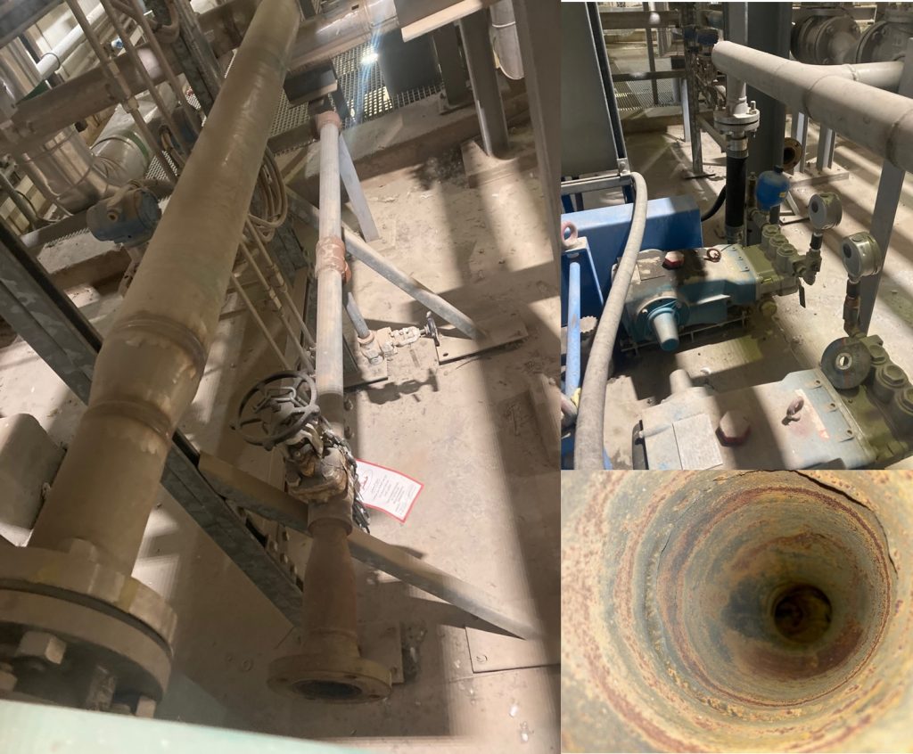

Challenge. The washing system for cleaning Amman East’s air-cooled condenser created high noise and vibration when operating—at times so severe that the discharge line would break.
Solution. These proposed solutions were investigated by plant personnel:
  • Shifting the washing pump skid to the nearest adequate source.
  • Changing the suction line to stainless steel and increasing its diameter.
Results. Problems solved: Cleaning performance improved, noise level reduced, repairs previously required eliminated.
