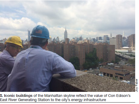

High-profile customers
East River is justifiably proud of its role in serving the city’s steam needs (Fig 5). After all, you can’t get higher profile customers than The United Nations, World Trade Center, Metropolitan Museum of Art, Rockefeller Center buildings, marquee New York hospitals, and major high-rise residential and office complexes.
