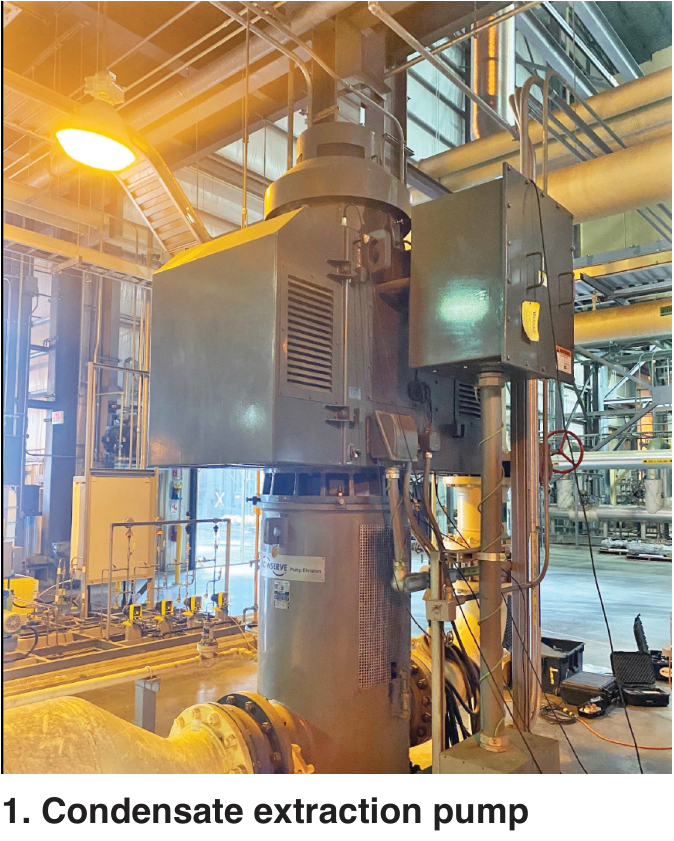

Recognizing the benefit of condition-based decision making, a combined cycle end user in the Northeast sought an accurate picture of equipment health before scheduling maintenance of their condensate extraction pumps (Fig 1). They engaged with Hydro’s field engineering division, Hydro Reliability Services, to perform a full health audit on this equipment to understand where to best concentrate their resources.

The pumps tested were two condensate extraction pumps of the vertical can configuration. Each pump is rated for 100% of the plant load. The pumps take suction from the condenser hotwell and discharge through an economizer to the LP drums that feed the boiler feed pumps. Tested parameters included:

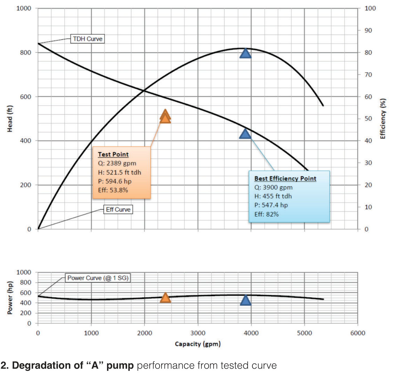

The field-test data clearly showed that the “A” condensate extraction pump showed signs of significant degradation. Indications of substantial wear were evident in both the hydraulic and the mechanical parameters measured. The total develop head as measured was 12.5% than the head on the tested performance curve for that flow point; the efficiency at this point was 15.2% lower than expected. As would be expected with the degradation in efficiency, the brake horsepower at this point was 14.3% higher than what was indicated on the factory test curve (Fig 2).

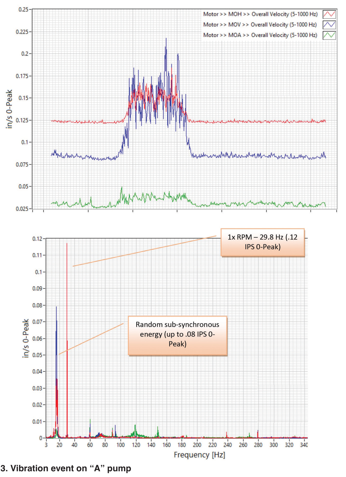

During the field testing, the “A” pump experienced a notable vibration event. For approximately 6 minutes vibration amplitudes in the outboard motor measurement locations increased. While the amplitudes did not exceed the first alarm level, the pattern was still concerning. At this same time, the suction flow trend showed a slight increase. During this time, the subsynchronous energy increased at approximately 54% of the run speed (Fig 3).

Following the testing phase, the data was reviewed to evaluate the best path forward for O&M. It was clear that pump “A” was in need of an overhaul to restore the equipment to its original design clearances.
Both the degradation in performance (head and efficiency) and the mechanical issues could be attributed to excessive running clearances caused by component wear. The close clearance areas of the pump limit internal recirculation; opening these clearances will increase recirculation and decrease efficiency. The close clearance areas also contribute to rotor stiffness and stability, which explains the subsynchronous vibration anomalies.
