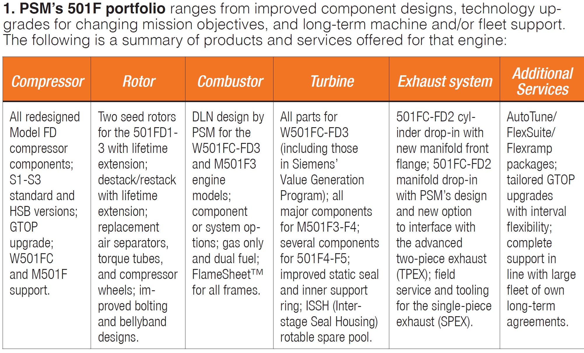

Focus here is on the comprehensive suite of products and services, including PSM’s well-known GTOP and FlameSheet™ brands, available for the 501F machine (Fig 1), a technology development effort begun a decade and a half ago, including two presentations on field experience from two of the largest gas- turbine/combined-cycle owner/operators in the country. A third user presentation reviews experience with a 7EA upgrade.
From a high level, the various 501F GTOP versions offer output increases of between 8 and 20 MW and heat rate improvements from -2.5% to -3.8%. Soon, GTOP (with FlameSheet™ Gen VII) will be achieving sub-30% turndown. Total number of 501F hot-gas-path (HGP)/compressor upgrades performed by PSM: 24.

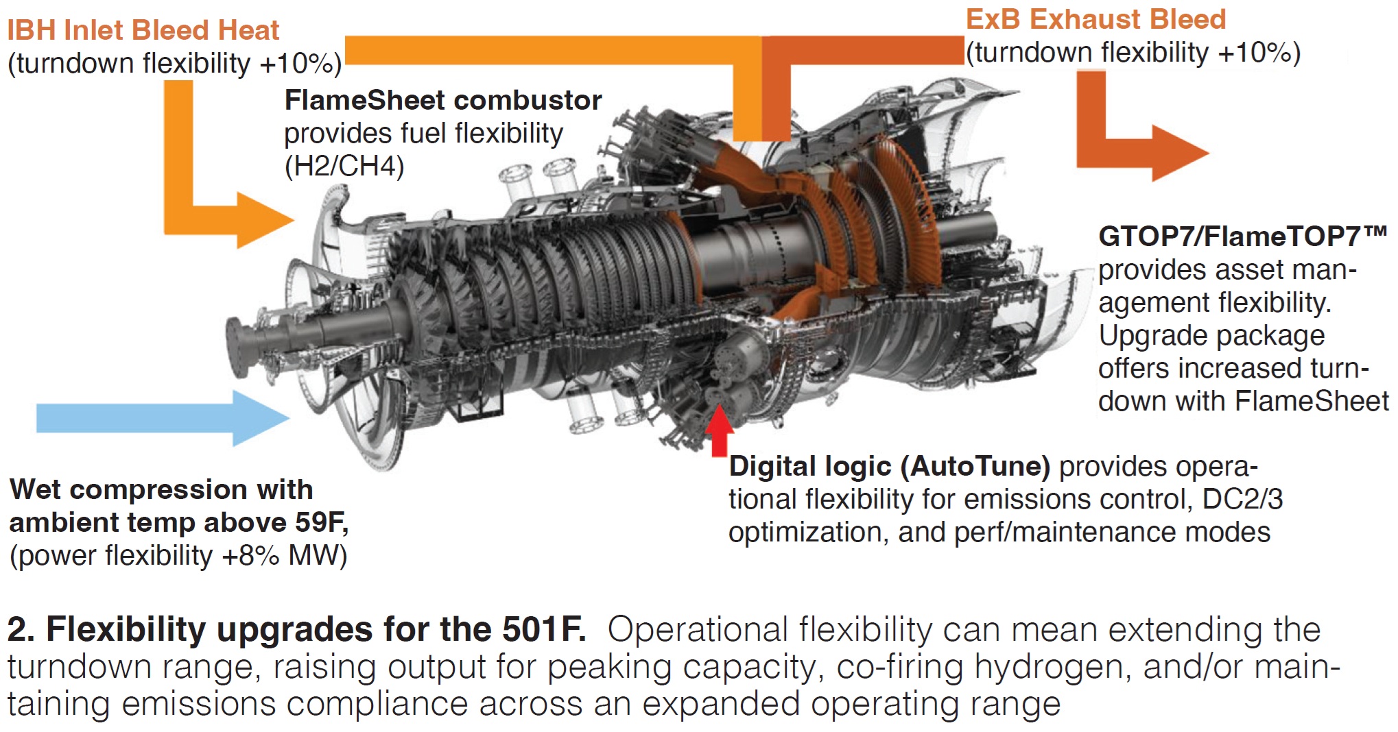

If it is operating flexibility you are after, the company has options across the machine (Fig 2) including in addition to GTOP, the FlameSheet combustor, inlet bleed heat (IBH), exhaust bleed (ExB), wet compression, and digital logic. ExB, in particular, can achieve up to 10% better turndown, and can be coupled with separate or integrated anti-icing capability with no modifications to the filter housing.
Ultimate flexibility comes in the form of the FlameTOP 7 upgrade, a combination of GTOP and the FlameSheet™ combustor. The three general operating modes are the following:
- Maintenance—32k hours, 9% simple cycle (SC) power boost, and 3.4% better heat rate.
- Performance mode—24k hours, up to 12% SC capacity boost, and 3.8% better heat rate.
- Peak mode—up to 13.6% SC power boost, and 3.8% heat-rate improvement. All of these improvements are possible without sacrificing a 9-ppm NOx emissions limit across the load range.

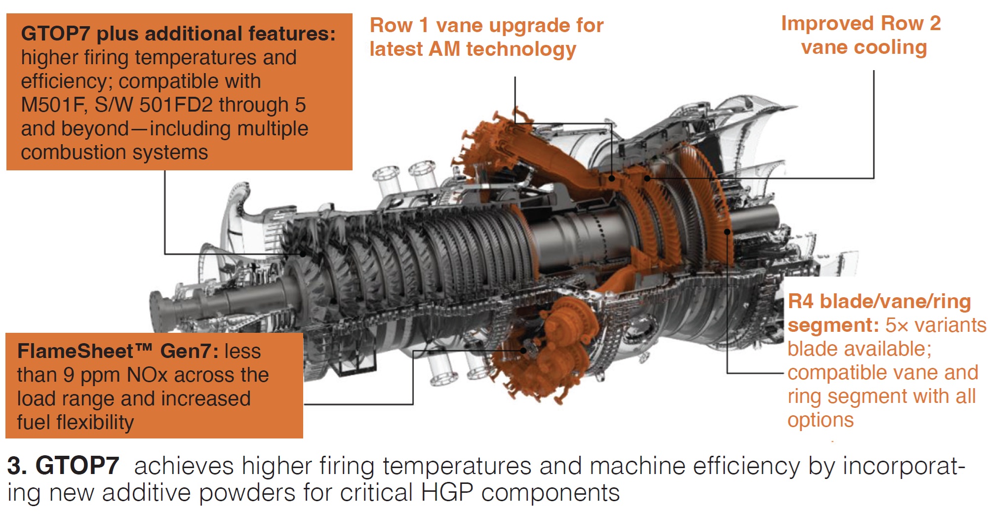

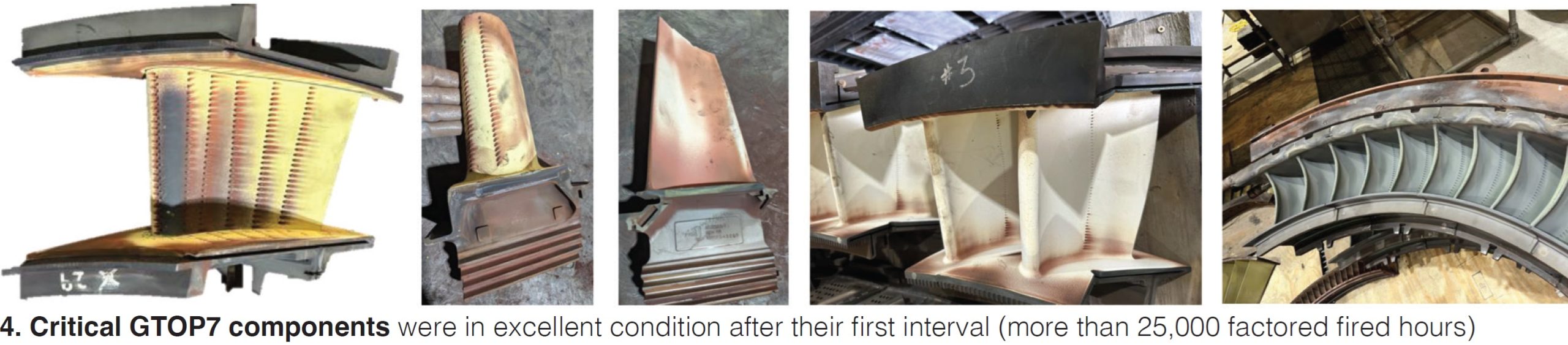

And PSM isn’t stopping there. The next generation of GTOP (Fig 3) is incorporating FlameSheet™ Gen VII (FlameTOP7), plus new alloys for better resistance to low-cycle fatigue and creep, and additive manufacturing, and other techniques to speed up production capabilities. Uniform crystal temperature sensors embedded in TBC coated parts have validated lower metal temperatures in AM parts made using the latest techniques.
The first repair cycle of the next-gen GTOP7 first-stage vanes from the fleet leader’s machine surpassed 25k factored fired hours (FFH) with minimal distress. Check out the photos in Fig 4 to see how the vanes looked coming out for inspection and repair. Overall, AM-produced vanes have been installed in over 13 machines with 132k operating hours and 2200 fired starts.

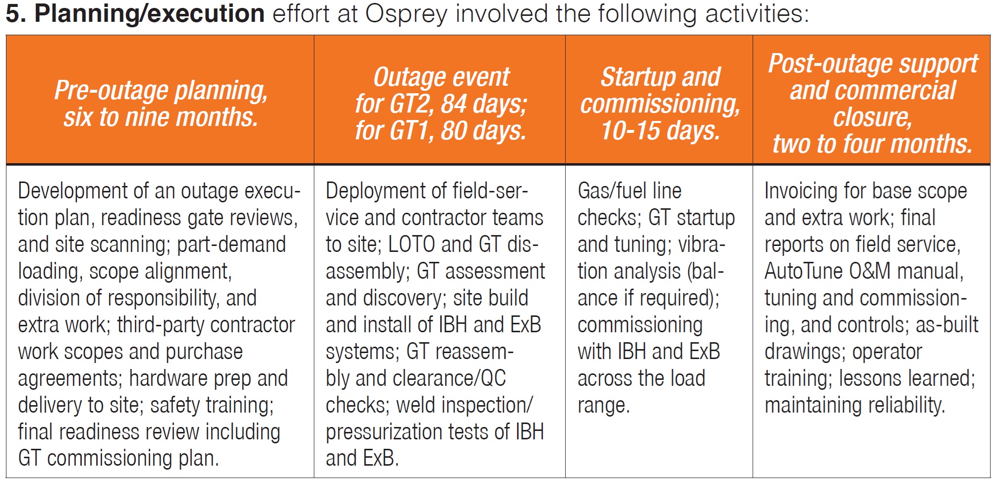

After project completion, the plant tops out at 576 MW+ (up from 537 MW), over 600 MW with PAG and duct firing enabled, and turns down to 235 MW with IBH and ExB (from the earlier limit of 380 MW). This is a total of an operating range of 365 MW, all while holding sub-9 ppm NOx. To achieve the turndown levels, the ExB Flexline connectors (from the injection manifold to the bleed injectors) had to be replaced which came at a later outage and is now fully enabled on both units.
Major project activities and schedule (Fig 5) suggest the importance of the pre-outage planning phase, but of particular note is that the actual unit outages were 80 and 84 days with 10-15 days required for commissioning and startup.

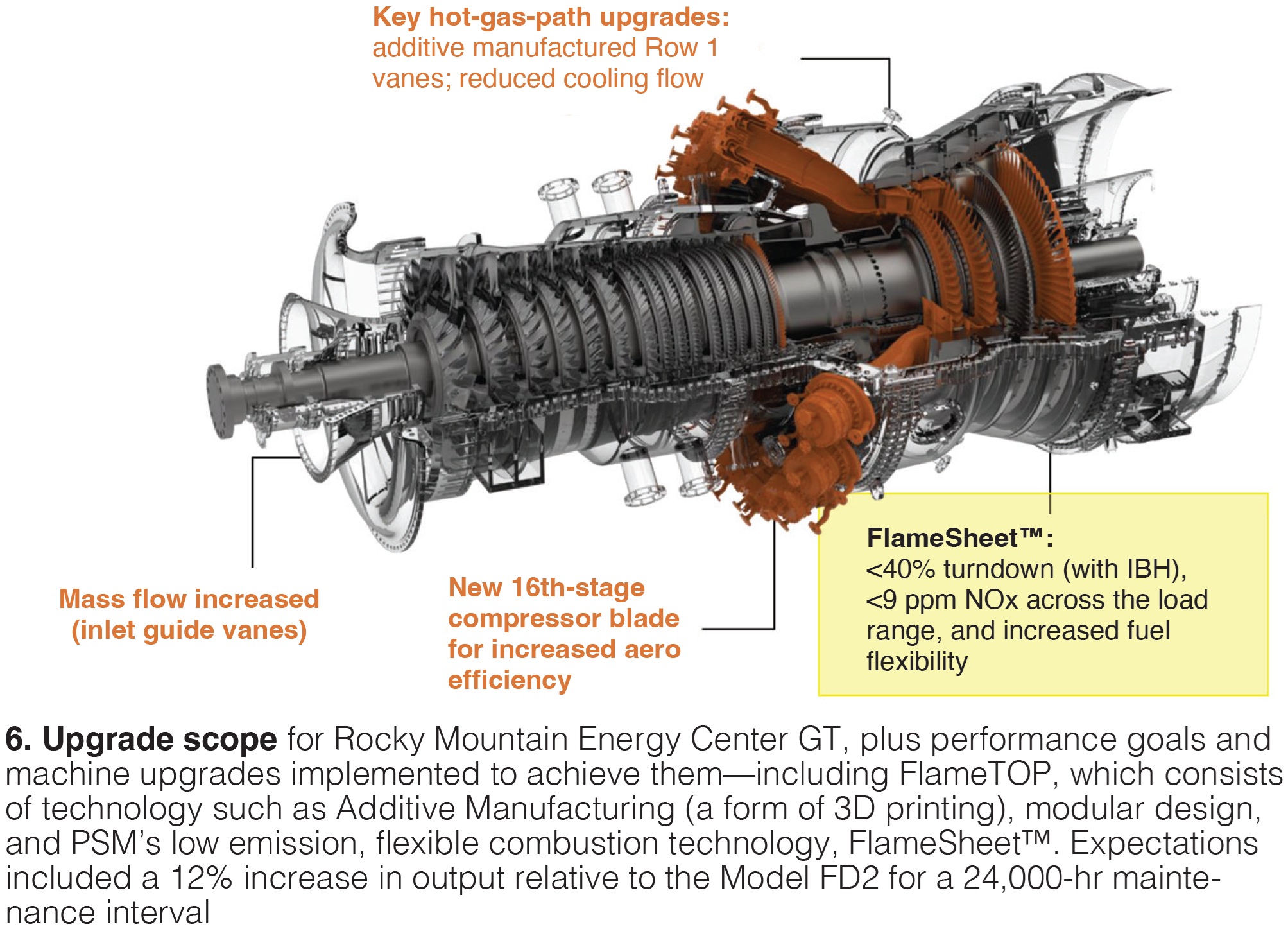

Rocky Mountain Energy Center. Jeff Hall, Xcel Fleet Engineering Turbine Div, and Jose Ruiz, PSM’s director of project execution, explained how the scheduled outage for Rocky Mountain (2 × 1, two 501Fs, one KN steam turbine) to install the FlameTOP upgrade revealed several other issues which had to be addressed: ST/G coupling alignment, need for a 4-way joint Superbolt™ solution, significant wear on hookfits, bearing damage, foreign object damage (FOD) on blades and diaphragms, and bearing damage.
Like many other system owner/operators, Xcel needed more dispatchable power from RMEC to follow its wind resources, but also wanted to extend inspection intervals from 24k to 32k, reduce ammonia consumption, and be prepared for future hydrogen co-firing. The presenters note that the key HGP upgrade within the project scope (Fig 6) was the additive manufactured R1 vane, which reduces cooling airflow.
The project achieved the stretch capacity goal (160 MW) for both units, a 1.62% heat-rate improvement, and turndown to 50MW in Unit 1 and 45 MW in Unit 2 (with IBH and ExB). However, while both units are available, PSM and the plant were resolving emissions-performance issues with Unit 1. Distress found with some of the new hardware led to replacement of some parts and aggressive tuning efforts. This has since been resolved and both units are currently operating at sub-9 ppm NOx.
Included in lessons learned and observations are: Every unit is unique (with exclamation point), hookfit repair was challenging, pay attention to routing and securing thermocouple leads, carefully consider IBH positioning with respect to the silencers, and assess and understand the potential limitations of the BOP.
