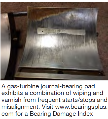

Since bearing damage is frequently an effect, rather than the cause, identifying the root of a problem can be difficult. For example, among the most common types of bearing damage is wiping, characterized by a rubbing, melting, or smearing of the bearing’s babbitt material. The cause of wiping may be any number of issues: excessive load at startup or shutdown, insufficient lubricant, operational overload, inadequate or loss of clearance, excessive vibration, or misalignment. The common factor is that contact occurs between the bearing and rotor.
To properly identify the root cause of wiping, it is necessary to look at the characteristics of the wiped bearing surface and for other damage on the bearing. Wiping that occurs during startup and shutdown may exhibit as successive thin layers of wiped bearing material.
Misalignment, on journal bearings, may cause a parabolic-shaped wiping or a wear pattern angled across the bearing surface. On thrust bearings, it may result in a group of pads on one side of the bearing being wiped.
Inadequate clearance may be indicated by an evenness of the wiping on all of the pads or lobes in a journal bearing. However, high dynamic loads may also cause wiping on all of the journal pads and resemble the effect of a loss of clearance.
Additional types of damage may provide clues to the root cause: On tilt pads, wiping caused by excessive load typically is seen together with significant pivot deformation. Wiping accompanied by oil varnish may indicate insufficient oil flow to support the bearing load or to cool the bearing. Yet, diagnosing bearing damage is frequently complicated by the fact that one type of damage may progress from—and hide—other types, or may lead to further damage.
