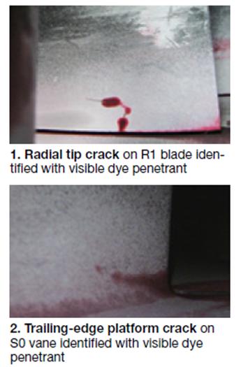

- R0 and R1 blade-tip distress is caused most commonly by tip rubs against the case during operation. This usually is identified by tip discoloration or a heat-affected zone (HAZ) or by rolled metal. Such distress can lead to radial tip cracks (Fig 1) and tip liberations with significant collateral damage to forward and aft compressor stages. If tip discoloration is identified, the TIL recommends dye penetrant inspection at 25, 50, and 100 actual fired starts from the discovery of the rub. If rolled metal or tip loss is identified, repairs should be completed at the first opportunity. Until then, dye pen inspections should be performed every 12 actual fired starts. After repairs, inspect at 25, 50, and 100 actual fired starts. ATS has identified multiple rotor-blade cracks with visible dye penetrant that were not seen during conventional visual inspections.
- S0 stator-vane trailing-edge cracks apparently are caused by vane “lock up” (Fig 2). Cracks could result in vane liberation and significant collateral damage to forward and aft compressor stages. If trailing-edge cracks are found, replace the affected vanes immediately. Note that ATS has identified S0 trailing-edge cracks with an eddy-current inspection that were too small to find visually and with fluorescent dye. Further, ATS has identified S0 leading-edge and radial tip cracks in both flared and unflared compressors; they are not addressed in 1509-R3.
To sum up, in the last 10 years ATS has completed more than 1000 in-situ inspections and identified over 150 cracked rotor blades, more than 60 S0 cracked vanes, and two S1 cracked vanes. For rotor blades and stator vanes that do not show any signs of distress, ATS recommends the following as a minimum: Annual visible dye-pen inspection of R0/R1 blades. Plus, dye-pen or eddy-current inspections of S0 vanes annually or after each 100 actual fired starts. Subsequent inspections based on the results of the inspections would run parallel to the OEM’s recommendations.
