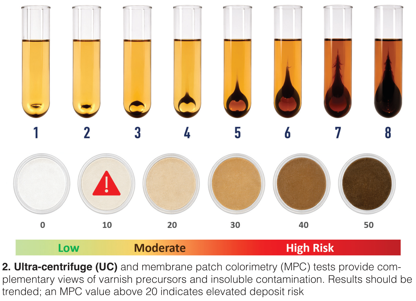

His testing schedule was equally practical. Duke samples quarterly for particles, water, and TAN, does annual RPVOT and RULER work, and runs varnish checks semiannually at his stations. He put the reasoning in plain terms: varnish testing twice a year matters “because that’s so critical just to stay on top of it.” Rowland then walked through the toolkit behind that program. An ultracentrifuge test ranks insolubles and varnish precursors on a 1-to-8 scale. MPC, or membrane patch colorimetry, ranges from 0 to about 100, with concern rising once the result moves past 20 (Fig 2).
Rowland said the two tests should be used together because plants can encounter “clear varnish,” where one indicator may look acceptable while deposit risk is still real. He also cited RPVOT as a measure of oxidation stability, saying a good turbine oil should be above 800 minutes and new oil may run up to about 1200 minutes. RULER testing, he added, is commonly watched for antioxidant depletion, with alarm attention beginning at about 50% of new-oil value.

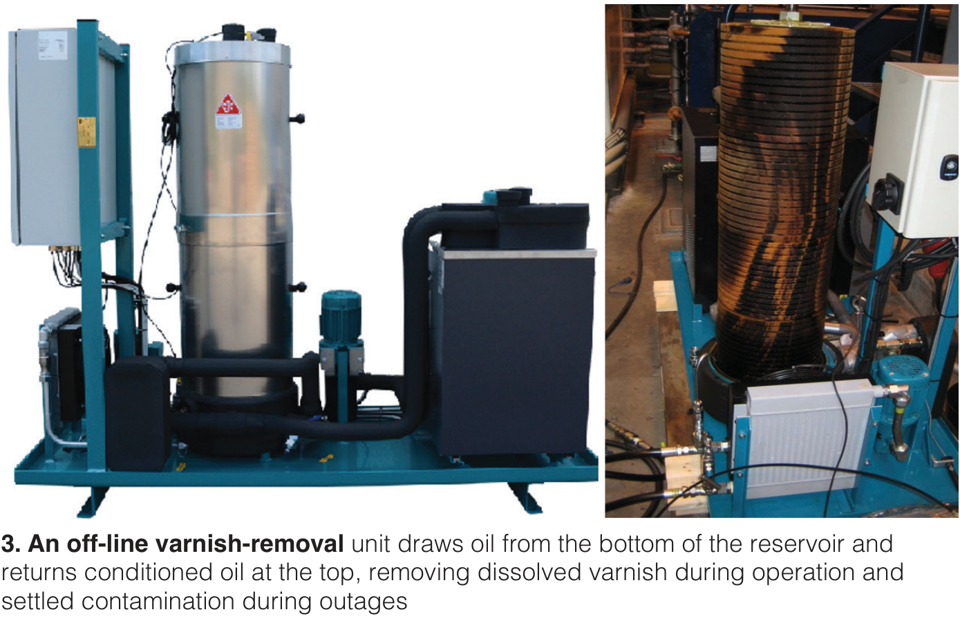

The equipment discussion stayed grounded in mechanism. Rowland said there is no “magic filter” that handles every oil application the same way, then described the company’s varnish-removal approach for gas-turbine service. The idea is to cool the oil to about 40F so oxidation byproducts precipitate, agglomerate, and can be captured by adsorption media instead of remaining dissolved in the fluid. He described the arrangement as an off-line loop drawing from the reservoir bottom and returning to the top for continuous circulation (Fig 3). The turbine does not have to be running. In his view, that is what allows the unit to work both during operation, when dissolved varnish concentration is high, and during downtime, when settled contamination can be picked up before restart.
