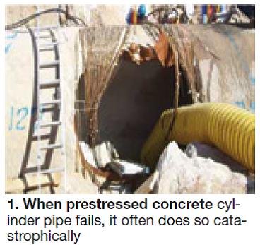

Prestressed concrete cylinder pipe (PCCP) also is brittle, but it compensates with massive strength. It is a good choice for burial under railroads and roads that will carry heavy loads. Bedding requires less attention than plastic pipe’s because concrete is not as vulnerable to pinpoint pressure, and vacuum-caused collapse is not a threat.
The alkaline nature of the cement mortar protects the steel prestressing wires from corrosion, making the steel passive by shifting its pH well above 11, said Brodar. A crack in the coating, however, puts this type of pipe at risk by exposing the bare steel, making it the anode and accelerating corrosion. If that happens, PCCP can fail catastrophically, he said (Figs 1-3).

Until fairly recently, the only way to inspect prestressed concrete cylinder pipe was by visual inspection or sounding—tapping the surface with an inspection hammer. Good concrete sounds solid when struck, and the hammer rebounds readily. Disbonded or weak concrete, on the other hand, gives a dull sound, a “thud.” Brodar now recommends a baseline remote-field eddy current (RFEC) for inspection on all critical PCCP. If the baseline survey identifies damaged reinforcing wires, then periodic follow-up surveys are required.
The eddy current send-receive probe technique is a screening tool, said Tom Burnett, power group director with Intertek Aptech, Houston, the contractor that inspected Southwestern Public Service’s Harrington Station after its circ-water pipe failed. The technique uses variations in the strength of magnetic waves shot through metal to identify locations of possible corrosion for visual inspection.
Brodar likes RFEC because it locates corrosion in the prestressing wires in PCCP. Aptech used pulsed eddy current testing at Harrington because the failed pipe was carbon steel, and PEC “can test relatively large areas without significant preparation, and provide a good screening evaluation of wall loss in ferritic steels,” says an Aptech report.

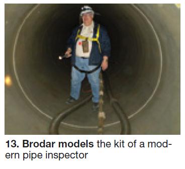

The interior is another story. Pipe size and length are the factors here. Pipe diameter affects inspection and maintenance mainly because, “if you can’t stand up in the pipe, it’s a real challenge to perform inspections and especially coating maintenance,” said Brodar (Fig 7). On a long pipe, manholes must be spaced so that hoses and cables will allow the workers to reach the midpoint between them.
The principle that rules large-diameter underground pipe maintenance is, “Whatever goes into the manhole has to come back out,” said Brodar. If the sandblasting operation uses 40 tons of sand, that’s 40 tons that must be removed at the end. Instead of hauling out buckets of sand through a manhole, he has had “phenomenal success” using a vacuum truck to clean out the sand. Sandblasting also requires “dragging a big, fat hose with fittings and ears across thin-film paint,” causing the invert, or floor of the pipe, to be in worse condition after the cleaning than before, he said.Brodar has cleaning contractors work in both directions from a single manhole during a turnaround, while limiting the scope of work to a reasonable length of pipeline for each outage. Work during the next outage then will begin at an adjacent manhole. Because of the difficulty of access he limits the amount of maintenance work to what is reasonably achievable in the outage period.
Brodar prefers cleaning pipe interiors with ultra-high-pressure water jetting (above 25,000 psig) or low-pressure water cleaning (between 3500 and 5000 psig), depending upon the size and scope of the job. Both types of water cleaning require the use of a rotating tip for production rates and chemical decontamination to remove chlorides and sulfates.

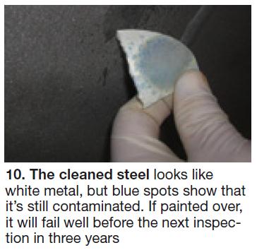

Blast cleaning to white metal clears the obvious corrosion, but it also embeds many of the contaminants in the steel, Brodar said. If that occurs, flash rusting is inevitable, even after dry blasting. High humidity alone will not trigger flash rusting on an uncontaminated blasted surface; direct water contact is necessary for that to happen. But a blast-cleaned surface with trace contamination of soluble ions will flash-rust because the ions are hygroscopic, meaning they absorb moisture from the air.
Brodar prefers to pressure-wash with Chlor-Rid, a chemical decontaminant that removes soluble salts, using a zero-degree rotating tip that sprays a thin jet of water in a circle at 3500 psig. Pressure-washing is often done with a fan tip, which cleans broadly but not deeply into pits, he said. It is effective for the still coated, uncorroded surfaces, but it leaves traces of the soluble salts in the pits, and rust will reappear, often within minutes. When the rotating jet, on the other hand, is moved slowly over the surface, it cleans deeply, leaving a characteristic pattern, and the salts are completely removed (Fig 8).
Brodar tests steel for contamination with a small sheet of lab paper or filter paper impregnated with a solution of 4 milligrams of potassium ferrocyanide in 100 mg of water, which he prepares himself. It dries with a bright yellow color. He wets the spot to be tested, then presses the paper on it. If it turns blue, the surface is contaminated with chloride or sulfate (Fig 9). Tests after cleaning reveal spots where the salts remain (Fig 10). In that case, cleaning continues until there is no blue on the paper.
People who can do quality work inspecting circulating-water pipes are a subset of qualified powerplant inspectors, said Brodar. They have to be able to handle confined spaces, heights, and darkness without fear. The old rule is, “If you’re going to a powerplant, you should have a flashlight,” he said. “If you’re going someplace dark in a powerplant, you should have three or four flashlights.” His inspectors now use LED lights affixed to hard hats, which Brodar calls “a phenomenal improvement over the old stuff” (Fig 13).Removing nonvisible soluble salts is more important than removing all rust, Brodar said (Fig 11). A steel surface with light-brown rust can be painted over as long as there are no darker spots (Fig 12).

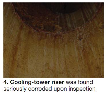

The failure at Southwestern Public Service’s Harrington Station Unit 3, mentioned at the start of this article, illustrates these calculations. The failure occurred in a mastic-coated, unlined, 32-in. pipe at the top of the inspection riser buried under a 6- to 8-in. concrete slab and a couple of feet deep in compacted sand.
The pipe, in service since 1980, was supposed to be 0.375-in. wall, which would have given it a diameter-to-thickness ratio of 85.33, but it was found to be actually 0.1875 in. With a D/t ratio of 170.67, the pipe’s 30-yr service life without collapse is remarkable in itself. The pipe failed because its mastic coating failed, but “had it been design spec, it probably would have lasted a few more years,” said Xcel’s David Low.
The cubed-root law for pitting pegs that extension at approximately 2[3]t x 30 or 240 years. The Harrington failure was caused by general corrosion, not pitting, so the cubed-root formula is not likely to give an accurate prediction of increased time to failure, Brodar said, but it supports the opinion that the originally specified thickness would not have failed in just 30 years.

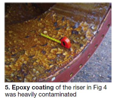

Xcel Energy is taking the lesson of its circulating-water line failure to heart. In the month following the break, Houston-based Intertek Aptech did a pulsed eddy current inspection of the system, and David Low will have the underground lines coated with 0.25-in. of polymer during the next planned outage.
Inspectors also accessed the interior of the failed riser via ladders for visual inspection and found the interior rough. The pipe is not normally accessible from the outside, so the company did not often inspect the 32-in. line, and the interior was not previously scraped and painted. That maintenance was done as well. “It’s a heads-up for all our plants from Minnesota to Colorado to New Mexico,” Low said. CCJ
