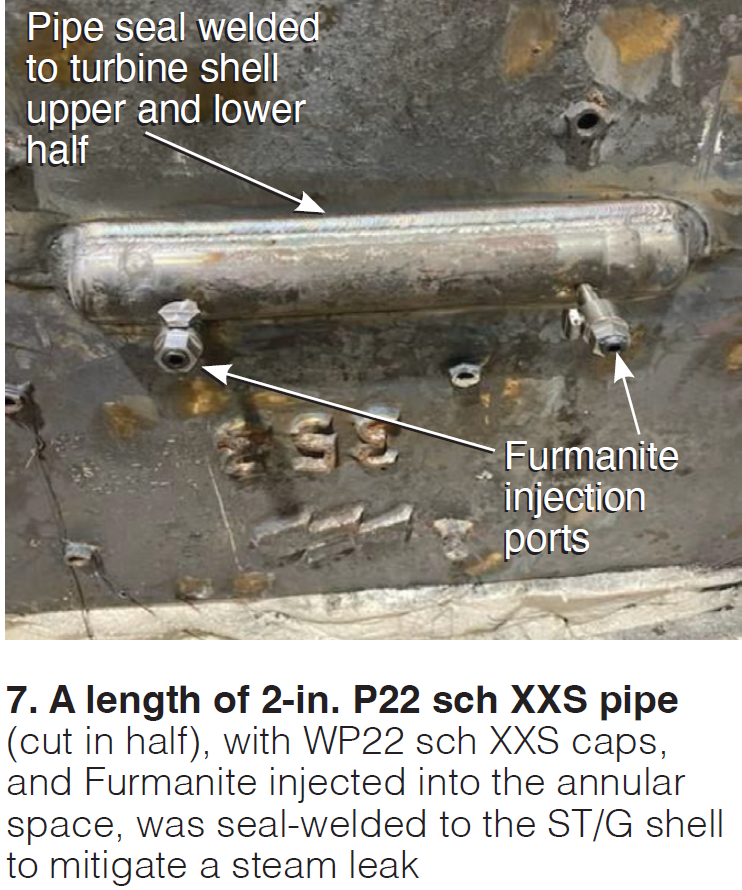

“Steam Turbine Shell Leak Repair” describes a home-grown solution to a D11 shell leak discovered through thermography on the right side of the IP section. Specialists fabricated a capped, ported piece of pipe cut axially, and seal-welded it to the turbine shell after heating the shell to 400F (Fig 7).
Furmanite, a material specifically designed to seal high pressure leaks, was then injected by hydraulic pump into the ports to fill the space between the shell and the pipe, and the ports capped off. Afterwards, welds were inspected using MPE (magnetic particle).

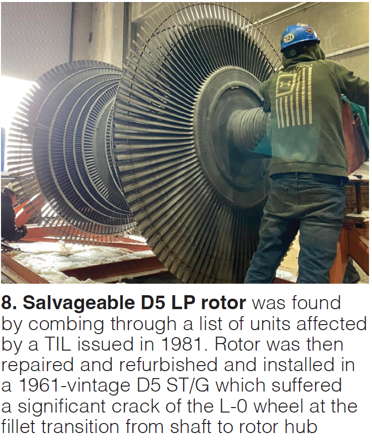

“D5 10-month Outage & Cracked LP Rotor.” Desperate times call for desperate measures, or when you need peaking capacity, you’ll go to any lengths not to permanently retire an ancient unit. This presentation is the saga, thankfully with a happy ending, of a 1961-vintage D5 ST/G LP rotor coupled to conventional gas boiler unit that suffered a 21-inch indication on the L-0 wheel at the fillet transition from shaft to rotor hub.
For six months in early 2023, vibrations at the T3, T4, and T5 bearings were increasing while the unit was progressively derated to compensate. When it became unbearable, an outage was taken, originally scheduled for two and a half months. The indication turned out to be a crack at least three inches deep.
Utility personnel searched their archives and found TIL931-3 from the early 1980s on wheel fillet machining recommendations for LP rotors with 26-in last stage blades. That document offered one option: procure, fabricate and weld a stub shaft in place of the last stage wheel (generator end).
Other options were to order a new LP rotor, repair the existing rotor, or find a salvageable replacement rotor. First two options had prohibitive schedules, and the plant did not have confidence in the repair option. Fortunately, the TIL documentation also included a list of affected units, sites possibly having decommissioned rotors. The plant managed to find a D5 rotor of appropriate length which was refurbished and fitted to the existing components (Fig 8).
Although the outage had to be extended by seven and half months, the unit is now able to deliver its full output to automatic generation control (AGC). Others who improbably find themselves in a similar situation may have to resort to options one through three: This may have been the last decommissioned D5 LP rotor available, at least in this length range.

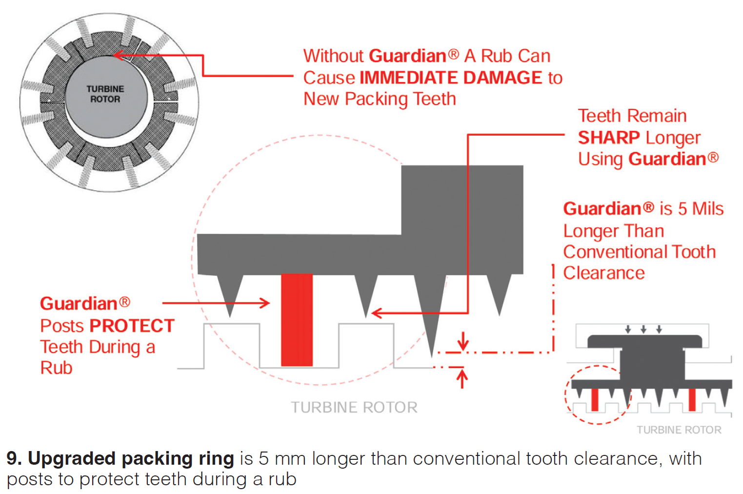

“MD&A Parts – Guardian™ and Vortex Shedder™ Design, Installation Process, Benefits,” Jacques Amyot, MD&A
Title refers to parts for the ST/G steam sealing (packing) rings installed in over 300 units of all OEMs which are “proven to increase efficiency by 1.5-4.5%.” Slides cover steam sealing basics (with excellent diagrams), product design descriptions, reverse engineering measurements, installation steps, and case studies (Fig 9).
