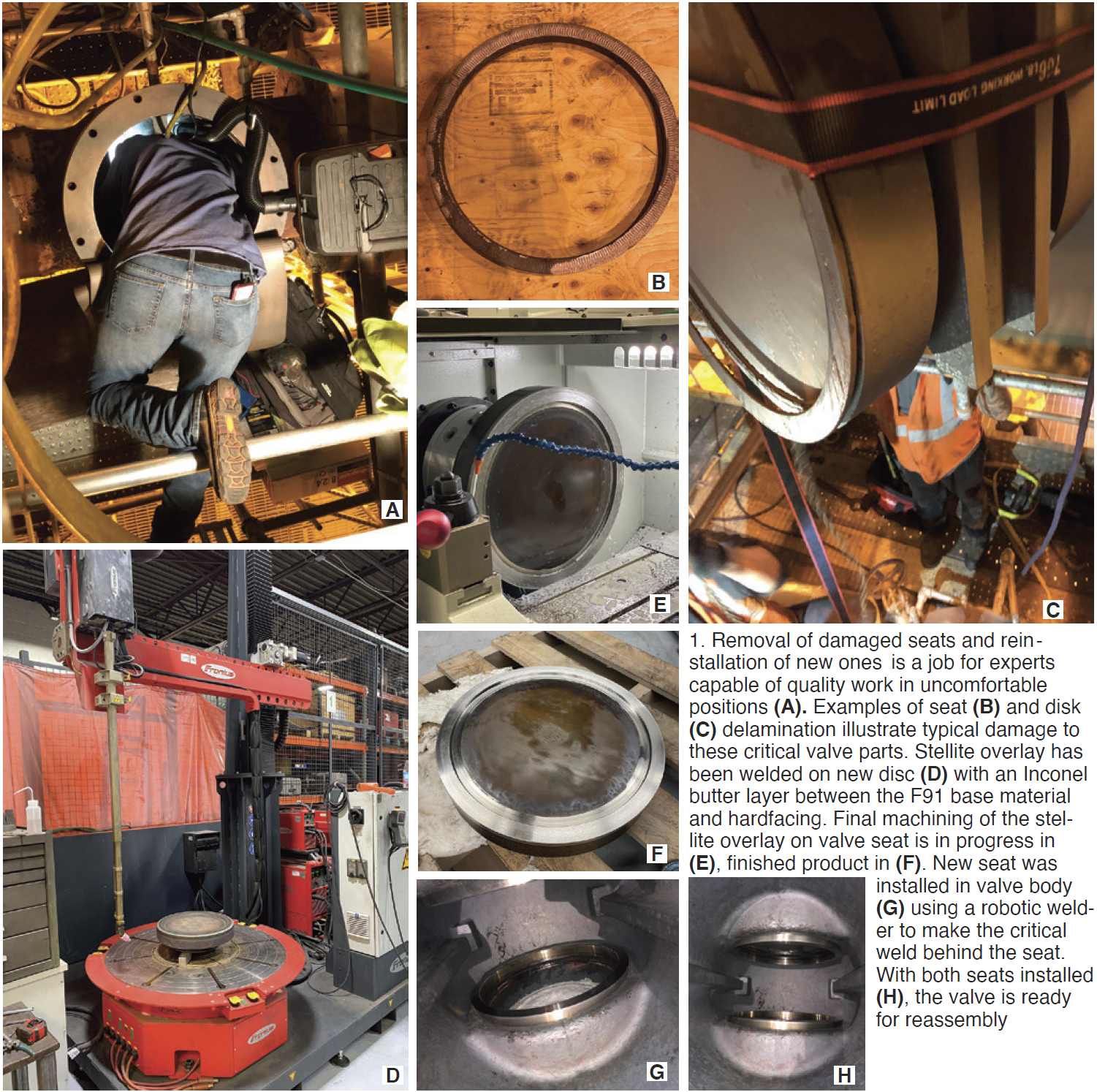

In simple terms, here’s what EPRI’s materials experts learned: Addition of a “buttering” layer of nickel-based alloy—such as Inconel™—separated Stellite and F91 material and prevented formation of an undesirable metallurgical condition in the weld zone between the two metals which is conducive to disbonding.

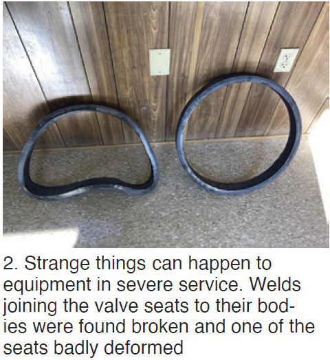

The first plant, a 2 × 1 H-class combined cycle began operating in 2017. Delamination was observed on six valves associated with the boilers and steam system at that facility—HP HRSG isolation, HP header isolation (a/k/a blending valve), and HRH (hot reheat) header isolation (for isolating one boiler from the other when necessary). The first type was in the European boiler manufacturer’s scope of supply and sourced from Korea, the mixing valves in the EPC firm’s scope came from another manufacturer.
The 14-in., F91 HP boiler valves were specified for service at 2420 psig/1065F. The type of Stellite hardfacing was not specified. What is known is that no buttering layer was used and that the Plasma Transferred Arc Welding (PTAW) process likely was employed for Stellite attachment. The HP isolation and blending valves are of the parallel-slide gate type and suffered Stellite liberation from both the seat rings and discs.
Note that these valves were manufactured before the EPRI guidelines (sidebar) were published. The EPRI findings identified disbonding concerns beginning at steam temperatures of about 975F, possibly even lower, with shorter expected life as the operating temperature increased.

A specialty engineering firm was engaged to analyze the scrap and make recommendations. There were no unexpected findings. That company also confirmed the importance of a buttering layer. Bezzant recommends a buffer layer of ERNiCr-3 (Inconel Filler Metal 82), or an equivalent PTAW powder, to prevent carbon migration into the Stellite.
The affected valves were disassembled and discs and seat rings cut out. Millennium provided new seat rings and hardfacing for the discs consistent with EPRI recommendations and the company’s experience.

Millennium Power refurbished four HP valves (isolation and blending) on the affected boilers to return the combined cycle to full power as quickly as possible. Work on the valves was completed in-situ a day ahead of the eight-day schedule. Plant’s plan is to address damage to other valves suffering delamination, as necessary, during future scheduled outages.
In preparation for the fall 2020 outage, Millennium got the repair effort on the two HRH blending valves moving before the outage began by making new seat rings in its shop, Florek touting the company’s ability to reverse engineer and typically make any manufacturer’s valve parts in less time than it would take the vendor of record to supply them.
The first step in the repair process was to remove damaged parts and prep the valves for new parts and hardfacing—something Florek says the company has done at least a couple of dozen times to date. Follow key steps in the montage of photos incorporated into Fig 1. He added that sometimes just the hardfacing is damaged, not the basic part. In such cases it’s sometimes possible to remove the coating and reapply Stellite with the requisite butter layer.
Millennium Power’s field service personnel moved in short order from this project to another in the region where two 24-in. parallel-slide gate valves were refurbished within two weeks. Old seats were removed, new seats manufactured with Stellite overlay and Inconel butter layer, and the valves rebuilt, including new actuators. Original seat welds were found broken; one of the seats was severely deformed (Fig 2).
At the third plant in the Northeast that Millennium serviced within the three-month period noted above, a 24-in. wedge gate valve in the HRH system was scheduled for a stem replacement to mitigate packing wear. A new stem was manufactured in the company’s shop and shipped to the site for installation.
When technicians disassembled the valve, Stellite disbonding was found on the wedge and both seats. The owner approved corrective action the next day and Millennium’s field machining crew arrived onsite four days later to remove both seats while concurrently refurbishing the existing wedge in accordance with EPRI recommendations. Seats were replaced, wedge refurbished, and valve reassembled all within 16 days of project start.
