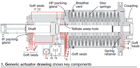

Before the Steam Turbine Users Group was launched in 2013, the major gas-turbine users groups may have dedicated half a day to steamers. STUG enabled owner/operators to drill down on important steam-turbine (ST) topics, like actuators, that weren’t covered previously because of time constraints (Fig 1).

Of course, the technician assigned responsibility for actuators should be looking at them periodically when out in the plant. One of the first signs of concern often is leakage out of the packing-gland telltale weep hole (Fig 5). If borescope examination of the spring reveals moisture or rust, maintenance should be scheduled soon.
Moisture causes rust which can cause broken springs which, in turn, score the shaft (Fig 6) and promote increased leakage. Plus, moisture can accumulate and contribute to the failure of springs on vertically mounted actuators (Figs 7 and 8). As a stop-gap measure, consider removing a breather vent and using dry shop air to pressurize the actuator, thereby preventing water/steam accumulation in the spring can.
