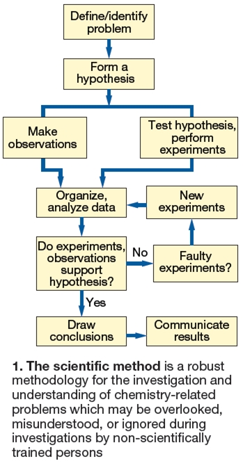

Troubleshooting chemistry involves the investigation of issues that must be conducted now to better understand today’s problems and to avoid new ones tomorrow. These include such things as:
- Undertaking root-cause-analysis (RCA) investigations of failures and ensuring that remedial actions are implemented.
- Providing cycle-chemistry input to assist in investigations of plant problems—often to eliminate chemistry as a possible root cause.
- Using the “scientific method” to assure the correct outcome. This demands the following:
1. Understanding the difference between causation and correlation as they relate to data analysis.
2. Developing testable hypotheses.
3. Eliminating bias and preconceived ideas that could influence the final outcome of the analysis.
Whatever name is used—be it troubleshooting, incident investigation, or RCA—they all require the investigation and resolution of significant plant problems or failures with a chemistry component. This often is carried out as part of a multi-disciplined team that also may include engineers, operators, and plant management. Such activities are closely aligned with strategic chemistry, but also contain aspects of routine chemistry, as additional sampling and testing often is required as part of the investigation.
It is the chemist’s responsibility to introduce the scientific method to the other participants (Fig 1). Often underused and underrated in a combined-cycle environment, the scientific method will validate critical findings. It provides a robust methodology for the investigation and understanding of chemistry-related problems which often are overlooked, misunderstood, or ignored unintentionally during investigations by non-scientifically trained persons.
Anecdotal, information, conjecture, preconceptions, and poor understanding of the plant and its processes often lead to incorrect RCA results and the high probability of repeat failures. Important to remember: Never rely on anecdotal information.
