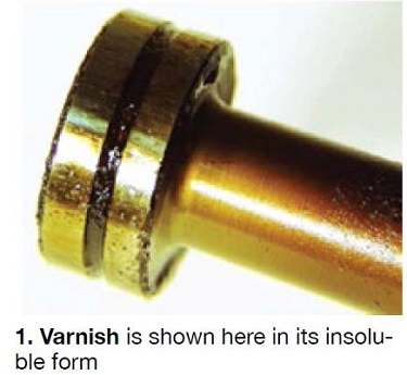

Lubricant varnish generally is defined as a thin, hard, lustrous, oil-insoluble deposit composed primarily of organic residue. It is most readily defined by color intensity and is not easily removed by wiping.
While this definition provides an adequate description of varnish at the end of its life cycle (Fig 1), it must be expanded as follows to account for the remainder of the varnish cycle: Varnish begins its life as a soluble degradation product before converting to an insoluble particulate form. The process responsible for the deposition of particulate varnish is reversible.
This expanded definition reveals that varnish is a shape-shifter; it can be insoluble (conventionally recognized particulate form) or dissolved (soluble) in the fluid. An understanding of lubricant solvency is the key to understanding the mechanism by which varnish deposits are formed and, more importantly, the mechanism by which they can be removed.
