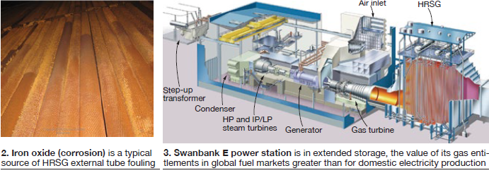

Dry-ice tube cleaning
Joel Williams, Precision Iceblast Corp, provided a specific strategy for increasing efficiency and output, and decreasing costs: HRSG tube cleaning with dry-ice blasting. He first compared dry-ice particles with the more traditional use of abrasive media, which can damage the metal substrate. Dry-ice particles do not.
Carbon dioxide (CO2) is now used effectively on the four primary types of buildup on HRSG tubes: ammonia salts, sulfate deposits, iron oxide deposits (corrosion), and insulation materials (Fig 2).
If such fouling is not removed, consequences often include increased gas-turbine (GT) backpressure, reduced thermal efficiency, and particulate emissions during startup.

Swanbank long-term storage
Stanwell’s 375-MW Swanbank E Power Station in Queensland (Fig 3) was removed from service in December 2014, primarily to benefit from the increasing world-market value of its gas entitlements. The unit’s return to service (originally 2017) has now been extended to 2018, increasing various long-term storage requirements and risks.
Stanwell Corp’s John Blake, a member of the AHUG steering committee, explained how the site continues to implement and expand comprehensive cold-storage and preservation techniques for all systems. This was consistent with his 2015 presentation that explained how the small caretaker team does not simply set and forget. They remain alert and look for improvements.
Some of the 13 dehumidifiers have experienced component failures, so crossover ducts are now installed for both redundancy and to maintain air turnover during repairs. Also, initial attempts to make an air-inlet duct balloon seal completely were not successful. HDPE sheets offered improved seals. Specifically, 600 1.5-mm sheets were installed between the pocket frames and filters, holding relative humidity (RH) below 10% back to the GT exhaust (Fig 4).
The presentation and discussion generated many questions and comments on a range of topics, including these:
- Rainwater ingress through external casing (and corrosion under insulation).
- Roof leakage.
- Separation and measurement of the dehumidified-air (DHA) circuits.
- A growing interest (globally) in film-forming amines in place of DHA.
- GT bearing protection.
- Generators, breakers, and related equipment concerns.
Blake’s summary statement fit the venue: “Long-term storage has a number of unknowns. It is good to come to these user group meetings to share our experiences and learn from others.”

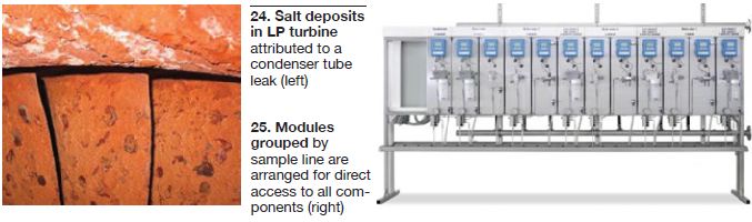

Steam and water sampling
Following some open-floor discussions, John Powalisz, Sentry Equipment Corp, covered current steam and water sampling issues related to cycling operation, reduced plant staffing, and corrosion products (metals) transport leading to erosion and corrosion.
Sampling issues specific to combined cycle plants, he explained, are:
- Flow is too high during startups.
- High temperature impact on equipment.
- Inconsistent data (pH, for example).
- Sample flow interruption by thermal valve trips.
- Flow is too low during low load, startups, or with plugging.
- Erroneous data, no flow to analyzers.
- Air ingress causing false numbers (carbon content).
The goal is to control the important parameters of velocity, pressure, and temperature for both online instrumentation and grab samples. Automated sampling racks, for example, should offer temperature control monitoring, pressure-reducing-valve (PRV) control, and the ability to set flow rates.

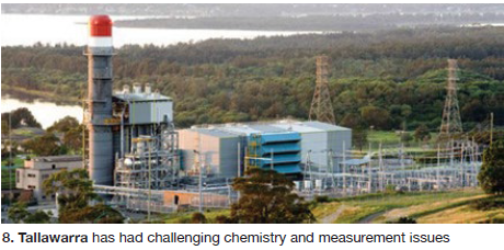

Cycle chemistry at Tallawarra Power

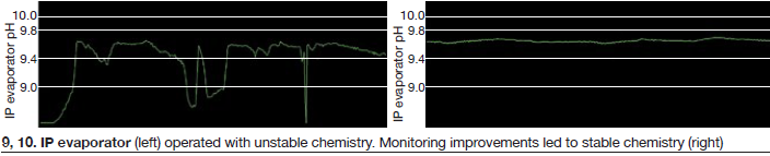

Ivan Currie, Energy Australia, then presented cycle-chemistry activities at the 435-MW Tallawarra Power Station (Fig 8) where he labeled the pursuits “a kaleidoscope.” The facility was commissioned in 2009 for baseload operation, but is now transitioning to flexible operation. The plant operates with an oxidizing feedwater chemistry and trisodium phosphate in the evaporators. It is saltwater-cooled.
Unstable chemistry (especially evaporators) was making proper dosing difficult, and control alarms were frequent (Fig 9).
Causes included low sample flows, suboptimal pH analyzers, frequent load changes (impacting conductivity-based dosing), inappropriate alarm set points, and insufficient sample cooling under thermal-shock conditions.
Monitoring improvements included:
- Replaced the solenoid valve in the temperature protection system with a mechanical thermal shutoff valve (TSV).
- Upgraded pH analyzers.
- Improved the instrument maintenance schedule.
- Implemented pH-based trisodium phosphate dosing.
- Verified proper use of sample conditioning components.
- Modified alarm set points to align with new chemistry specification.
- Implemented trim cooling system for sample streams.
The monitoring improvements were conducive the following positive results (Fig 10):
- No nuisance alarms.
- Stable chemistry and dosing.
- Confidence in instrumentation.
Also, the plant implemented various instrument upgrades, modified blowdown procedures, and lowered drum level by about 4 in. Some issues remain such as tiger striping in the LP condenser, and discoloration adjacent to the HP feedwater line into the drum. Work continues.

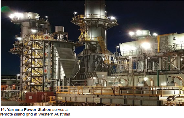

New power in the Pilbara
Yarnima Power Station (Fig 14) operates on an island grid in remote Western Australia. Challenges include frequent load variations (both daily and seasonal) and a requirement to maintain minimum spinning reserve. Also, original duct-burner design allowed firing only when the respective GT was above 90% capacity, and the plant rarely operates at this level. Following OEM reviews, new duct-firing options were tested, then reviewed and approved by regulators.
The 190-MW plant supports BHP Billiton Ltd’s current and planned iron-ore operations.
The Yarnima complex, described by Mark Watkinson, principal chemist, TW Power Services, includes:
- Three SGT-800 industrial gas turbines from Siemens.
- Three HRSGs from RCR Energy.
- Two SST-400 industrial steam turbines from Siemens.
- Three black-start diesel/generators.
