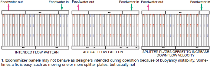

With respect to the first risk, the example Craig cited was compelling: An HRSG unit of a 2 × 1 facility operated 18 years at baseload (down to 60% GT capacity) with no economizer tube leaks, then experienced multiple tube leaks after three years of cyclic operation during which the unit was frequently turned down to 45% of GT capacity.
What happens under these conditions is called buoyancy instability—when the downward velocity (most panel-type economizers have a few tubes with downward flow) is too low, and buoyancy of warm water causes flow instability, reducing heat transfer.
Stagnant and reverse-flow tubes become hotter than neighboring tubes, leading to tube thermal stress. Perhaps the greatest consequence is that leaks can occur at tube-to-header welds which are difficult to access for field repair.
Possible solutions include eliminating the down-flow tubes, increasing flow velocities, or reducing stress at weak areas. To increase velocities, the economizer splitter plates can be repositioned to achieve more down flow than up flow, but this also increases risk of flow accelerated corrosion (FAC) unless done properly (Fig 1).
